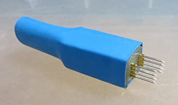

Dear HDDGuru Community,
I have some newer WD USB/SATA HDD to recovery and I intend to use the new SED unlocking feature in PC3k. I wanted to use the programmer with a clip (CH341A). The only problem is that the clip is working only with thicker ROM chips (from older WD drives), the new chips from Charger/Palmer/etc. are too slim to read. How do you guys read the ROM chips without unsoldering?
Thank you very much for any help!
Oliver
MACROFER - data recovery
 Post subject: Re: Reading ROM from newer WD drives
PostPosted: October 27th, 2022, 13:09
Posts: 3598
Location: Chicago
With this

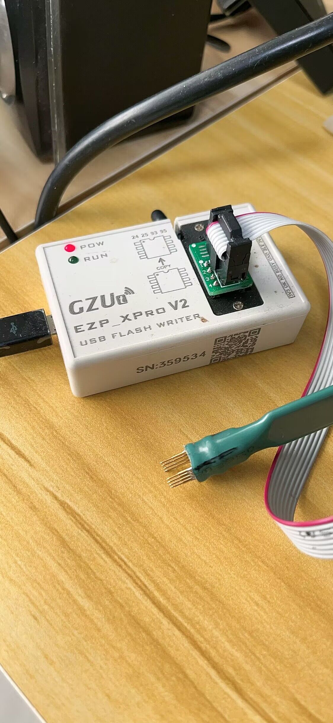

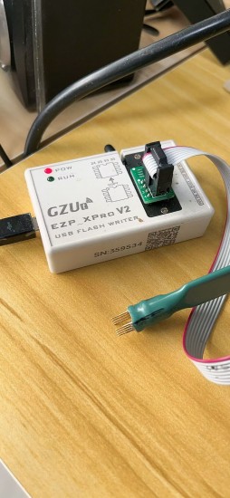

Hi Oliver,
I have Programer and Adapter Clip Pin Flash on-Chip Read and Write Probe.
Please contact me,Jieshan Weng
Skype:jieshan.weng
Ph(whatsapp):+8613764461998
https://www.facebook.com/datarecoveryChina
http://www.datarecovery-china.com
