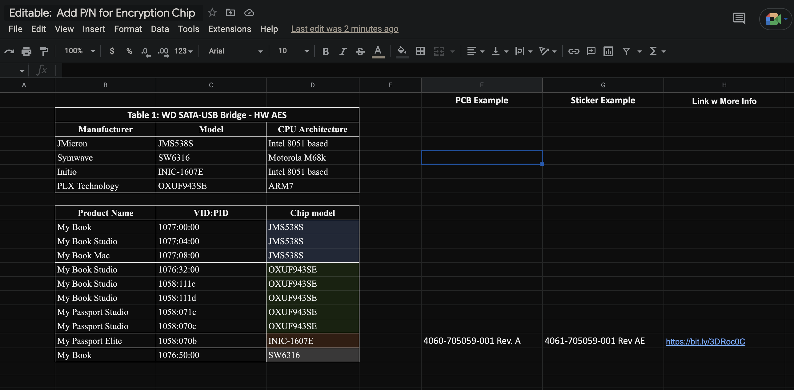

I had hoped to find a list of Bridge-P/N for Encrypted WD My Books ...
Having not found one, perhaps I'll post this in the few places I know...
Hopefully, this will make it easier to cheaply get all of them on hand.
I need at least the following I believe ...
JMS538S by JMicron
SW6316 by Symwave
INIC-1607E by Initio
OXUF943SE by PLX Tech

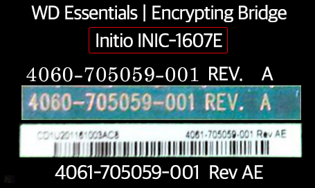

But a list in which you can provide a list of PCB part numbers etc for each type of encryption; ie:
Initio - INIC-1607E
- 4060-705059-001 Rev A
- 4061-705059-001 Rev AE
(it's from an ifixit picture, so it's not 100%)
https://bit.ly/3DRoc0C
UN-editable Google Sheet: https://bit.ly/3DVIIgF
EDITABLE - Google Sheet: https://bit.ly/3DPlfxv
I'll transcribe any accurate updates into the uneditable version.
File comment: Google Sheet with list of PNs

File comment: Bridge PCB and Sticker P/Ns
 Post subject: Re: Creating a WD Encryption SATA-to-USB Bridge P/N List
PostPosted: November 9th, 2022, 0:49
Posts: 17225
See pages 3 and 4 of this document:
http://www.hddoracle.com/download/file.php?id=2298
PostPosted: November 9th, 2022, 14:06
Posts: 1091
Location: Angel Data Recovery
A bit old. More chips already on market and different vendors.
For WD, not listed JMS561/562, WD DUO devices.
Angel Data Recovery
