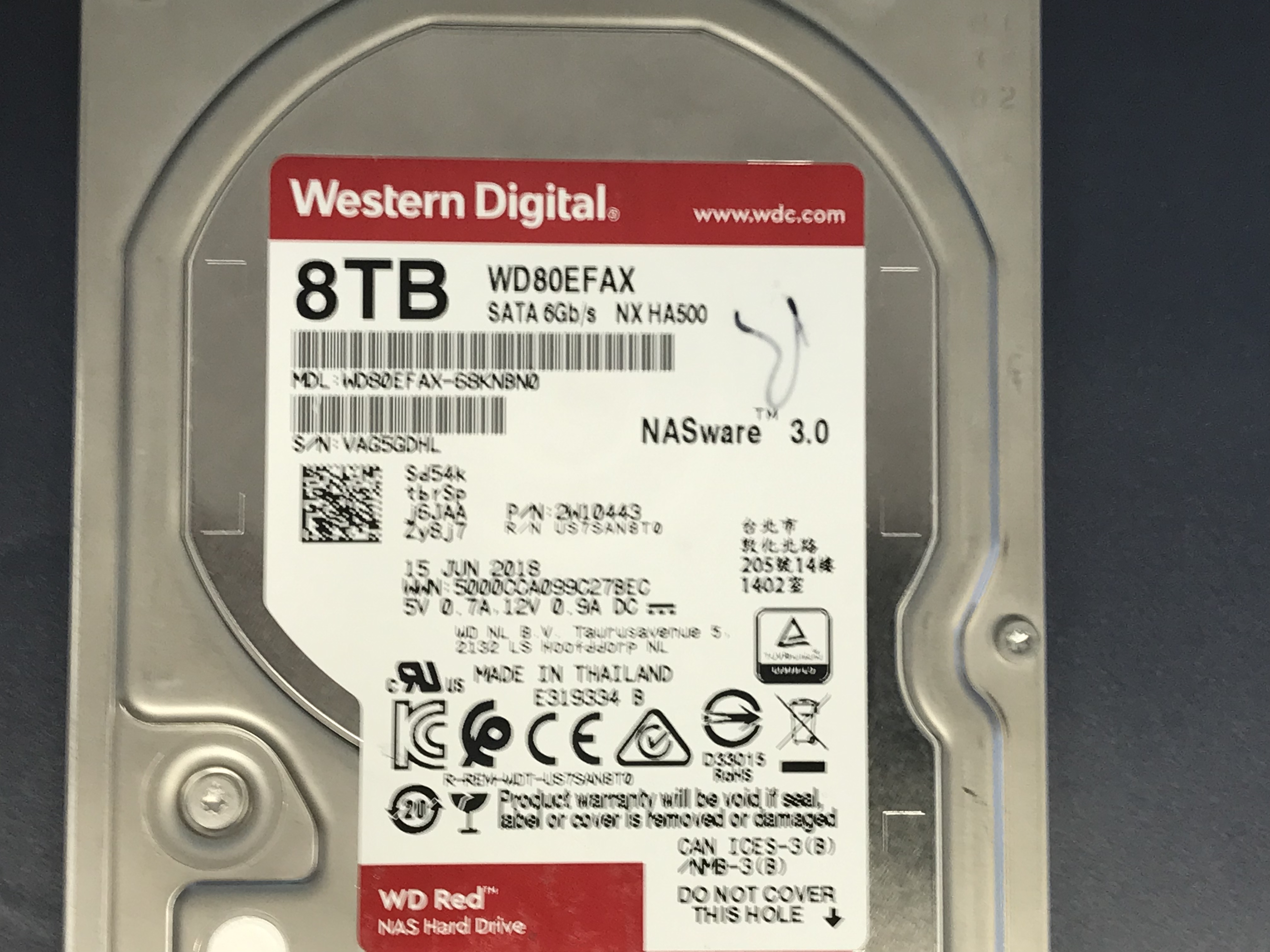

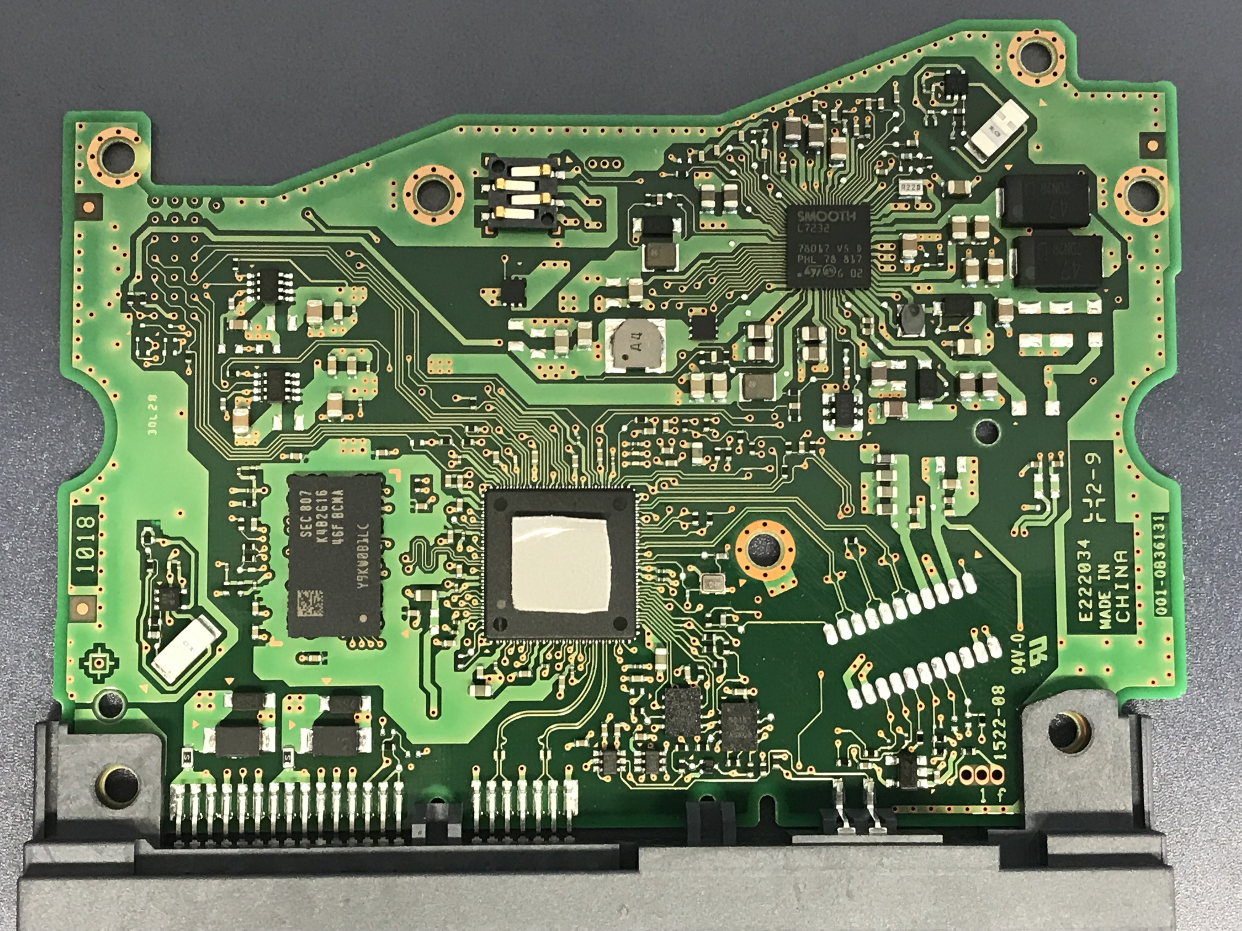

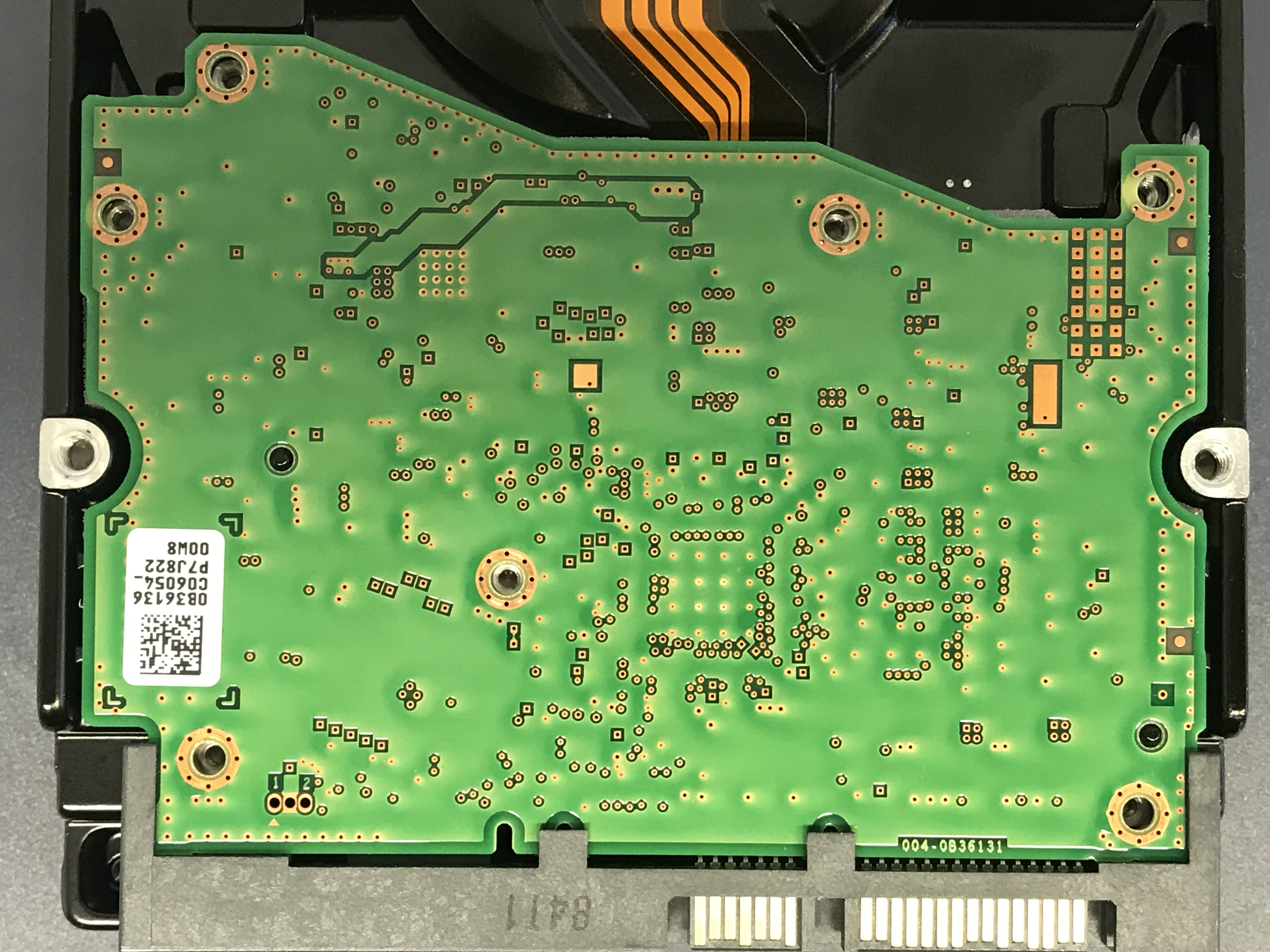

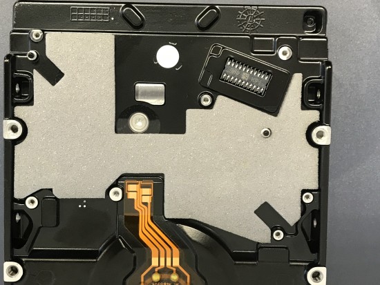

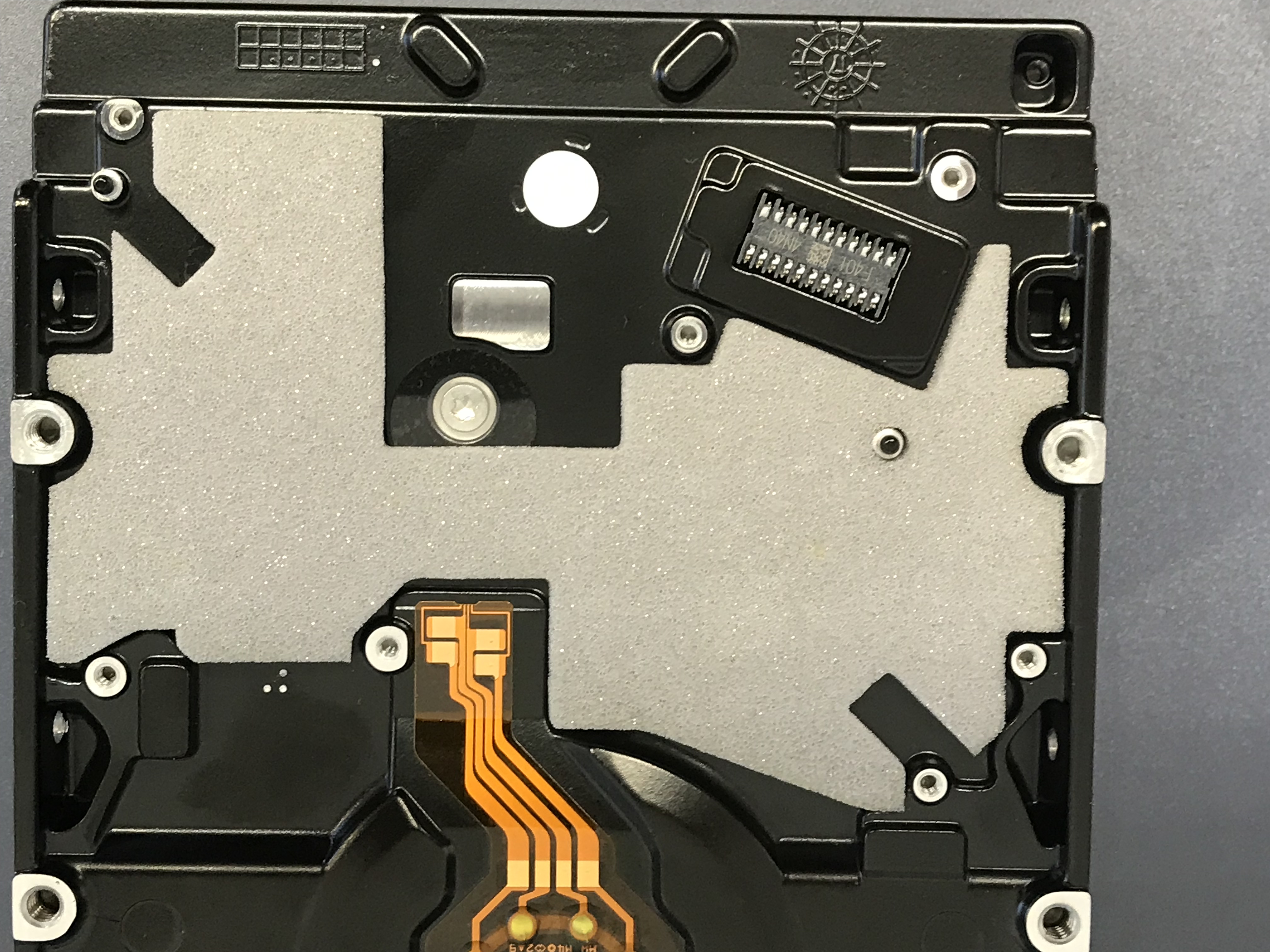

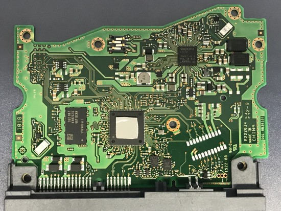

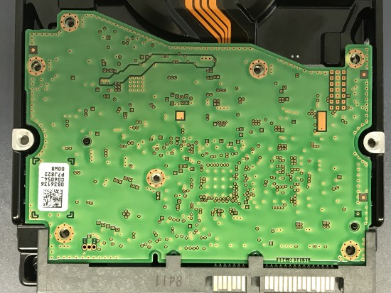

Hi there,
my trainee made a big misstake. He connected a 19V powersupply to a NAS with 12V input. The result of it was, that the NAS wont turn on and both of the HDDs wont spin up.
If I connect now the HDD with a S-ATA powerconnector in the PC it also wont spinup. Also I cant see the disk in the BIOS. If i connect a external S-ATA powersupply to the disk the LED on the powersupply wont go off and no spin of the disk-> so I think the both diodes behind the connector are OK.
Cant see burned parts on the PCB or the disk.
Anyone an idea how to meassure the PCB?
best regards
Fabian

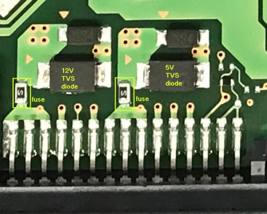

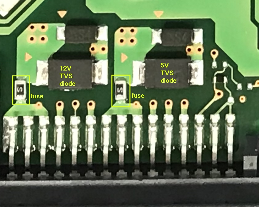

Measure the 12V TVS diode and its associated fuse.

Thank u fzabkar,
left fuse and 12V TVS Diode was burned.

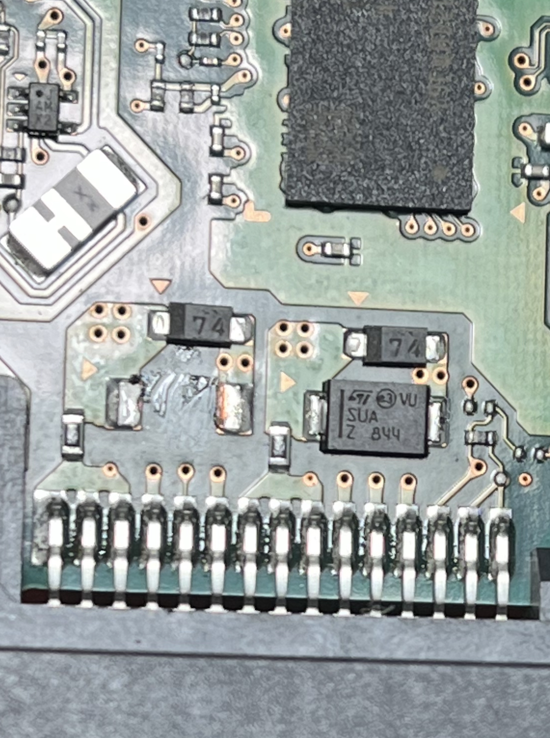

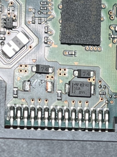

I've removed the 12v TVS diode, as it says in "9/ How do I repair my hard drive?" in provided link.
Result in the image.
Did not make it work.
Should I try shorting the fuse?
 Post subject: Re: WD80EFAX wont spin up
PostPosted: November 2nd, 2022, 16:33
Posts: 17332
You can try shorting the fuse, or replacing it. There are two e-fuses elsewhere on the PCB. These would be the second level of protection.
Did you actually measure anything, or did you just snip the diode on a whim?

I measured the resistance. It was 1 in one direction and 125 in the other.
What should I do now?
PostPosted: November 2nd, 2022, 19:02
Joined: October 29th, 2022, 16:46
Posts: 6
Location: Netherlands
Should I replace those diodes with new ones?
PostPosted: November 2nd, 2022, 19:50
Posts: 17332
It depends on your point of view. If you just want your data, then flowing a blob of solder over the open fuse will probably be OK. Otherwise, if you want to restore the drive's full protection, then replace the damaged diodes and fuses. It all depends on your soldering skill.

Yes, it works after putting a blob of solder on the fuse. Thank you.
It it fine to have the drive working like this?
I assume the risk is only losing the drive if I make the same mistake again(?)
PostPosted: November 3rd, 2022, 14:36
Posts: 17332
If you make the same mistake again, the e-fuse will most likely contain the damage ... I think.
