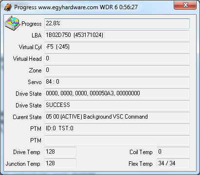

Hello everyone.
WDC WD10EZRZ-00HTKB0, LBA 1953525168, 1000Gb
HDD worked fine, but there were several slow-read sectors I wanted to move to the P-list. I use WDR 6.0 (it was the first my experiment with the program).
Logical Scan ends fine, but next step (format) I accidentally interrupted. Now it is impossible to write to the hdd. Disk stucks in a very strange state.
Format with P-list stucks at 22.8%. I tried it twice.
I tried to erase p-list, g-list, t-list, clean the translator, but I can't format the hdd.
I undestand that my experiments clearly did not bring any positive results but could anyone please suggest direction or some steps in WDR how to revive the hdd, if it's possible at all or at least just understand the current state of the hdd. Thanks.
The data on the disk is not needed.

* Info -> DIR Rev.
ROM Rev: 01.86R
Mod 0D : 00010000 (01.00)
Mod 4F : 00010086 (01.86)
DIR Rev: 00020000 (02.00)
OVL Rev: 00010087 (01.87)

* Test -> Heads write tests
Write Test on Track -4, Num Heads :2
Head 0 - GOOD
Head 1 - GOOD
