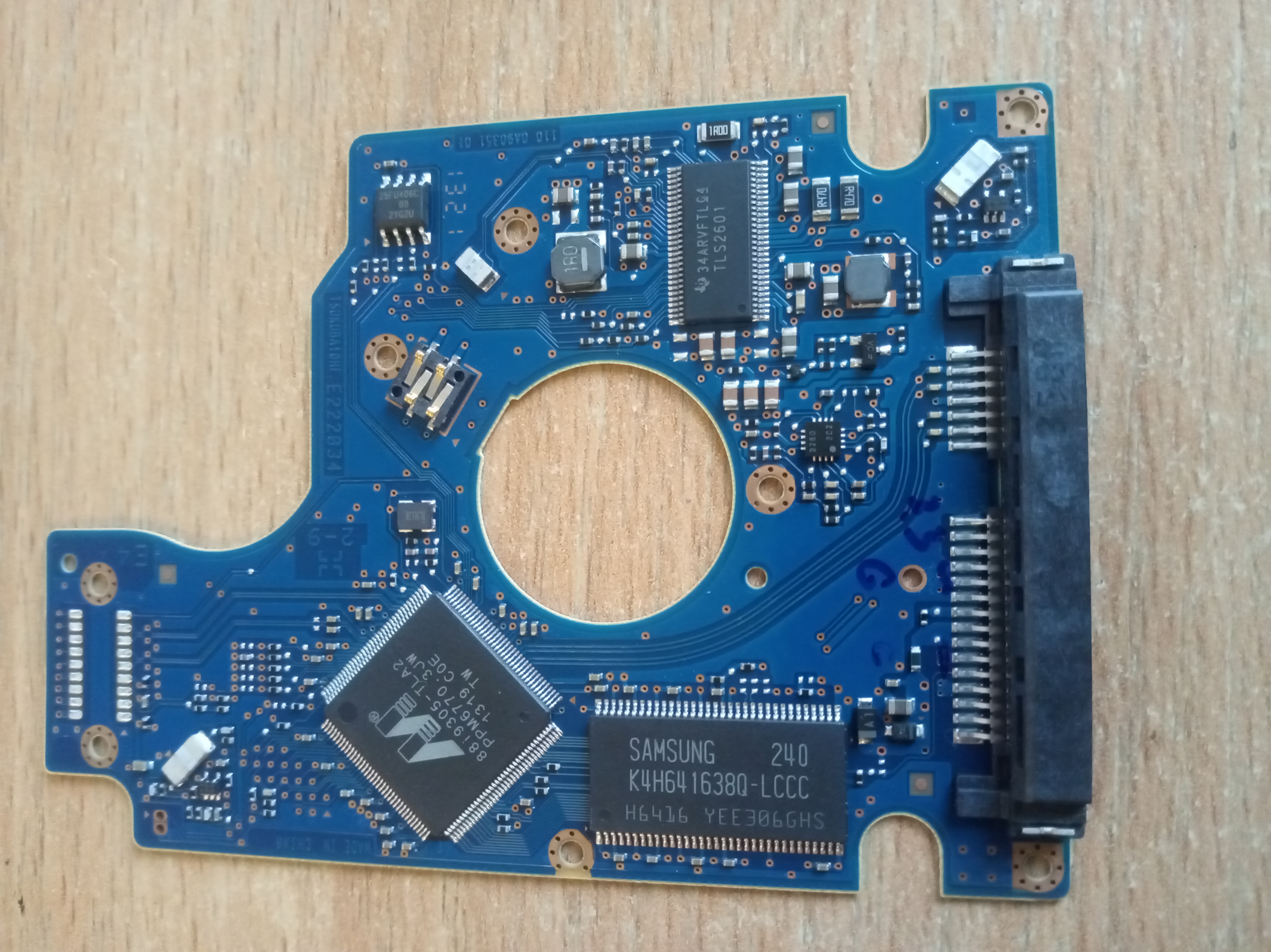

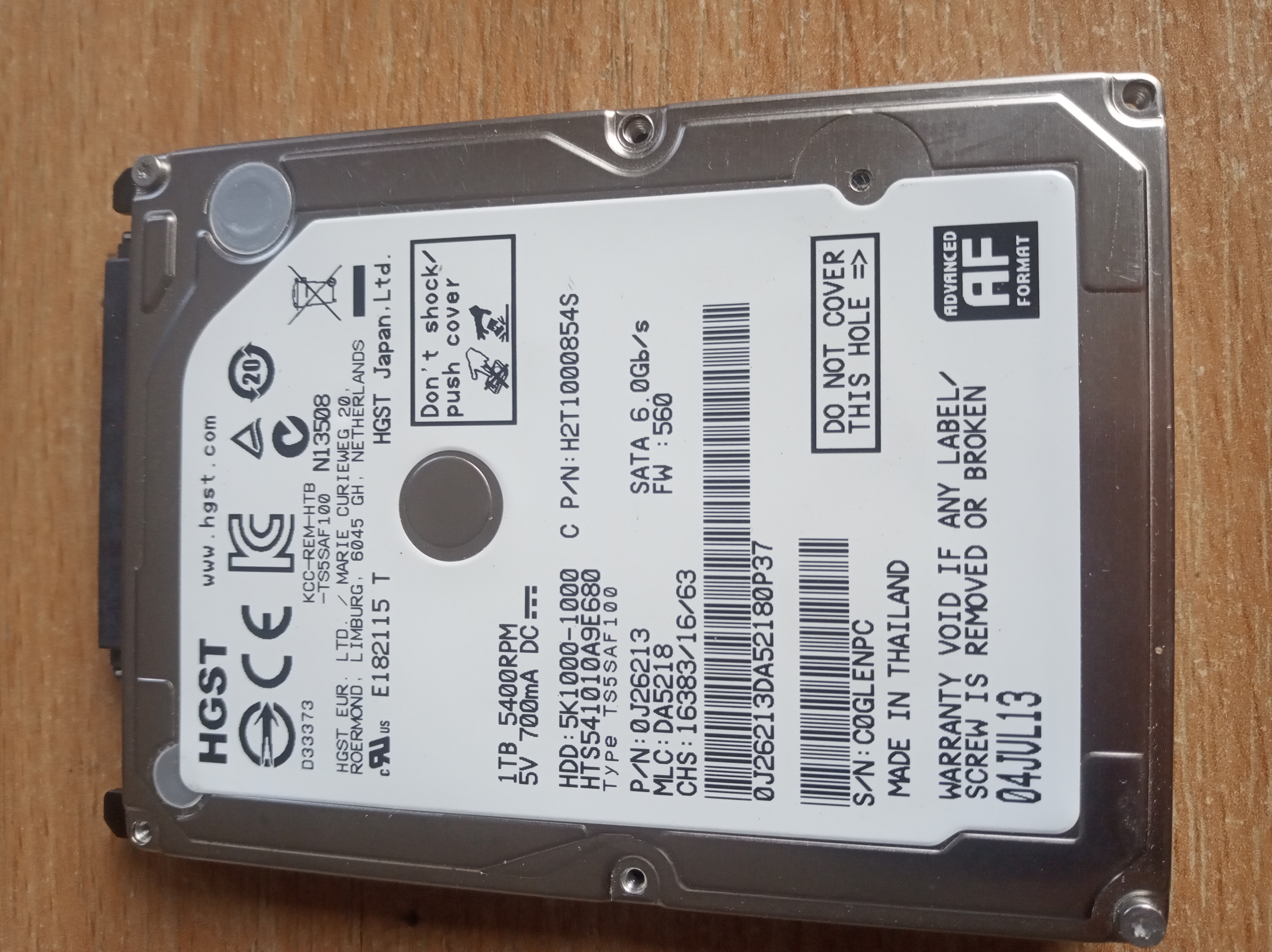

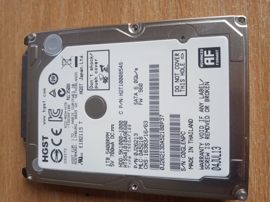

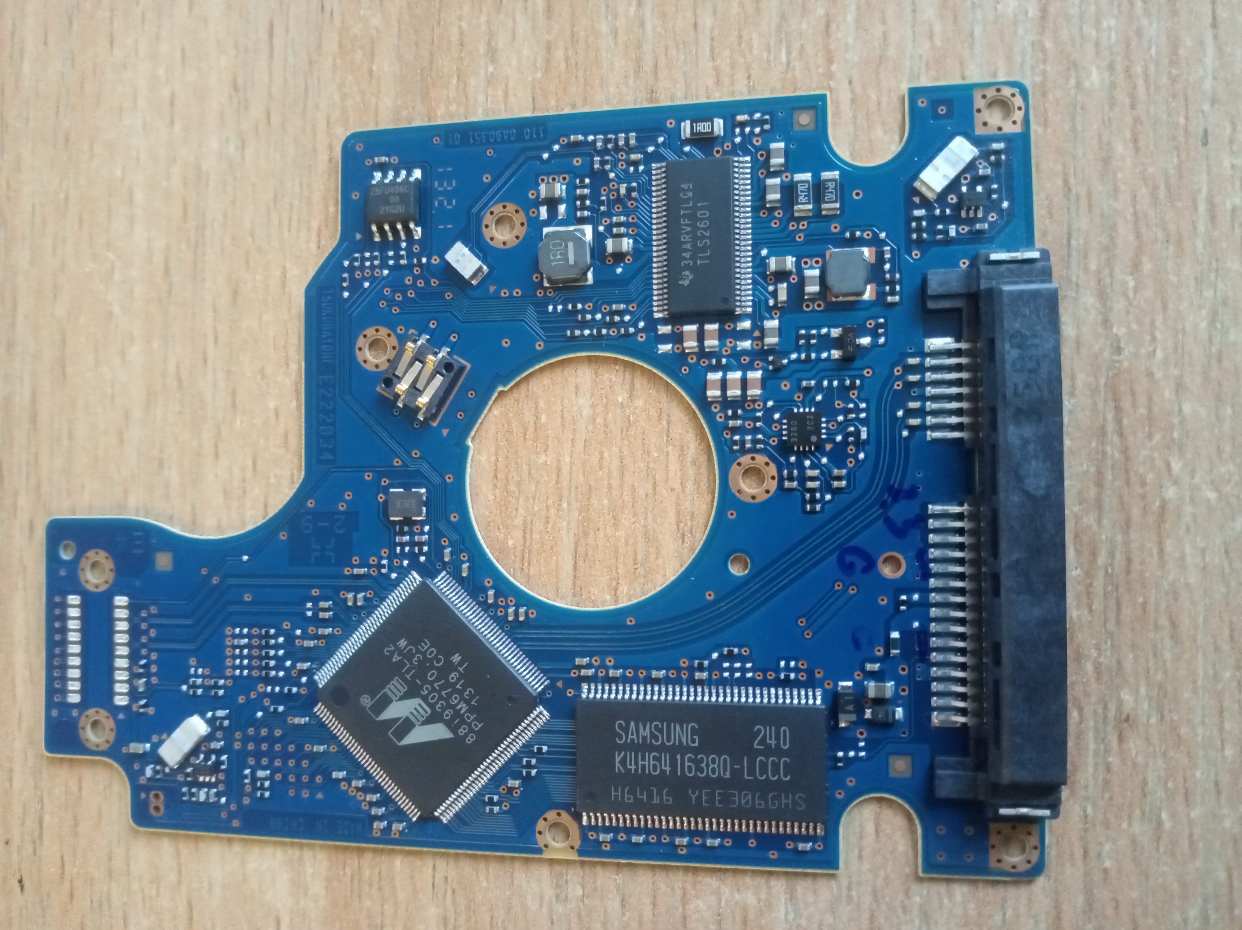

I have HGST drive, model HTS541010A9E680 which does not have any reaction - when connected to computer.
Pictures are included.
Can you please advise troubleshooting process?
I have practice in logic boards of cell phones and tablets reparing but not in hard drive reparing.
Thank help

Measure the voltage across the "A1" TVS diode near the SATA power connector. If +5V is missing, then test for shorts to ground at this point. Also test the tiny smt fuse (or inductor?) at the SATA 5V pins.

I have 5V on the diode and also on SATA.
I also measured some other voltages on the logic board , but it is not easy to find a problem without a schematic.
Are there datasheets for that TLS2601HDCARG4 and 88i9305-TLA2 available?

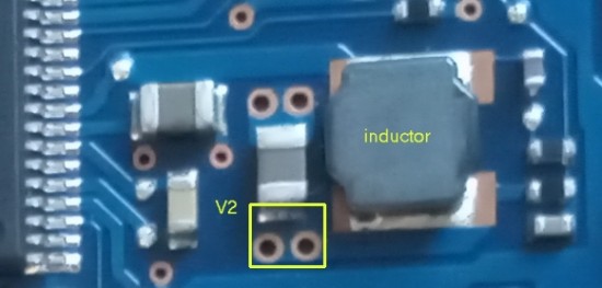

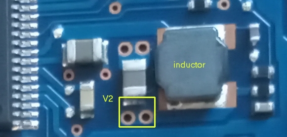

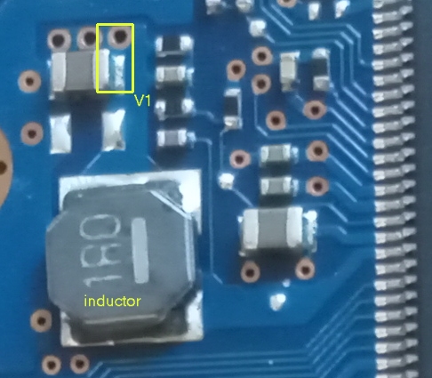

What are the voltages at V1 and V2?

The date code on the PCB is 1321, ie week 21 of 2013.
The manufacture date on the label is 4 July, 2013.
Therefore the PCB is probably native (or a very close match).
BTW, I expect that V1 and V2 are +1.2V (Vcore) and +2.5V (Vio). Both the ROM and SDRAM require a 2.5V supply.

I have these voltages:
V1 is 0.87V
V2 is 2.53V

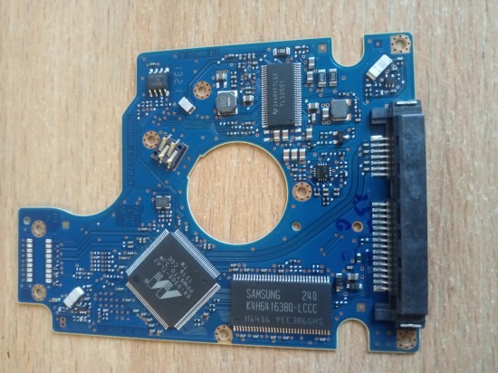

Picture you posted,
https://sep.yimg.com/ay/yhst-1443758497 ... 1083-6.gif
saying
The RV sensor in the top left corner has fallen off
is not of my logic board.
I am enclosing the correct picture again
V1 seems rather low, what do you think?

The Vcore voltage for older ARM cores was 1.2V. Later cores operated at 0.9V. I can't recall when the change happened.
The most expedient approach would be to purchase a donor PCB and transfer the "ROM" (LE25FU406C).
The only other possibility I can think of is that the drive may be configured to Power Up In Standby (PUIS). A tool such as HDAT2 can disable PUIS.
