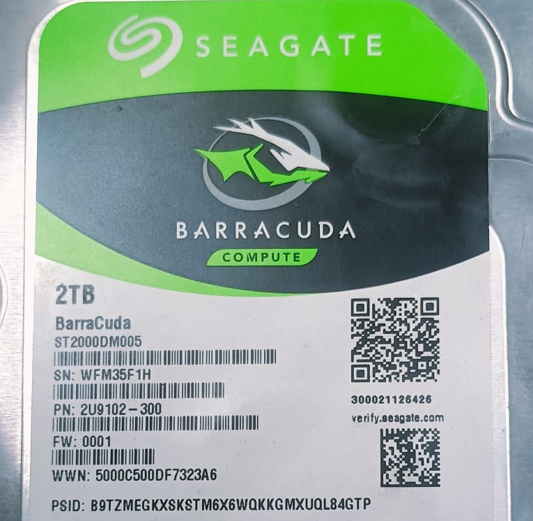

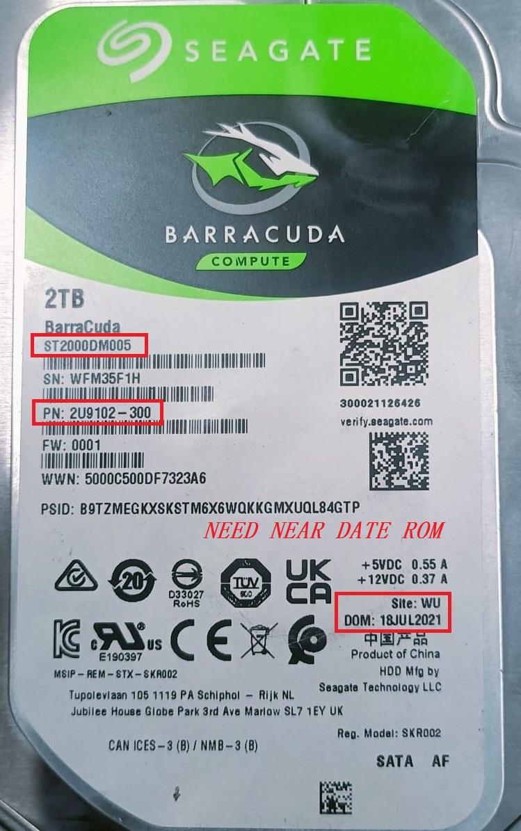

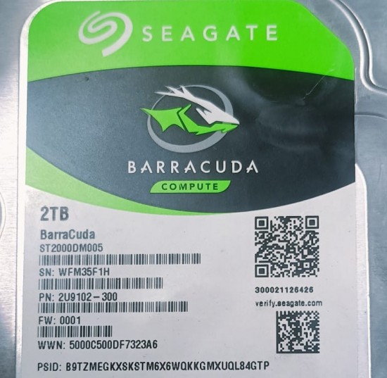

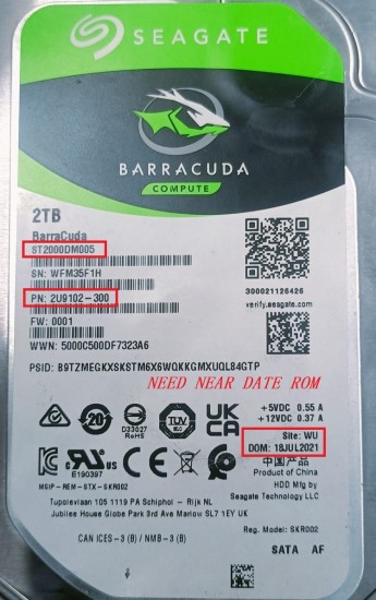

Can someone Provide Donor ROM for this hdd ST2000DM005-2U9102
Close to
HDD comes with Motor IC burned. PCB number is 100870255
Donor PCB with Original ROM Shows like this
Flash boot code Digital Signature Verification failure!
0x00000040
0x00001200
0x00000001
0x00000001
0x00000001
ST2000DM005-2U9102-001-Patient.rar [251.57 KiB]
Downloaded 563 times

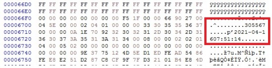

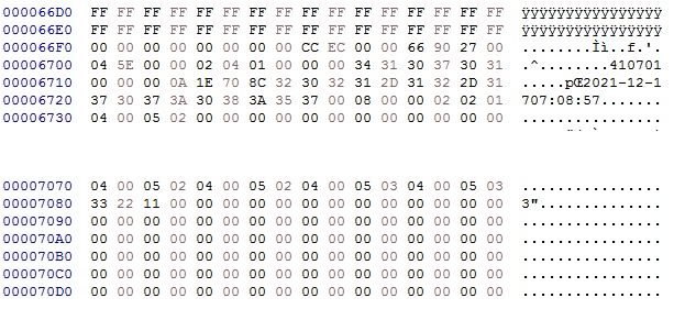

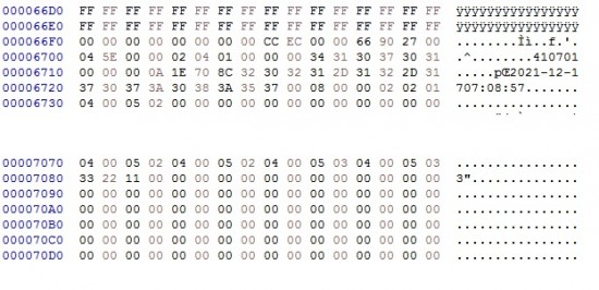

When I compare 0x0 - 0x3FFFF with 0x40000 - 0x7FFFF, the only differences are in the headers, CRCs and signatures. Therefore ISTM that the ROM code is OK. If there is a bit error, then it must be in the signature itself, or in the CRCs??? In fact F3RomExplorer is reporting CRC errors, but I don't know if they are real.
 Post subject: Re: Req: ST2000DM005-2U9102 Donor ROM
PostPosted: November 30th, 2022, 18:11
Posts: 17323

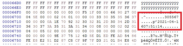

There is a segment at 0x66F0 - 0x70E3 and a copy at 0x466F0 - 0x470E3. It appears to contain several signatures, some 0x100 bytes long and others 0x20 bytes. These appear to be digital signatures for several firmware components.
Here are the signatures (see attached file):
00000000  A0 00 00 00 00 00 00 00 F5 1F 00 00 66 90 27 00   .......õ...f.'.
00000010  04 5E 00 00 02 04 01 00 00 00 33 30 35 35 36 37  .^........305567
00000020  00 00 00 0A 1E 70 92 32 30 32 31 2D 30 34 2D 31  .....p’2021-04-1
00000030  36 30 37 3A 35 31 3A 31 34 00 08 00 00 02 02 01  607:51:14.......
00000040  04 00 05 02 00 00 00 00 00 00 00 00 00 00 00 00  ................
00000050  00 00 00 00 9E 37 75 12 4D 5E D1 ED FE AD 54 86  ....ž7u.M^Ñíþ.T†
PostPosted: November 30th, 2022, 18:38
Posts: 4847
Another way to check would be to download an official firmware update and see if it includes a signature at the same location.
this struck me with an idea: If something in the MCU was used to generate ROM code signature, it would imply to recalculate the sig on a fw update. This would release the private key for generating the sig, and would be a stupid thing to do.
The only way this could be done reasonably is to hash an orig signature with the MCU id, so this is still plausible.
it would be nice to see 2 drives with identical fw version...
PostPosted: December 2nd, 2022, 11:23
Posts: 347
Location: india
I got one 2TB ROM but Date is different
This Family can't be unlocked, So i can't use ldr.
So waiting for ROM with close date to my ROM
Note: I also have one 4TB ROM of this family with same codes as in above picture
PostPosted: December 3rd, 2022, 19:10
Posts: 17323
Could you upload your 4TB ROM?
Can PC3K unlock this ROM? If so, then how does Ace circumvent (?) the signature after injecting its code?

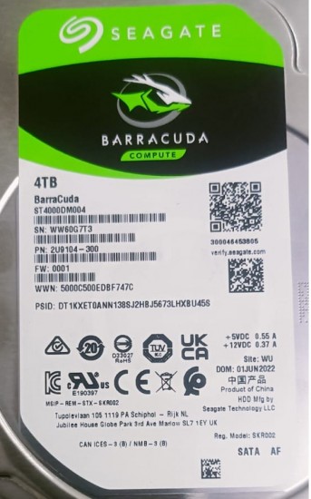

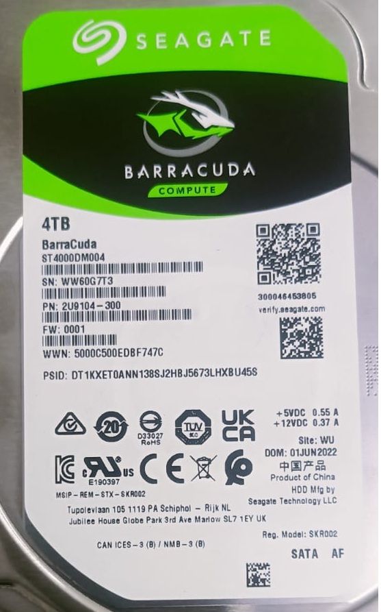

PostPosted: December 4th, 2022, 0:38
Posts: 347
Location: india
PCB: 100870255 Rev. A and QR in PCB: 100870642 E E241624F
ROM 4TB
ST4000DM004-2U9104-001.rar [276.79 KiB]
Downloaded 576 times
Patient 2TB PCB: 100870255 Rev. A and QR in PCB: 100870642 D E1527AVU
ROM is in First Post
