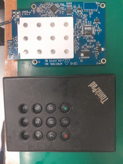

I have a password for Fujistu but I cannot unlock it
File comment: Fujistu password casing ... I am using MRT

I believe this is encrypted not a regular ATA password
i got few of those long time back
if the drive has bad sectors then this is another issue
Seek pro. help better
good luck

Are you sure the PCB is working? I can help with some basic testing if need be.
Just FYI. These drives erase encryption keys after 10 unsuccessful password tries.

AFAICT, the eNova chip is responsible for full disc encryption. I'm guessing that U4 is a Microchip PIC controller, and that it is preprogrammed as a keypad decoder and authentication device.
The USB-SATA bridge IC (JMicron?) appears to be just a dumb bridge. If it is faulty, you should be able to bypass it by hooking up to its SATA pins.
X-Wall MX-128, eNova, real-time FDE, AES ECB 128-bit encryption, 3.3V & 1.8V, QFP-80:
http://www.enovatech.net/support/download/X-Wall%20MX%20Specification%20Rev%202.2_Redacted_05042015.pdf
