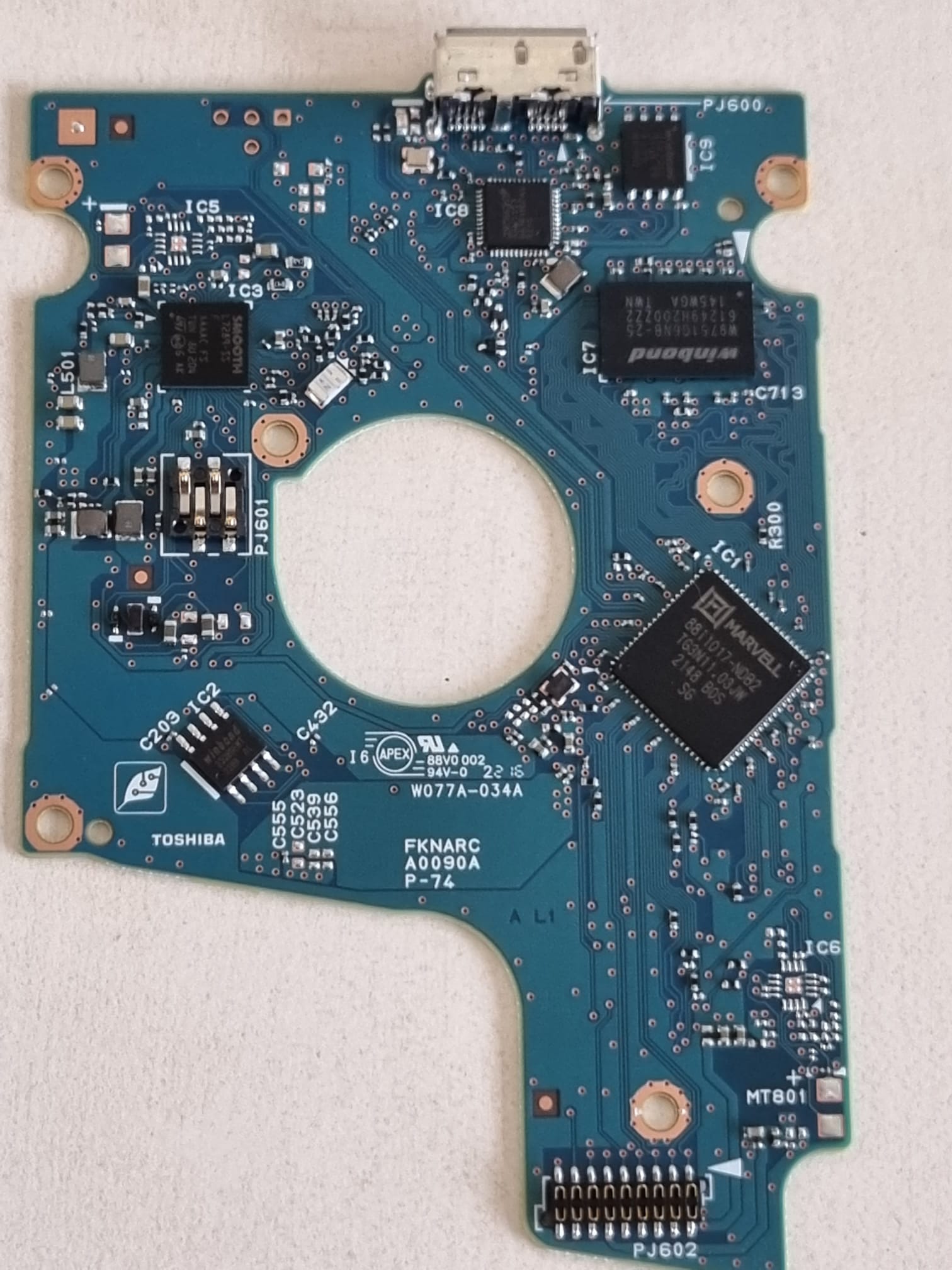

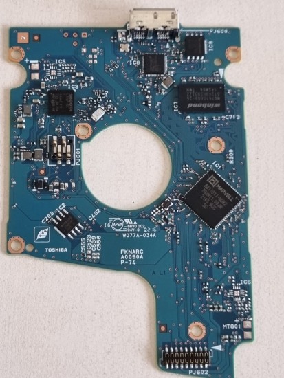

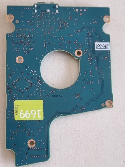

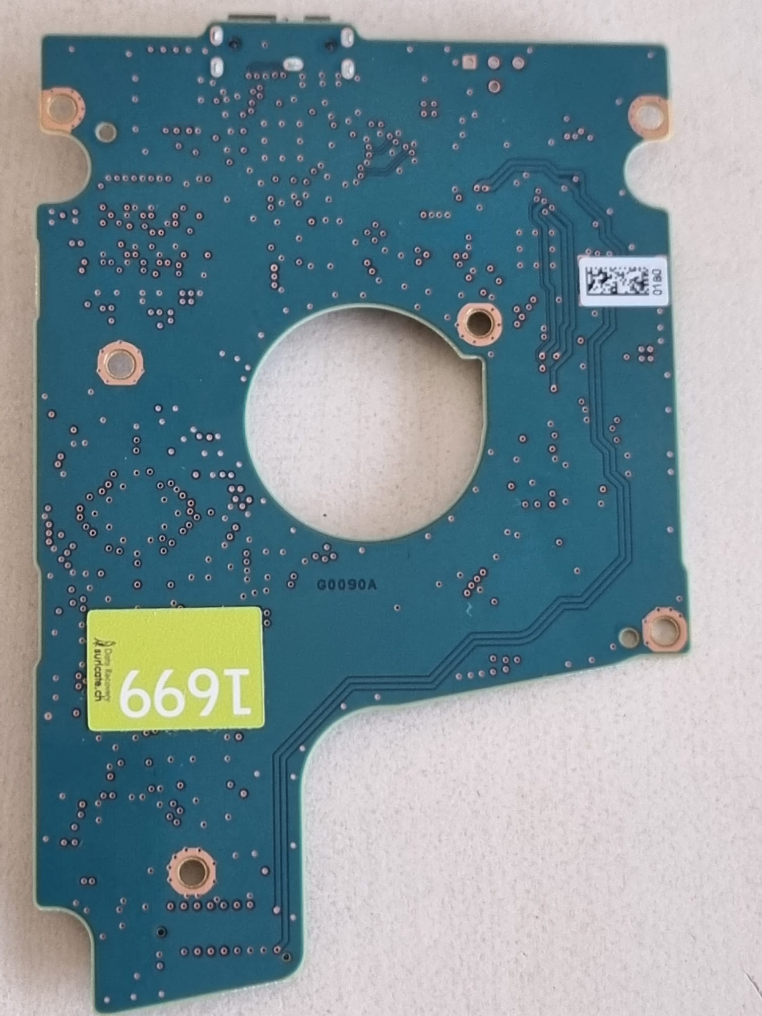

 Post subject: USB Toshiba MQ04UBB400 - PCB G0090A -> which SATA PCB
PostPosted: December 28th, 2022, 7:56
Posts: 191
Location: Switzerland
Anyone knows which SATA PCB is compatible with this USB PCB G0090A from TOSHIBA ?
Nothing on this forum for this PCB reference G0090A and nothing

 Post subject: Re: USB Toshiba MQ04UBB400 - PCB G0090A -> which SATA PCB
PostPosted: December 28th, 2022, 8:09
Posts: 357
I think G4311A
PostPosted: December 28th, 2022, 18:43
Posts: 17335
G0064A is used in the SATA version (MQ04ABB400). G4311A and G0064A are claimed to be compatible at Data-Medics.

I used G4311A, that works. Thank you !
