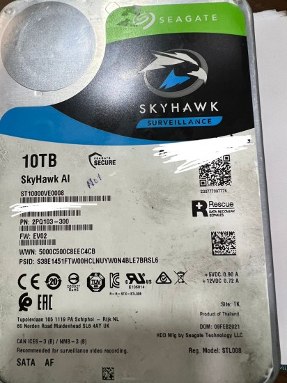

I have received Seagate Skyhawk Surveillance 10TB for recovery ( Heads Knockings )
These drives are built in such a manner that, they don't have screws for Top Cover.(Welded Top Cover )
Has anybody experimented / opened these drives or done head replacement ?

It's welded because it's a helium drive.
https://www.seagate.com/files/www-content/datasheets/pdfs/skyhawk-ai-DS1960-12C-2103GB-en_AU.pdf

I am clueless here
Shall Head replacement be attempted? in any ways
What is the expert's opinion?
 Post subject: Re: Seagate Skyhawk Surveillance 10TB Head Replacement
PostPosted: November 30th, 2022, 6:27
Posts: 4854
not if you can't deal with firmware, etc...

Send it for "Free recovery", you can see label. Drive insured, and data recovery free of charge on them. :roll:

Question ,
Are they able to work and recover data on these sir ,who can verify this
PostPosted: December 21st, 2022, 15:23
Posts: 4854
suricate.ch sent them one and got it recovered as far as i know...
PostPosted: January 5th, 2023, 9:26
Posts: 191
Location: Switzerland
Yes, if it's still under warranty. I had to argue a little bit with support but at the end they recovery data, drive was clicking.
