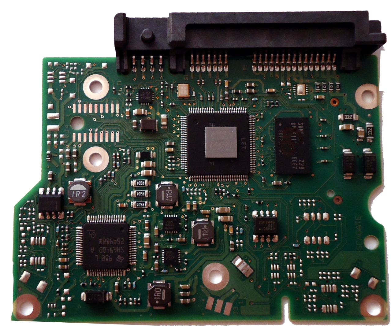

Hello fzabkar
Let u guide me "Which component i have to check and leave reference value"
File comment: Which component i have to check and leave reference value
 Post subject: Re: Seagate Error "SMI init (or) Training Failes"
PostPosted: November 11th, 2016, 3:59
Posts: 4848
u can check supply voltages but most probably the controller has internal damage.
Why do u want to repair this board? Get a new one and forget about the bad one.

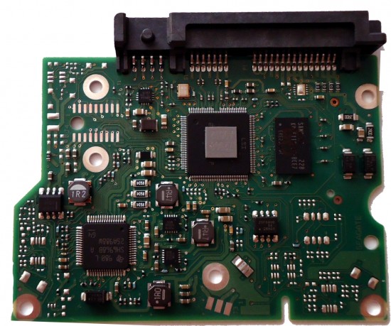

I cut the following data out of an ST1000DM003 ROM:
00003990  01 01 FE FE 00 00 FD FD 0D 0A 53 4D 49 20 49 6E  ..þþ..ýý..SMI In
000039A0  69 74 20 28 6F 72 29 20 54 72 61 69 6E 69 6E 67  it (or) Training
000039B0  20 46 61 69 6C 65 64 0D 0A 00 00 00 04 00 00 00   Failed.........
I don't understand the meaning of "SMI" but "training" often refers to synchronising clocks between two serial devices. This often involves the use of a PLL. Therefore I would compare the MCU's external components between patient and donor. Also compare the voltages across the supply capacitors.
