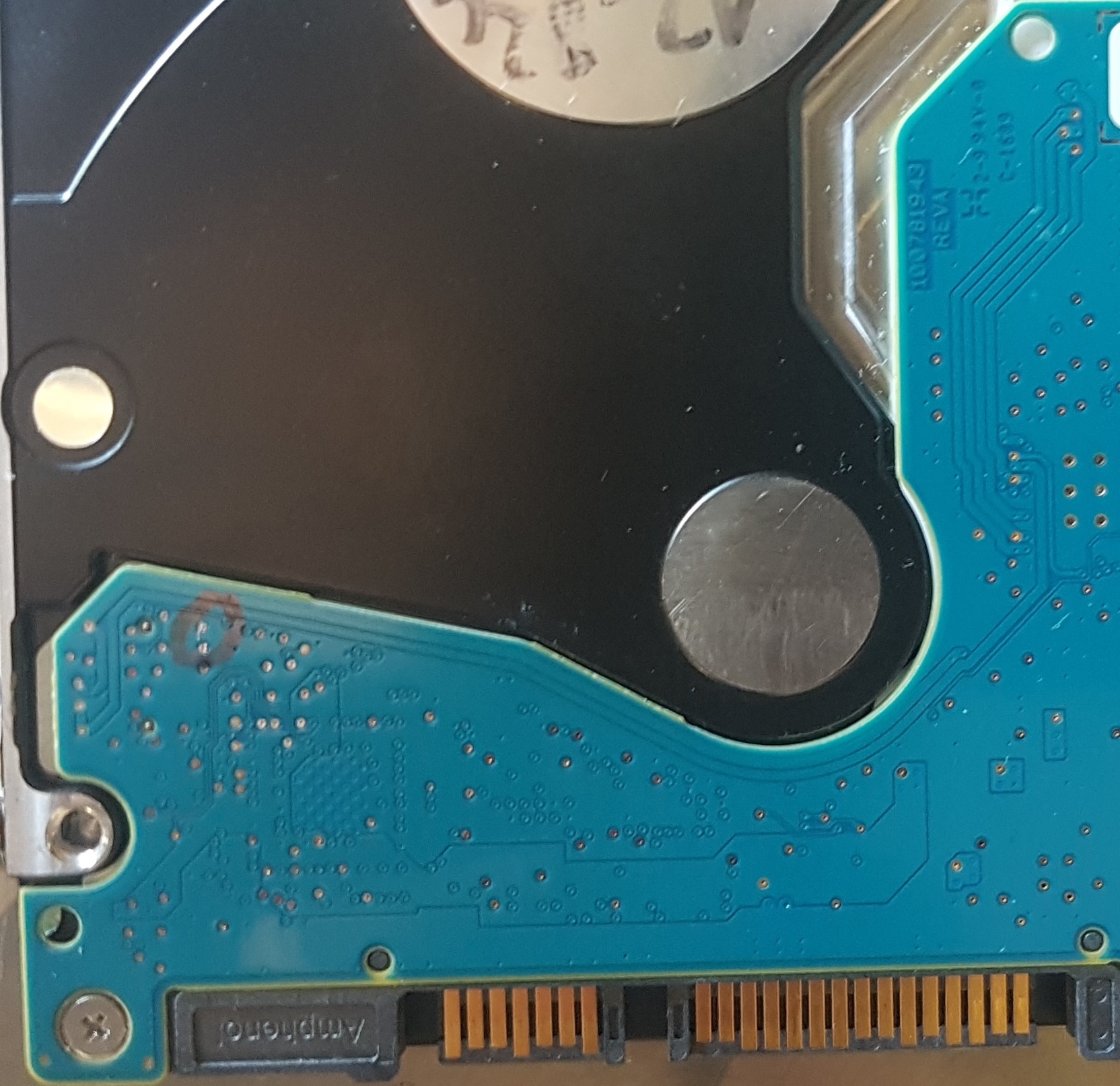

Hello all.
I am asking for help in solving the problem with the hard drive from the worst series in the world.
The patient was with MC damage, I took off the flags in file 93, uploaded it back.
The disk started fully, the second head was in poor condition. She read but very slowly, after a long operation of this head the Disk went into BSY state. I downloaded the data from the other 3 heads. After turning on the 2nd head, the Disk went into BSY state.

The error still points to the MC. The problem is I can't get to the terminal commands. CTR + Z is not working. The disk goes immediately to the BSY state
Without access to a terminal, nothing will be done.

can you reach terminal ? seems problem is with MC

@MindMergepk - As I wrote, I can't connect to the disk via termianl. Previously, I also had an LED: 8D message, but I could interrupt the disk startup by CTRL + Z
@bojack - I also suspect the heads, but the disk starts normally, will not knock. I would replace the heads, unfortunately I don't have a donor and the client leaves after the weekend. I have the same 2TB with damaged heads (normal in this HDD family)

Phew ... I managed to get to the terminal by shorting two pads. 10 minutes to find the right pads and 3 hours to find the right moment. But I didn't kill any test HDD :)
So what are the right pad ?

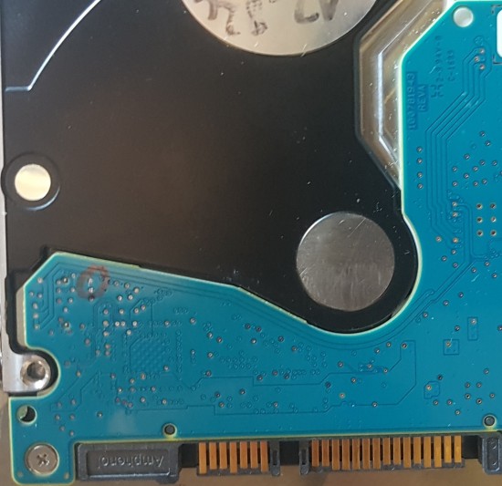

Marked with a black circle. I hope it's clearly visible in the photo. It contains two pads about one second after unlocking by the patch.
Thanks. Helped me with a case today!
