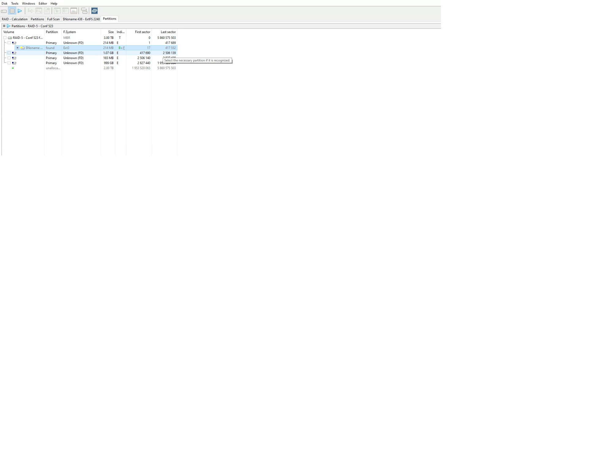

My colleague gave me his WD SHARESPACE 3TB. He told me when he logged into this NAS it wrote that all the disk is broken. I connected it to normal PC and tested with Victoria HDD Tool and everything seems to be fine.
I tried to rebuild RAID 5 with DMDE but it doesn't find any 3TB partition.
Result of the rebuild shown in the photo.
What else can I do?

Try to reconfirm the RAID parameters with ...
http://www.freeraidrecovery.com/
BTW, does your RAID consist of 4 x 1TB HDDs?
Why is there an MBR partition table rather than GPT?

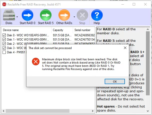

Yes, inside there was 4x1TB WD10EARS
I'm scanning with freeraidrecovery and will post the results

I could be wrong, but I think that some of these boxes have small Linux partitions which are mirrored across all members of the array. The data partition would be striped. You could confirm whether this is the case by examining sector 0 on each drive.

I have scanned 4 HDD with Free RAID Recovery but it gives me this message
