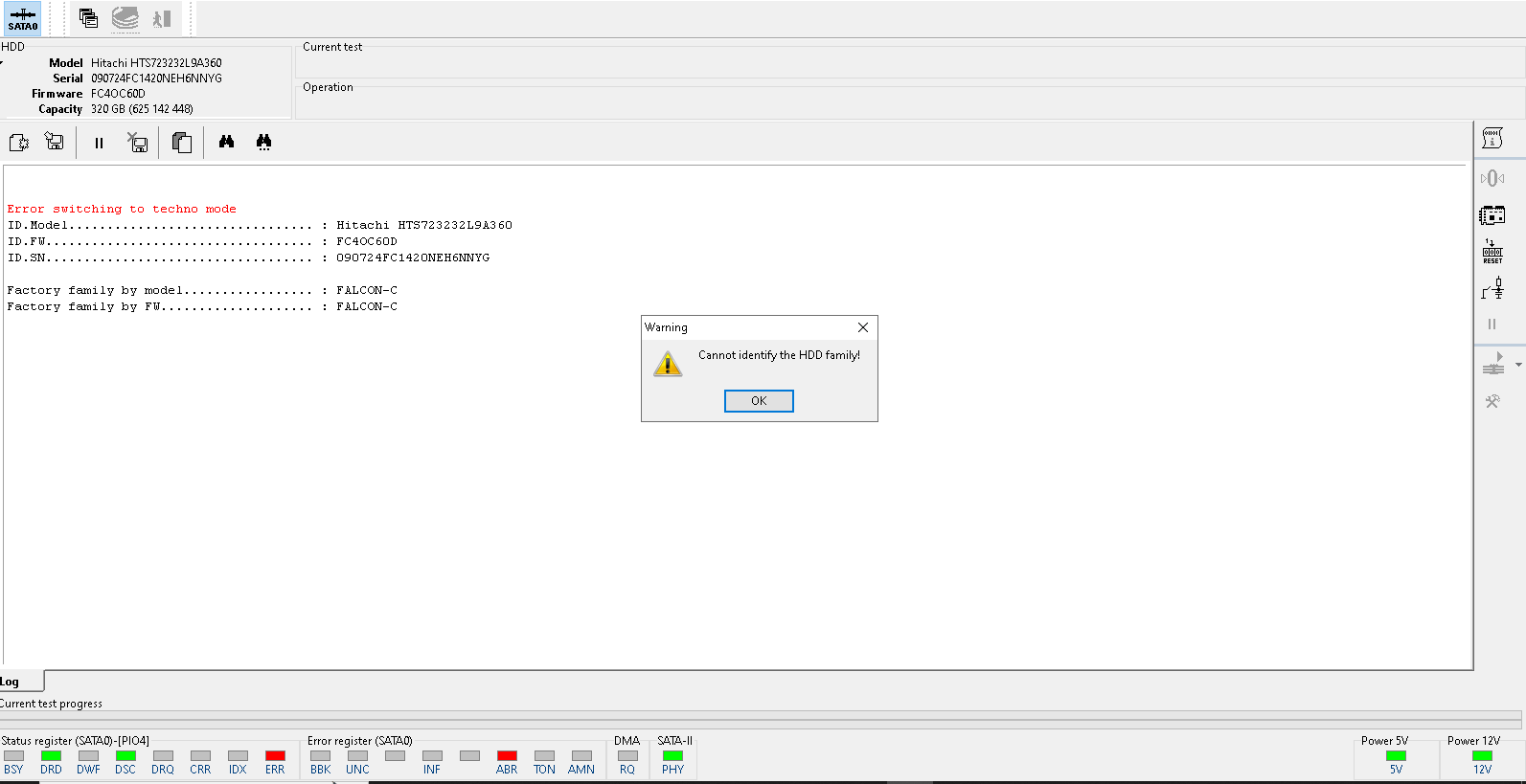

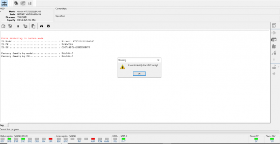

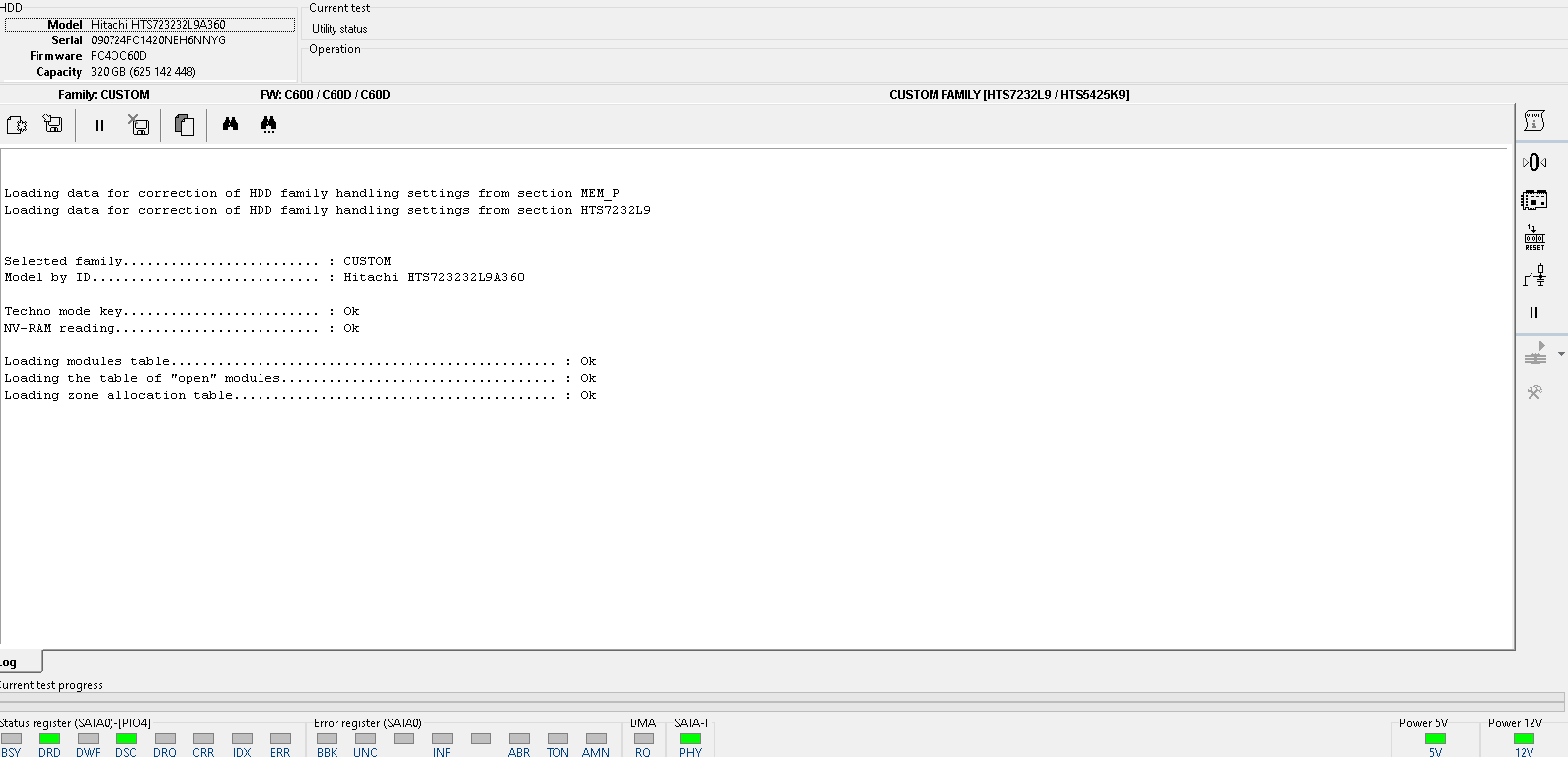

Unfortunately Hitachi HDD 7K320-320 ( HTS723232L9A360) is not getting detected with right family in my pc3000udma.
Which family I should select?

 Post subject: Re: Hitachi 7K320-320 Family
PostPosted: February 1st, 2023, 11:51
Posts: 4779
select from custom families

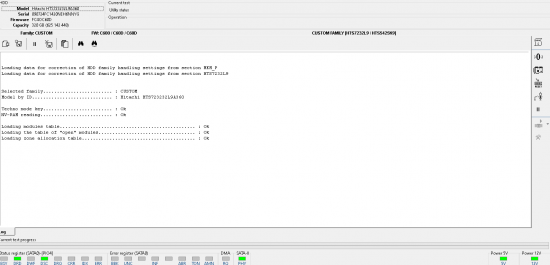

Dear Spildit & pepe Good Morning.
Thank you so much for all the help. :good: :-D

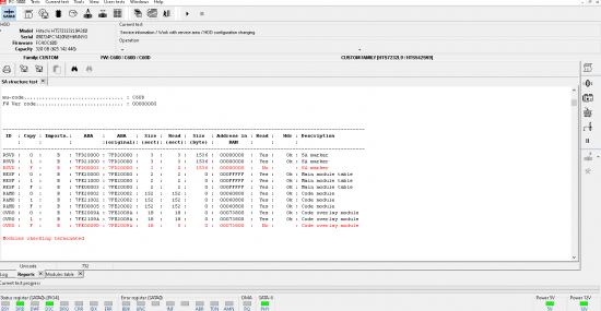

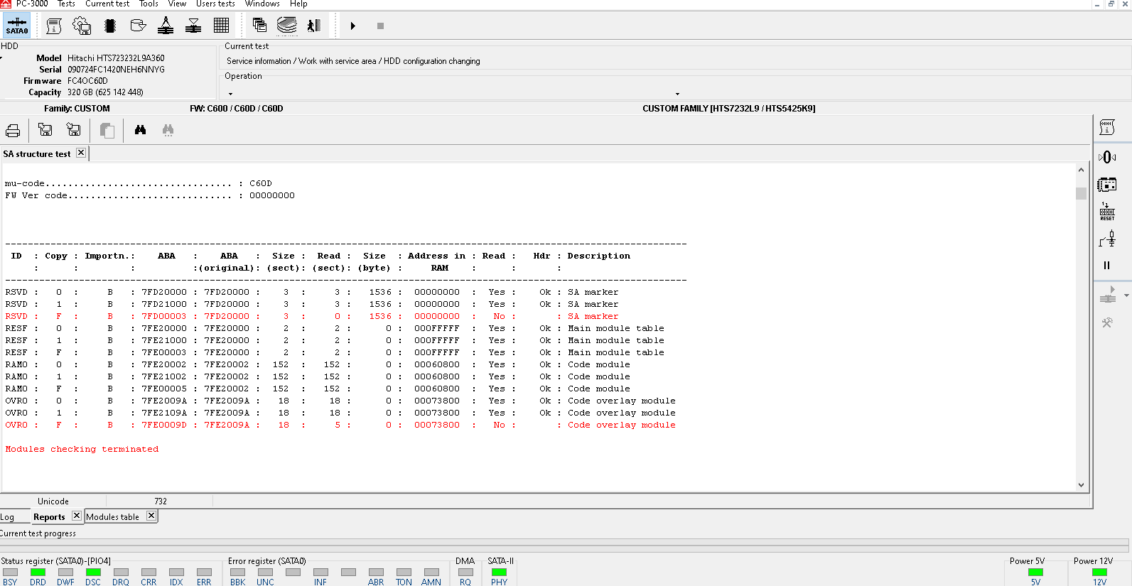

I have been successful to run utility with correct family now and have backed up nvram & other modules as well.
All important modules are healthy.Unfortunately my knowledge is so basic that I will not be able to perform any of the tasks (parse modules etc)

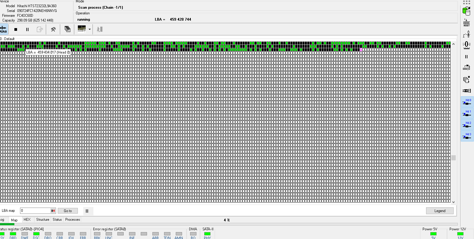

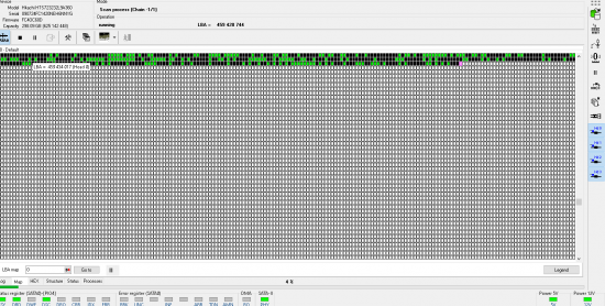

Though 320 GB disk has 4 heads , out of which head 0 is having large bad sectors ( may be it is weak)
I have imaged 70 GB partition using other heads. I will have to skip all data covered Head 0.
PostPosted: February 2nd, 2023, 5:53
Posts: 4779
yes, h0 looks weak, needs swapping...
PostPosted: February 2nd, 2023, 15:57
Certainly looks that way.

Spildit wrote:
pepe wrote:
commands to read/write SA, NVRams, etc are the SAME
yeah, but addresses may be different
That's why you parse USAG like this ?
http://www.hddoracle.com/viewtopic.php? ... =20#p22917
On that CLA3 I got the modules by parsing USAG to get the correct address to use on the VSC directly.
Thanks a lot , I always refer HDDORACLE , in fact I have downloaded it for ready ref. :good: :-D
