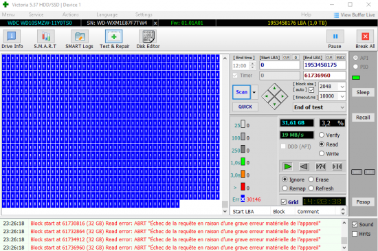

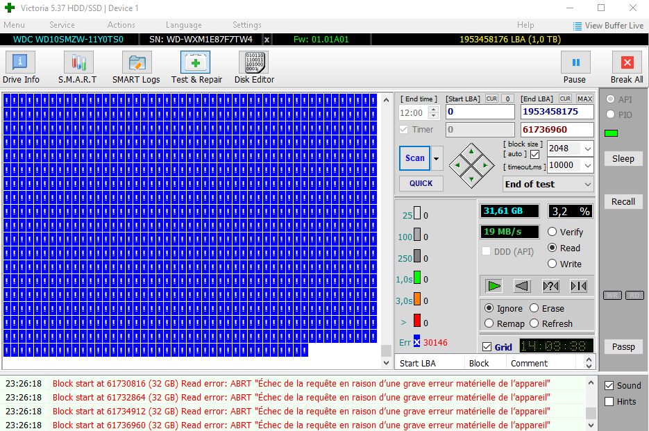

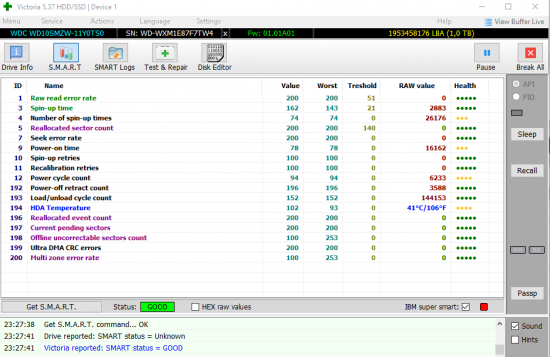

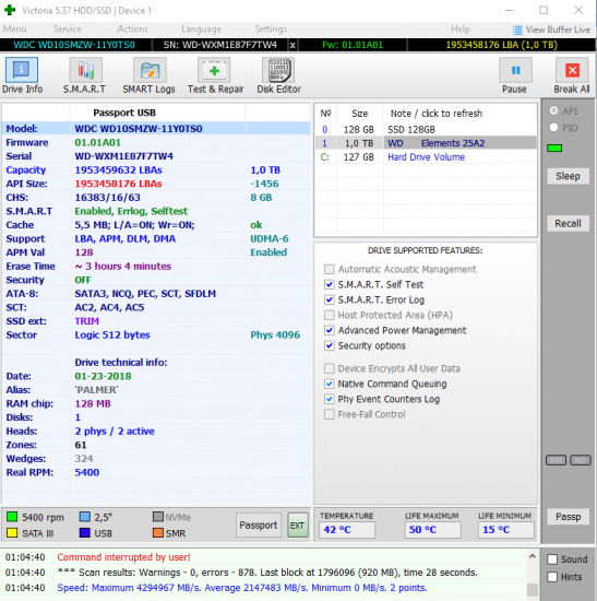

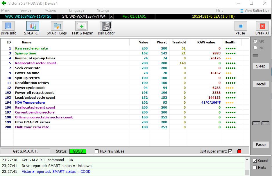

Veird situation with an external HDD, WD Elements 252A 1TB - SMART status is GOOD, but read error.
What physical problem can cause read error on all sectors? Damaged heads?
I tried to scan with different data recovery software, but nothing found, no lost partition, no data.
The drive was never opened, it runs normally without any clicking sounds that could indicate stuck heads. Any idea?

could be pw locked or some HW error. It cannot access user area as long as we can rely on victoria's logs

You will need to convert the PCB to SATA interface for precise diagnosis.

The drive is reporting a capacity of 1953458176 sectors. The IDEMA standard capacity for a 1TB drive is 1953525168 sectors. That's a difference of 66992 sectors. This suggests that there is a reserved area of ~34MB at the end of the user area. I notice that this space exists in all (?) Elements models, so I'm wondering what it is used for if there is no encryption.
Maybe this space is used for reallocated sectors?

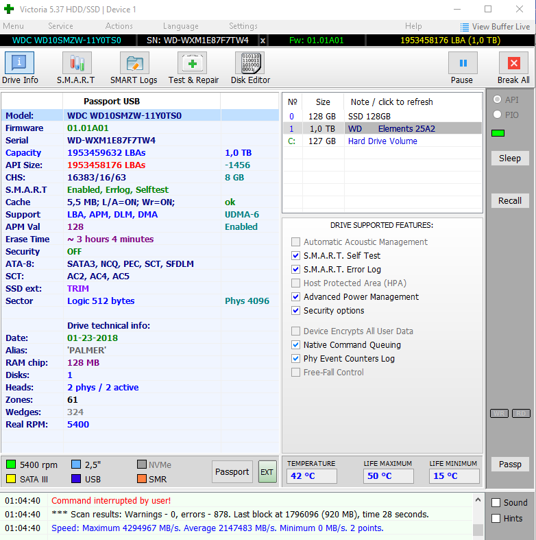

Here is the drive info:

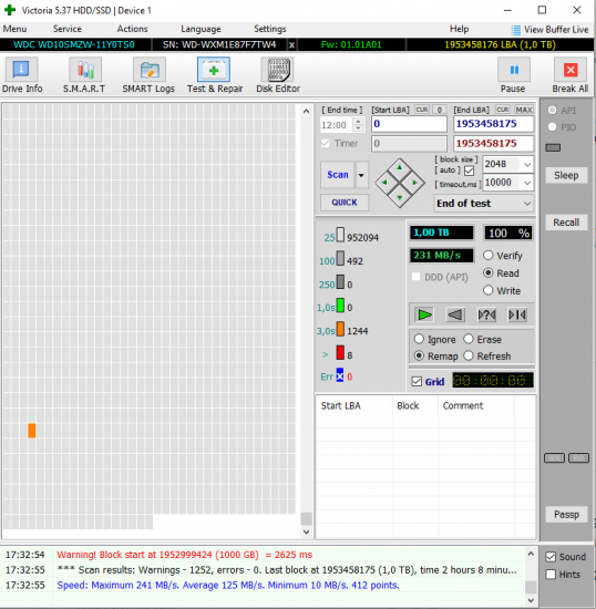

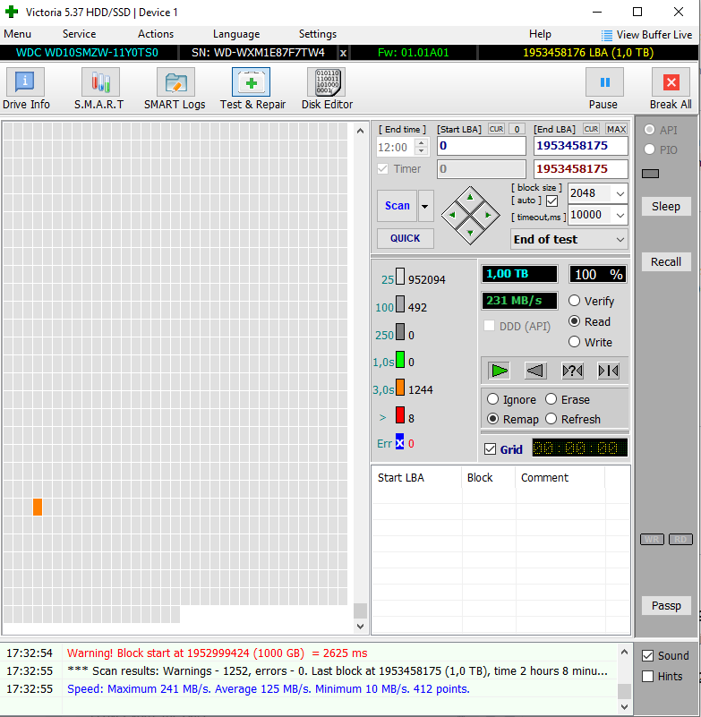

A new scan result today :
If the drive was encrypted, I should see these encrypted bytes in recovered partition, but now all sectors are=0 and it's impossible to recover the last partition.

I noticed that all recovering data software take about 5 hours to scan the disk and fail to recover data. Just after the scan the drive become unreadable, like in the first post. If I disconnect and reconnect the drive, it is back readable. I can't figure out why

This is smr drive... maybe 2nd level translators is corrupted.
As i know, bad T2 nodes can cause symptoms as 0 byte sectors when reading, but data are still there and can be recovered with professional tools.

How can the symptoms change in such a way?
I just noticed that your drive supports TRIM function... if somebody / malware / "repair tool" has deleted the partition, data are lost as happens with ssd.
Did somebody try to "fix" it by initializing the drive?

Thanks for the suggestion. Victoria scanned only tice in read mode ignore bad sectors and try to remap bad sectors, but no sector was remapped, nothing changed on the surface after the read.
