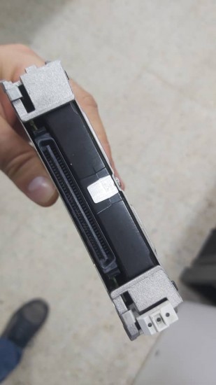

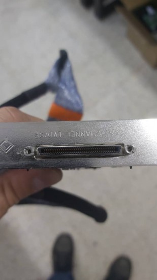

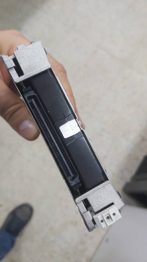

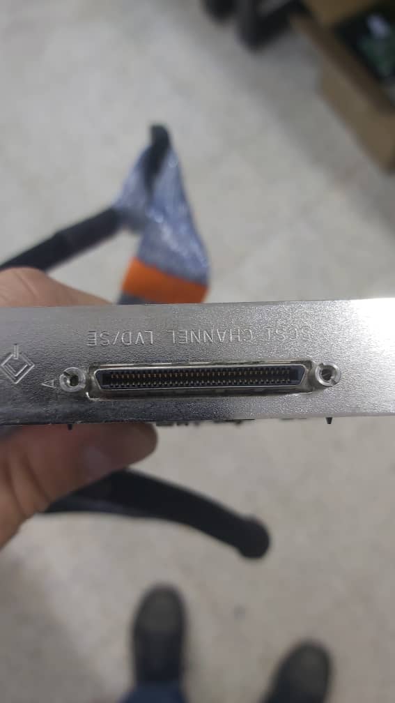

How to connect SCSI Ultra320 drives to a recent workstation?
I have an LSI Logic Ultra320 SCSI Storage Controller Card LSI20320IE PCI-Express x4
What cable should be used to connect this drive to the LSI20320IE controller?
Does the controller power the drive? or do I need to use another way to do it?
Thank you in advance for your help
Lamine

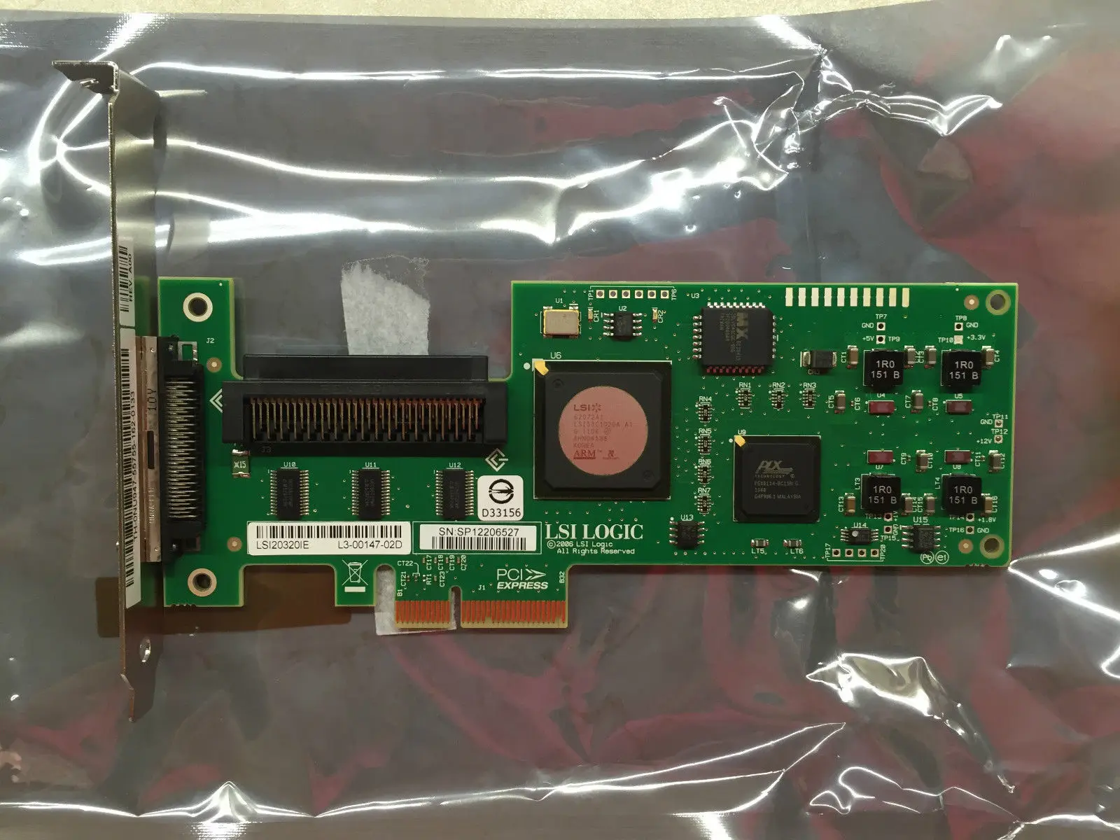

The LSI20320IE card draws only 0.6A @ 12V from the PCIe slot (page 45). It doesn't seem to be enough to power a HDD.
https://docs.broadcom.com/doc/12353413
That said, there is a 1.5A polyswitch (MINISMDC150F-2) near the SCSI connector.
https://ae01.alicdn.com/kf/S97dfb5f57a994d5fa7b4f89724f0d092Z/LSI-Logic-SCSI-LVD-SE-Controller-PCI-Express-x4-LSI20320IE-439946-001-Tested.jpg

Hi @fzabkar
Thank you for your help.
To be honest, I didn't understand what do you mean by "there is a 1.5A polyswitch (MINISMDC150F-2) near the SCSI connector"
What cable needs to be used to connect the drive to this card? its not clean, most of the cables I found on eBay are Male-Male

here https://docs.broadcom.com/doc/12352276 we can read:
PCI Express Power 10W (without providing termination power)
and
Termination Power Self-resetting 1.5A fuse per channel

The manual says "ULTRA320 SCSI LVD/SE", 68-pin. Page 21 shows the cables. I guess the choice of cable depends on the type of drive your have, either single-ended or differential.
The presence of the polyswitch suggests that power is being drawn in that area.

sosrecup, You need a cabel from internal SCSI LVD 68 pin connector of your controller to 68 pin SCSI LVD connector. And you need an adapter for your hard drive SCA80 to 68 pin LVD connectror or SCSI backplane from some server

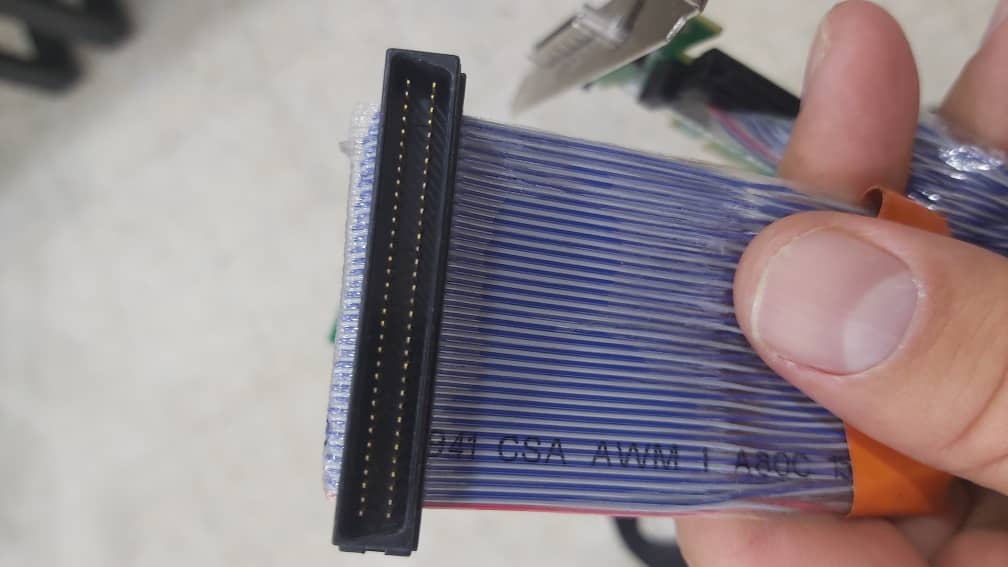

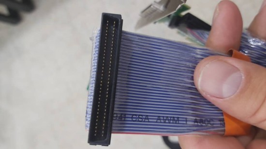

napalm_atx, is this sufficient https://www.alibaba.com/product-detail/HPDB-68-Pin-Female-Connector-to_1600139664043.html?spm=a2700.details.0.0.3aaa766771n0mg ?
fzabkar these cables are used to connect to external SCSI devices or hard drives that have an IDE connexion
I have this cable below, but I need an adapter to connect to the drive. Can these cables help:
https://www.cablesdirect.com/store/p/2940.aspx
https://www.alibaba.com/product-detail/ ... 18311.html
https://www.alibaba.com/product-detail/ ... 766771n0mg

sosrecup, You have right cable, you just need this adapter https://www.alibaba.com/product-detail/ ... 5497f4I2v9
