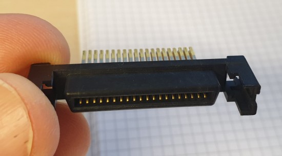

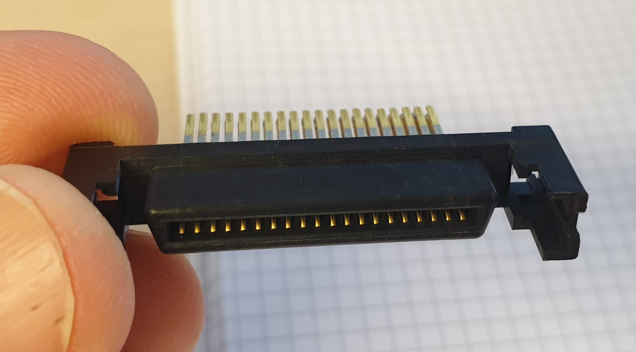

Hello, some of you know where to find the pinout for this SCA-2 40 PIN Female connector?
I need to know where is PIN 1 and pin 40 only, since full list of pins is available here:
https://en.wikipedia.org/wiki/Fibre_Cha ... _connector

I think I can see a "V" at the left side.
Here is an image where the notch is more visible:
https://media.digikey.com/Photos/Molex/0717431040.jpg
