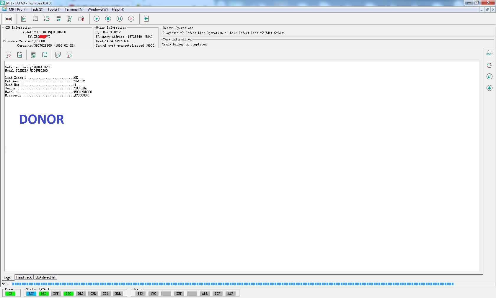

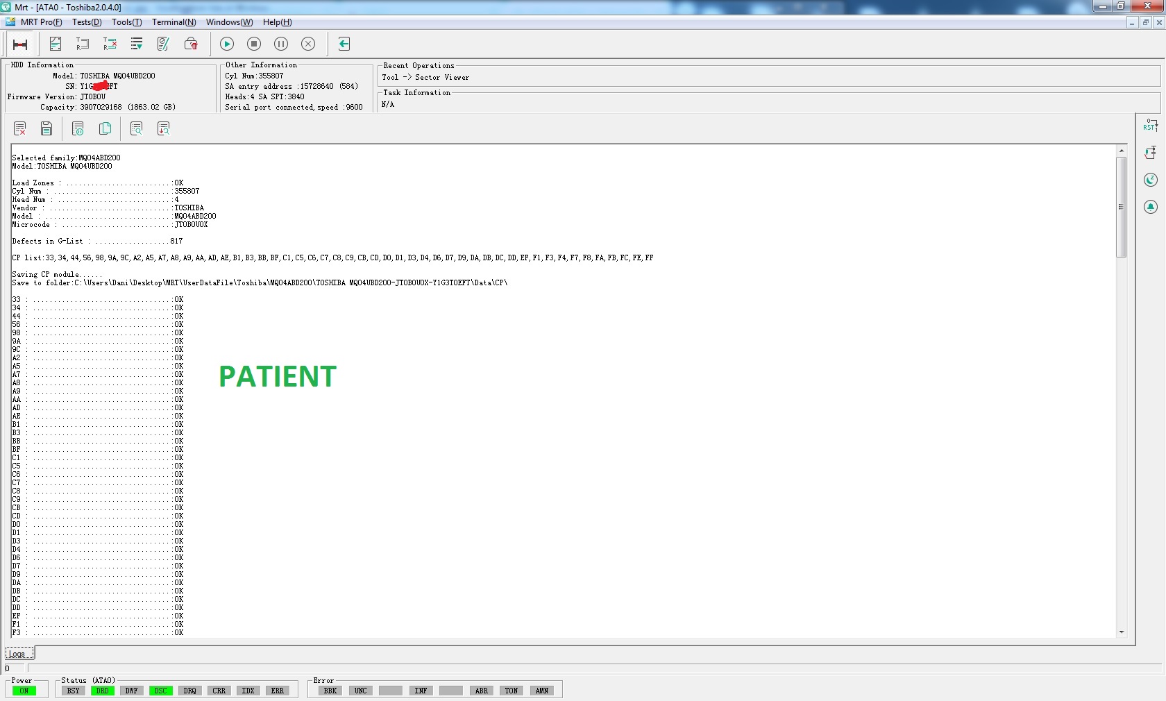

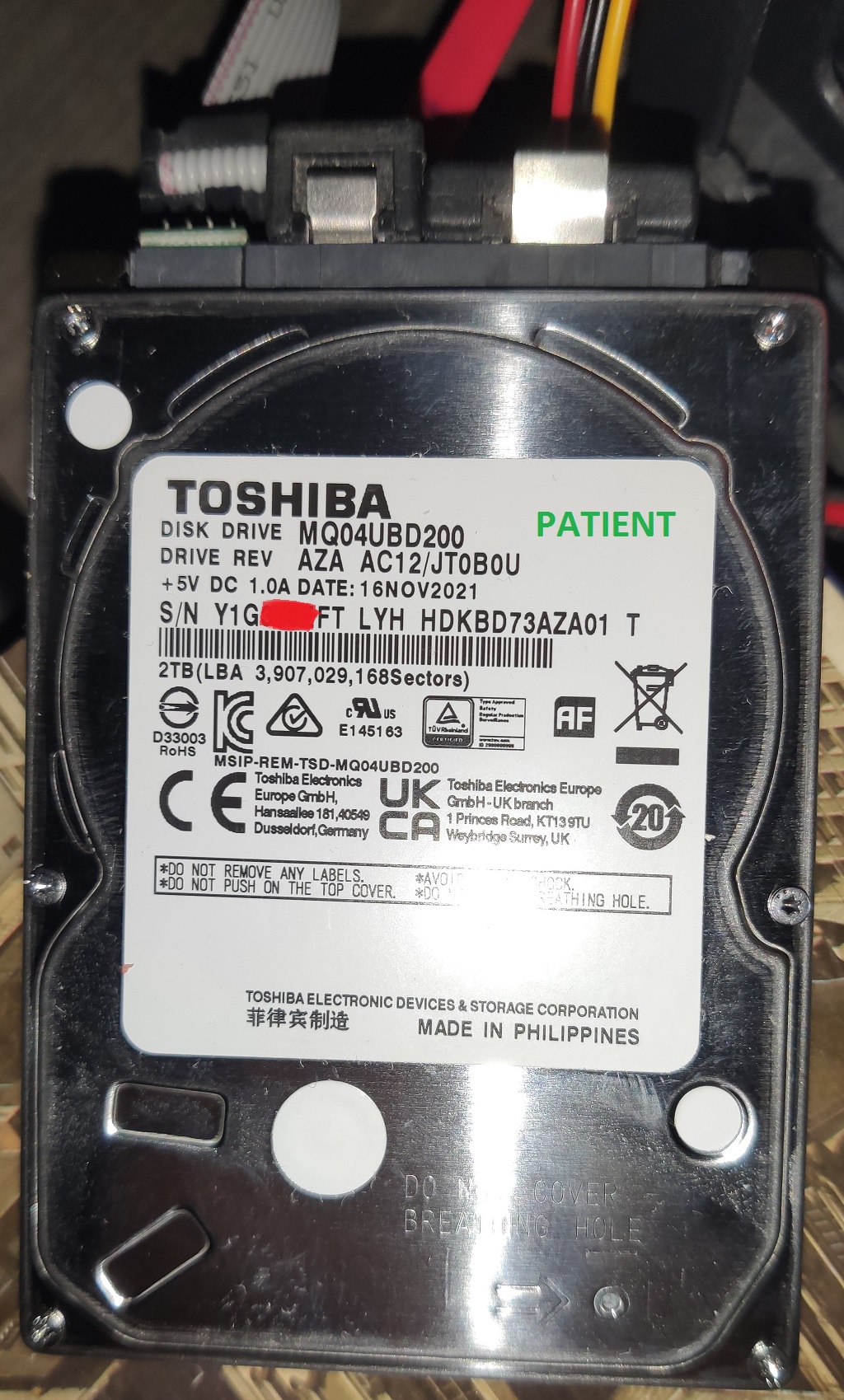

i need to swap heads on a MQ04UBD200 patient drive.

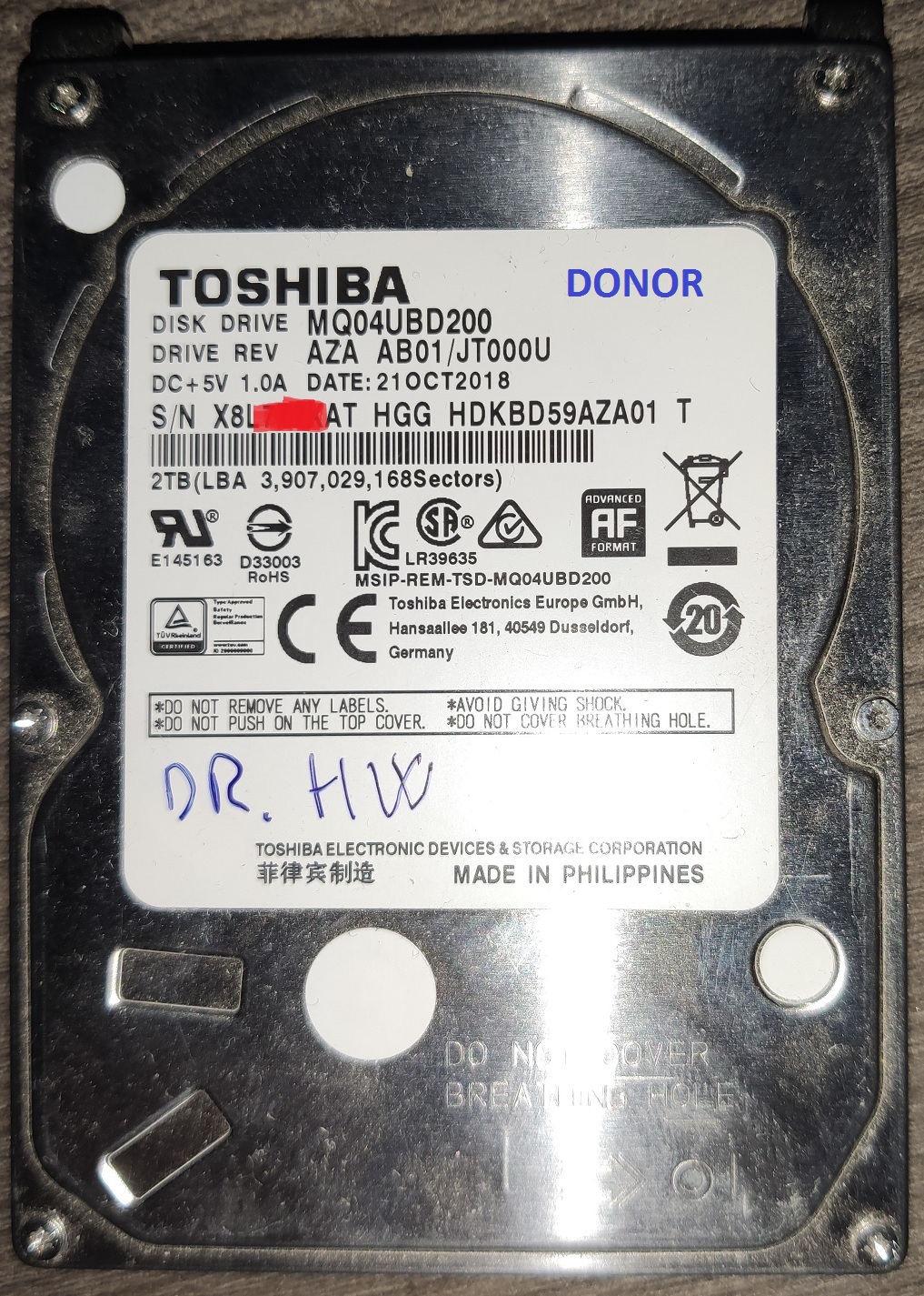

I've a MQ04UBD200 donor drive, i need to know if in your opinion heads are compatible with the patient.
Donor drive is 37 months older than patient.

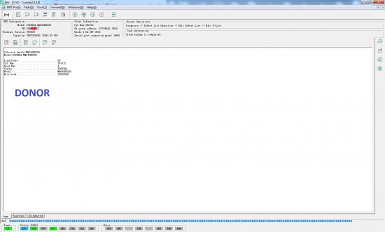

Donor Cyl num: 361612
Donor SPT: 3632
Patient Cyl num: 355807
Patient SPT: 3840

My firmware database:

I do not believe they are compatible.

Even though Toshiba are easier to be compatible I think drive rev and drive age are too diferent.

I often use Toshibas that are five or more years different. That's their beauty. Not like Seagate which are different every week.
