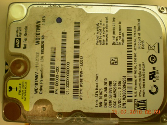

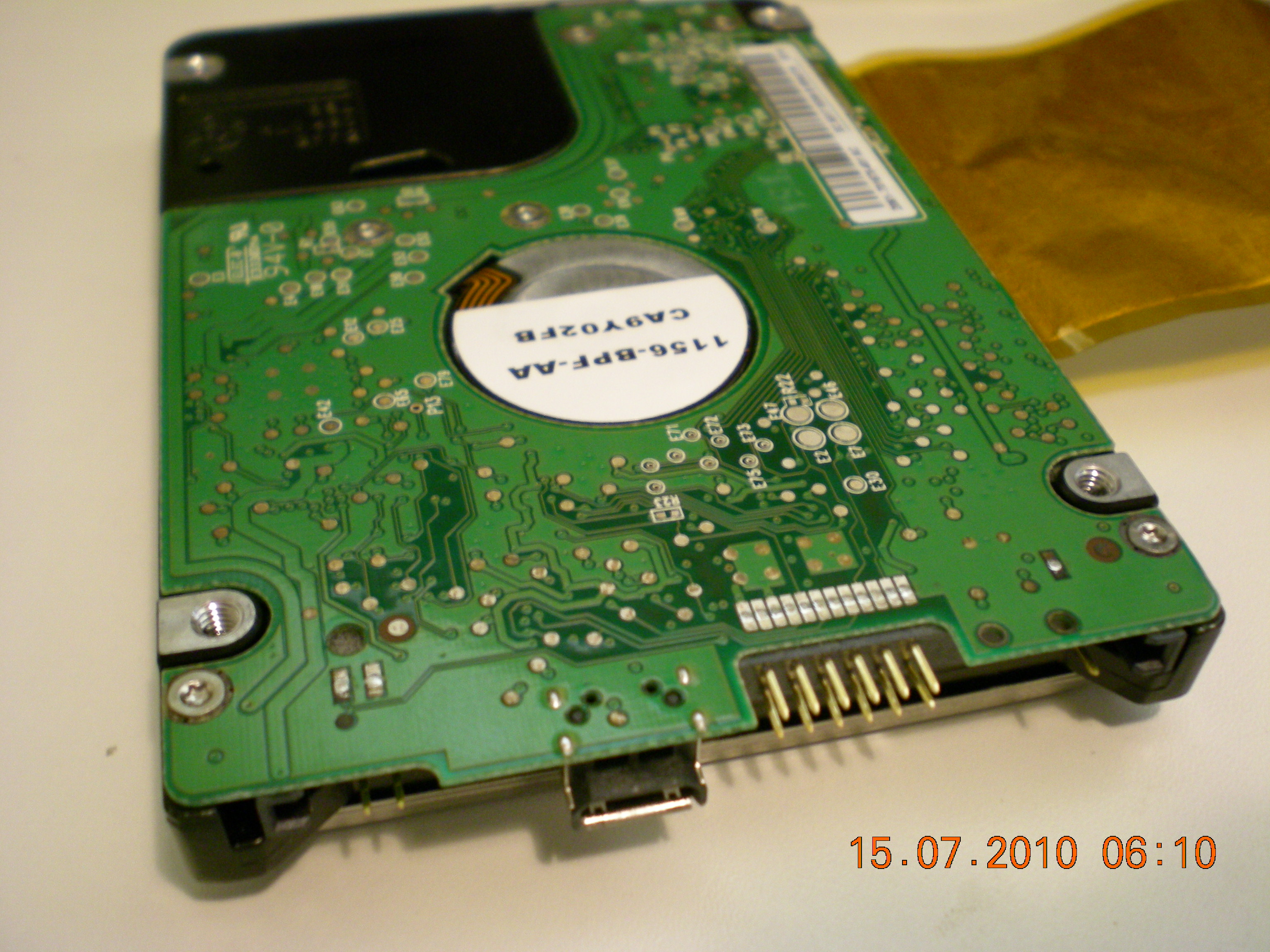

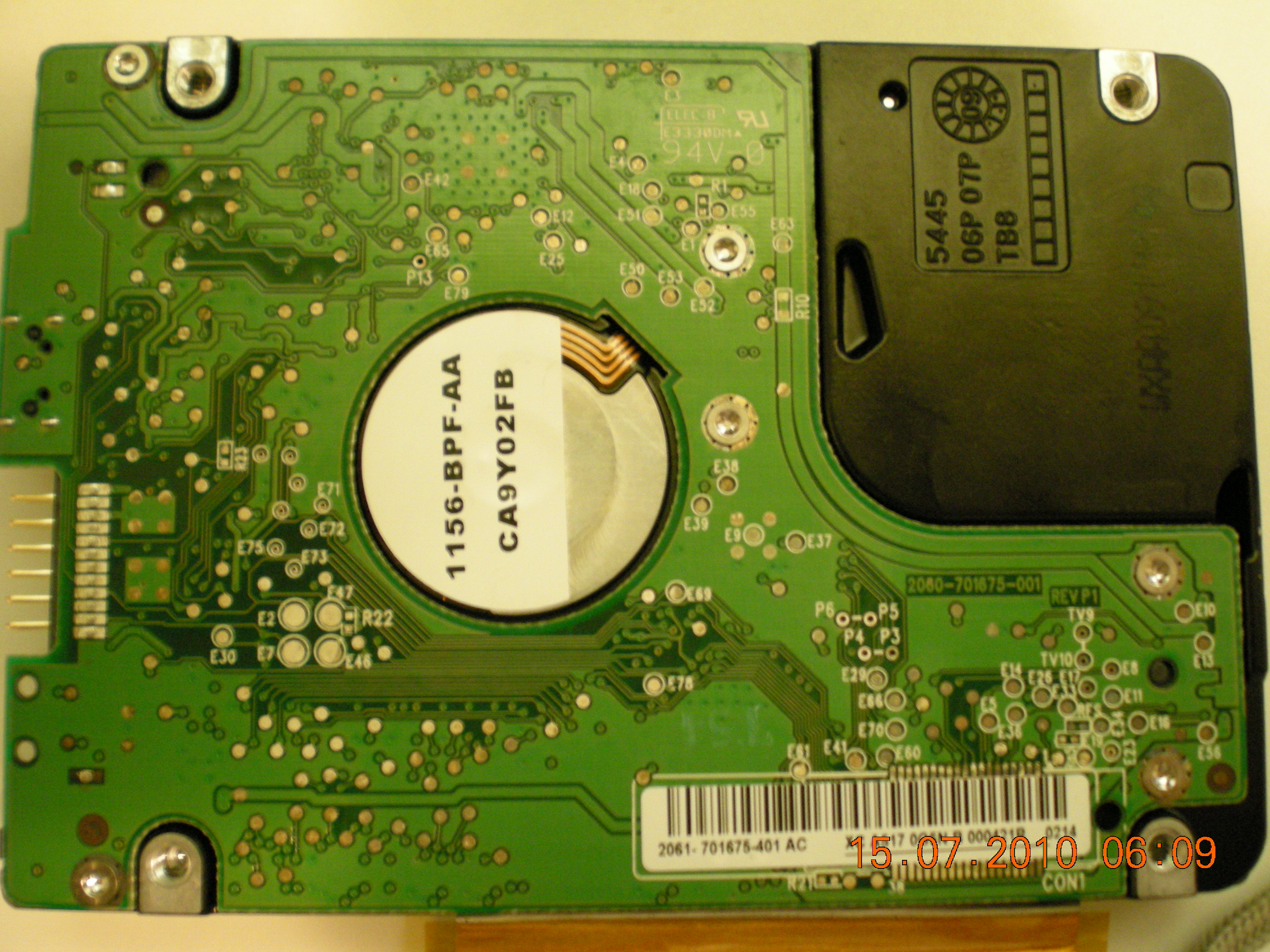

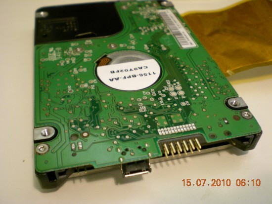

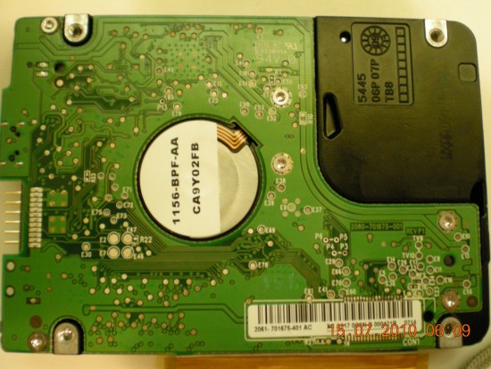

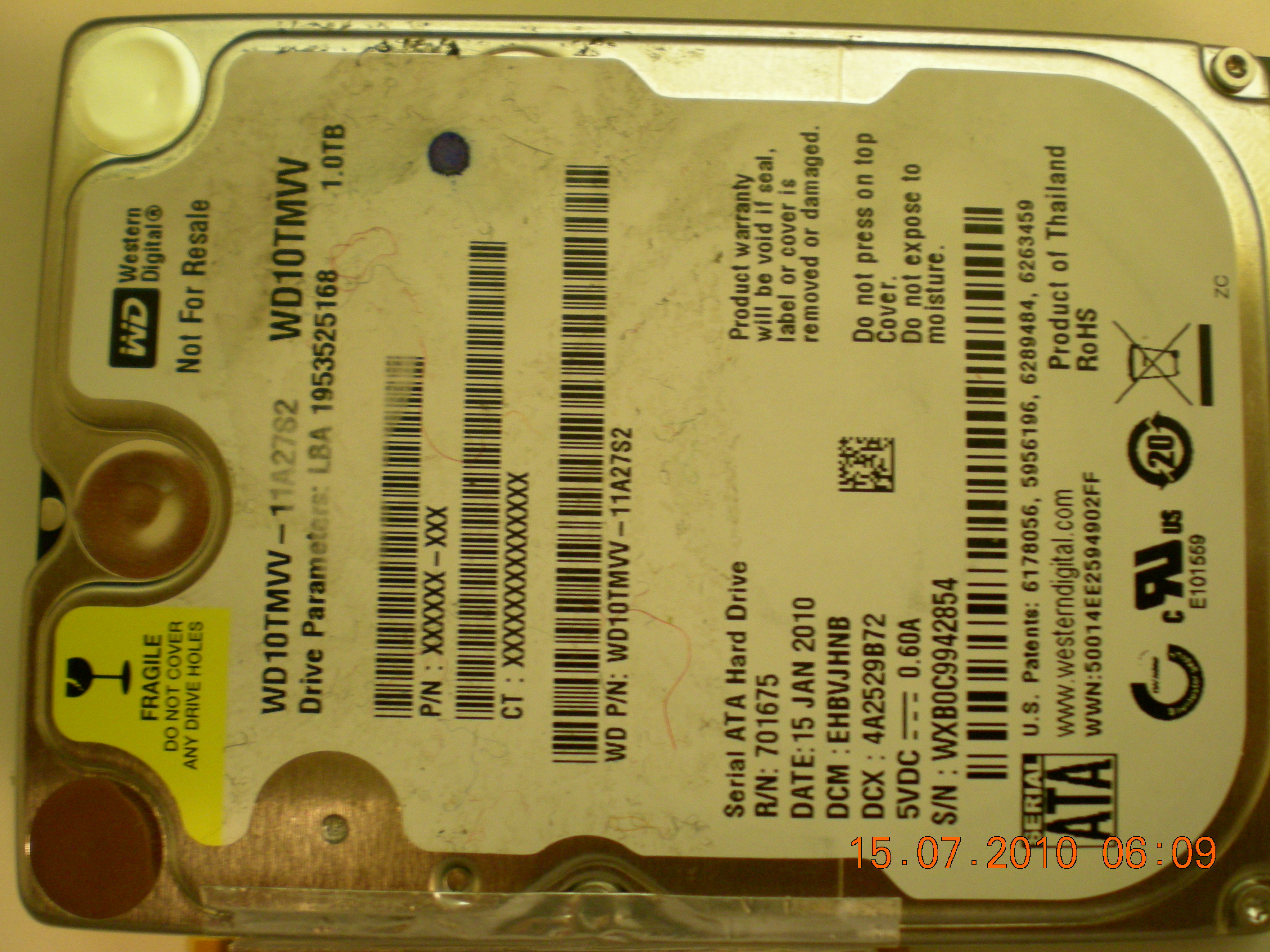

here is the images, i just got one HD to try
i was wondering about this subject results really
and thnx

einstein9 wrote:
HWHacker & Amarbir
and thnx
Lol ,
this will not solve it ,i am working on a solution should be able to finish this case this weekend

Good photos, but a bit hard to see through the HDA. (Putting on XRay glasses) oh yes much better. :wink:
One more photo please. :wink:
