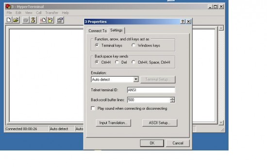

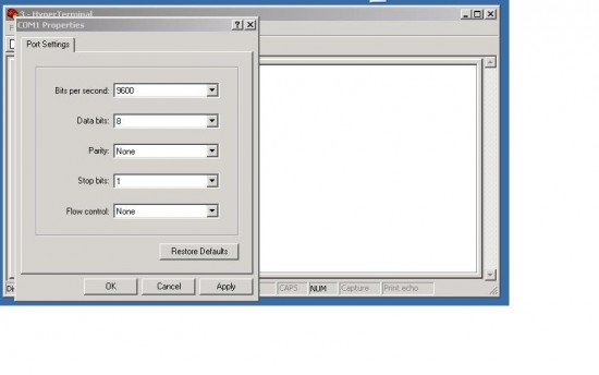

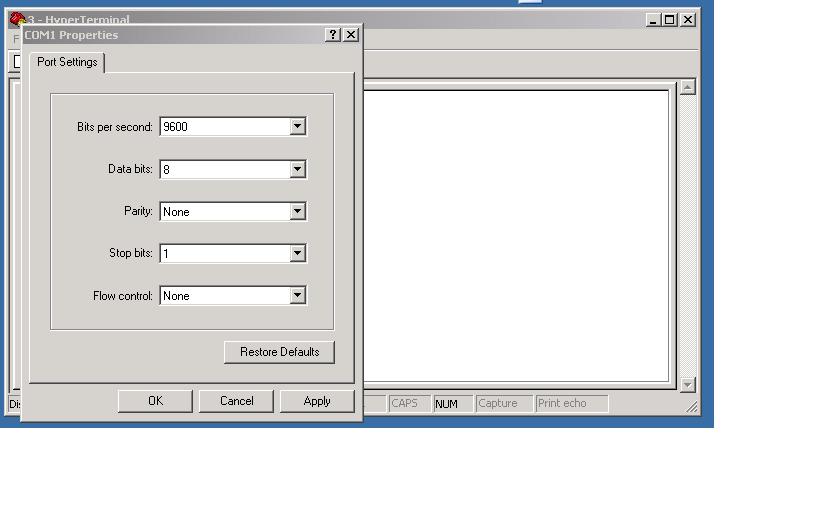

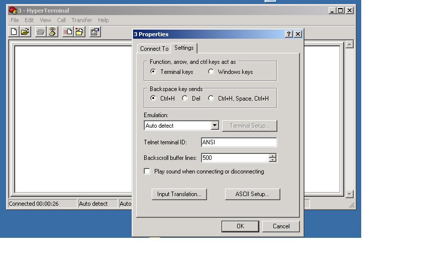

I guess your problem with terminal output is from Putty (Limited options)
have a look here @ the images

einstein9, thank you for your efforts and helping me getting a stab at this drive's speed. Unfortunately, it seems that HyperTerminal gives me the same output (again ctrl-z ctrl-z and then just letter the "z" all the way):
