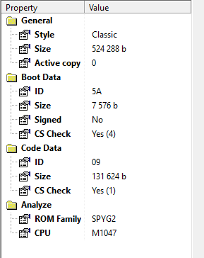

Hello
We have here HDD WD30NMZW-11LG6S1
Knows somebody which model of WD has compatible heads for this hdd ?
thanks

 Post subject: Re: WD30NMZW donor
PostPosted: February 28th, 2023, 7:21
Joined: March 2nd, 2006, 11:14
Posts: 169
in WD unlock utility it shows
that it is SPYGLASS2
so probably it's not compatible with WD40NMZW-11GX6S1
PostPosted: February 28th, 2023, 9:39
Joined: December 9th, 2009, 5:31
Posts: 67
Based only about the information on the label - that's all you need to find a twin disc.
However, if they differ or similar - you must have such a disk (donor) in your hand.
Then - to be sure - you need to unlock the patient and donor roms.
And compare three parameters:
Surface format revision
Preamp Vendor
Preamp revision
Of course, with a consistent number of heads and their mapping....
PostPosted: February 28th, 2023, 14:05
Joined: September 11th, 2012, 11:52
Posts: 32
Location: Central Europe
WD30NMZW-11LG6S1
WD40NMZW-11GX6S1
WD40NPZZ-00PDPT0
Although all these 3 are from the same SpyGlass family, you need to check the number of heads for your 3 TB HDD. The number of heads can differ from 4 TB HDD.
