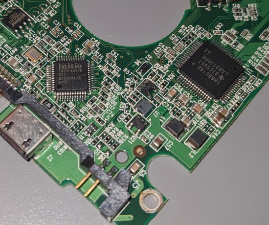

Could it be that HDDSuperClone is fooled by the encryption chip
File comment: Encrypting chip initio INIC-1607B
100% bad sectors sounds a bit dramatic for a drive which doesn't sound unhealthy to my hears, here's a recording of it spinning up: https://we.tl/t-5Afi8NykLq (sorry I couldn't attach the file here, it's not allowed by the forum).
What do you think should be my next step?
