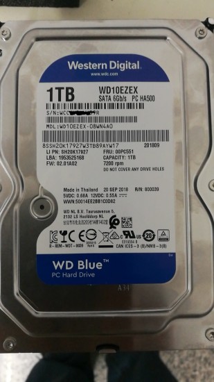

WD10EZEX-08WN4A0 no DCM code on label
April 6th, 2023, 13:04

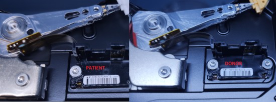

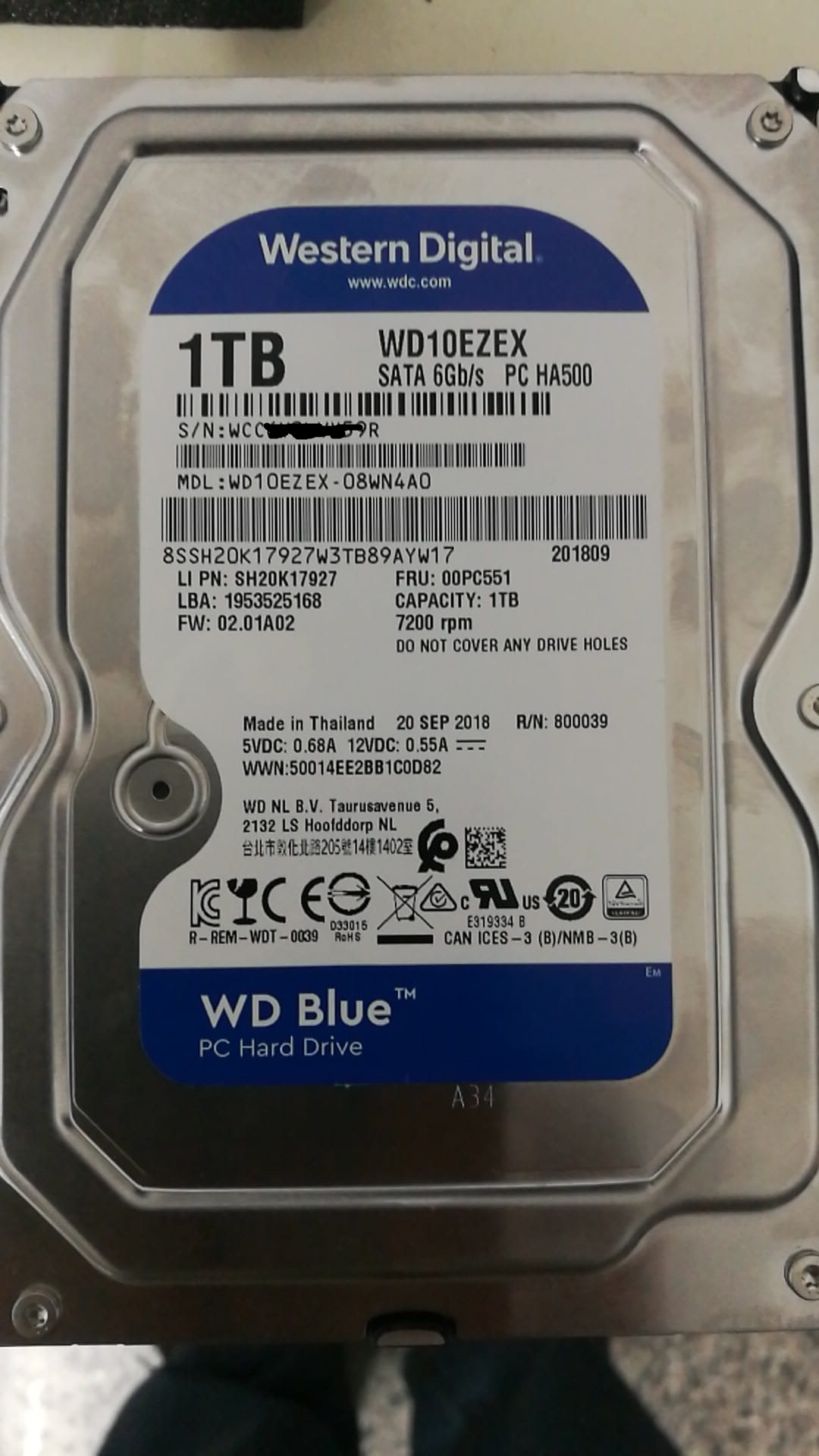

i've this drive with damaged heads, i need to search for donor but on this patient drive isn't written DCM code on label.
How to find it?

Re: WD10EZEX-08WN4A0 no DCM code on label
April 6th, 2023, 14:17
Hi!
Look for head type in 0a module first.
Possible donors are (from platter capacity database):
WD10EZEX-xxRKKAx/xxZF5Ax/xxBN5Ax/xxKUWAx/xxMFCAx/xxM2NAx/xxWN4Ax/xxBBHAx 1TB (1/2)
WD10EZLX-xxK4KAx 1TB (1/2)
WD10EZES-xxUFAAx 1TB (1/2)
Good luck!

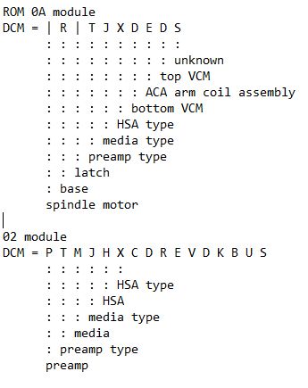

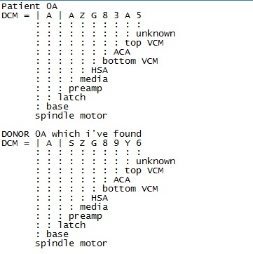

Here are the SA 02 module, and ROM 0A module DCM codes.
April 6th, 2023, 15:29
I don't think they are compatible for head swap. :?
What do you think?

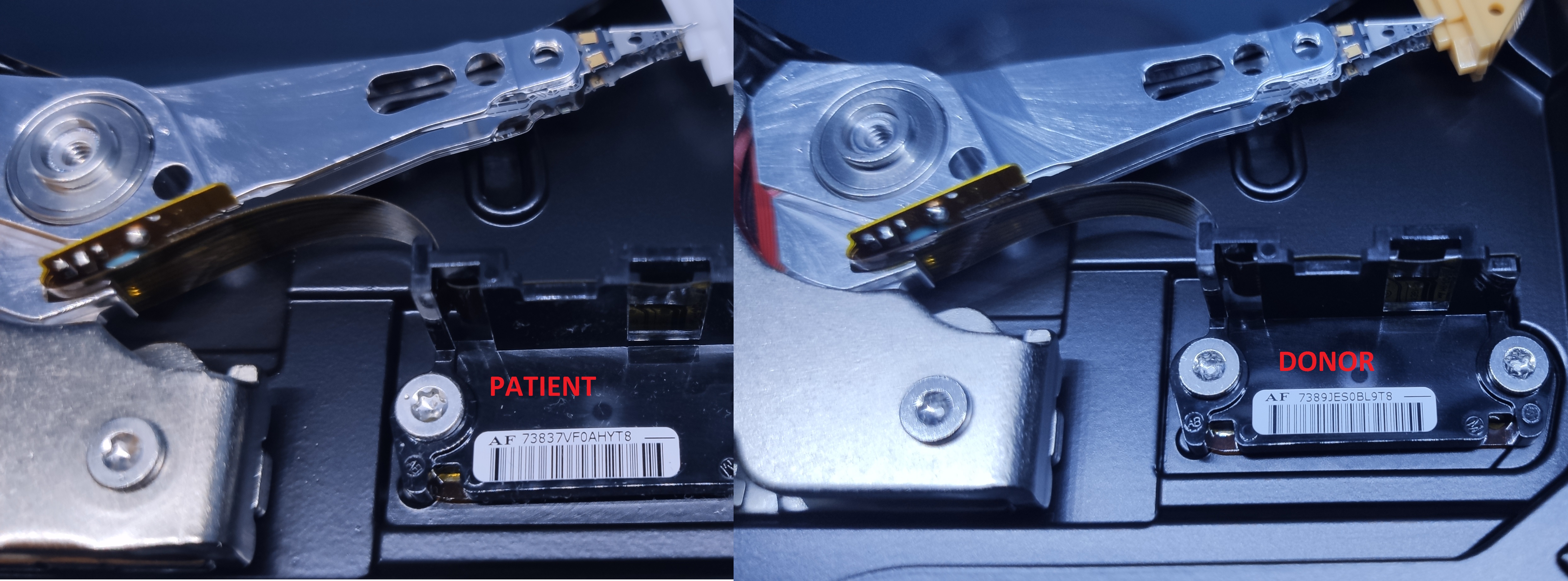

April 8th, 2023, 13:50

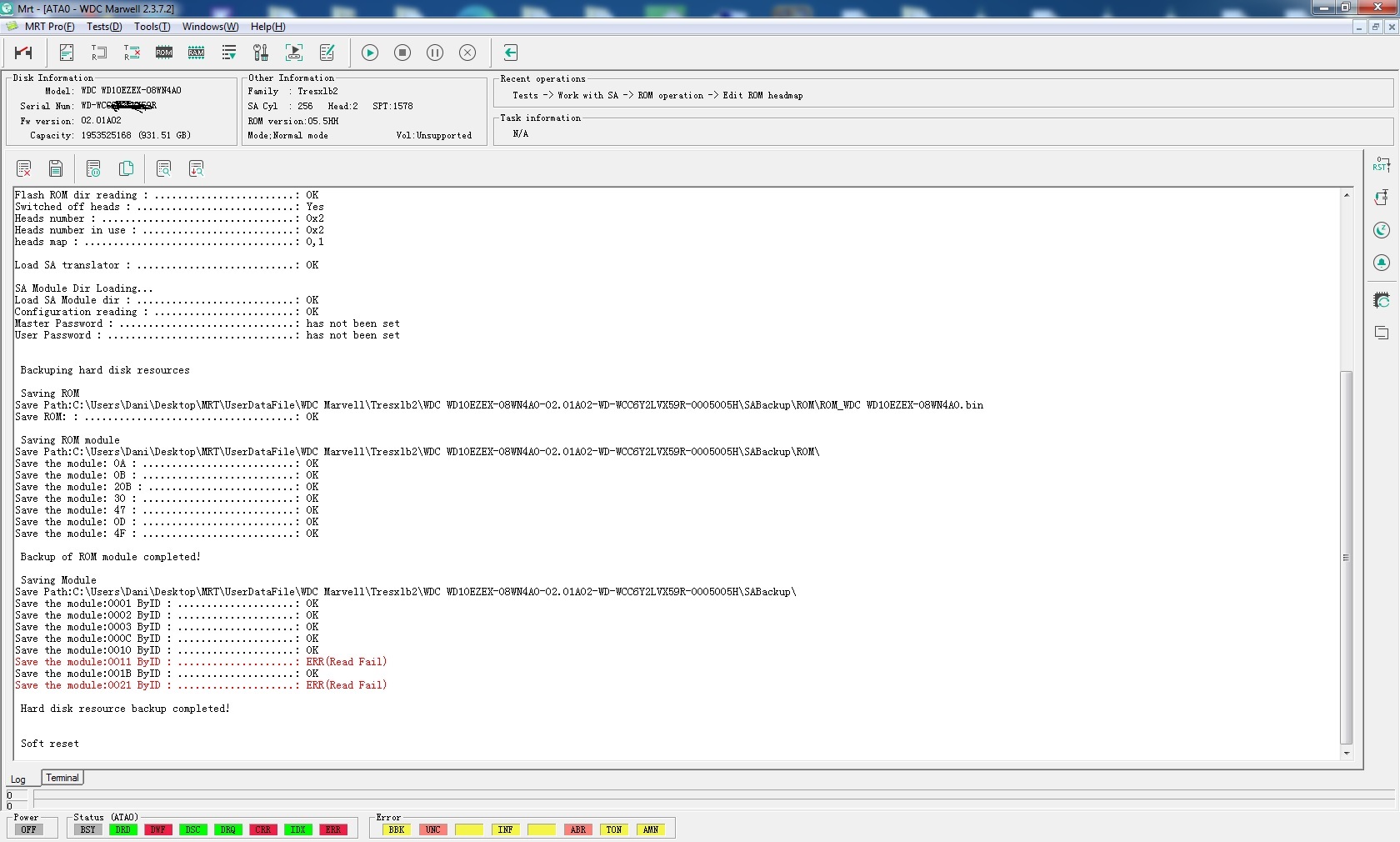

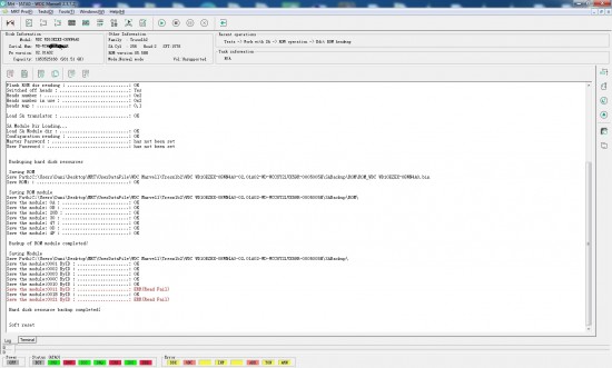

i swapped heads, patient drive got ready once i powered it.
I was doing module backup when it started clicking while was reading module 21.
It got error also on mod 11.
Now it just click. I mounted donor heads back to donor drive, they're dead! :(
In your opinion, are this symptoms due to incompatible heads or due to some sort of damage on patient SA ?
Patient HSA label has different number than donor HSA label.
In your opinion is this donor compatible or not?
April 8th, 2023, 21:07
SA is damaged IMO, check heads visually
April 8th, 2023, 21:48
You're right pepe, SA must be damaged because now i see debris on donor head 0. :(
Would a hot swap help in your opinion? I was able to backup from patient only modules 01 - 02 - 03 - 0C - 10 - 1B
Or better making boot SA on head 1?
April 9th, 2023, 11:09
Heads are compatible, but media were damaged.
Before HSA swap i always inspect sliders under microscope.
I think this drive is gone now.
