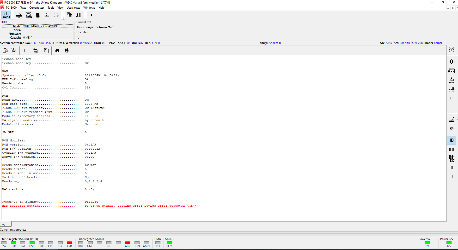

Have you checked PUIS ?
 Post subject: Re: WD red NASware 3.0 not spinning
PostPosted: April 25th, 2023, 10:03
Joined: April 12th, 2023, 8:12
Posts: 8
Hi Lardman please see attached screenshot, I hope this helps solve the issue?
