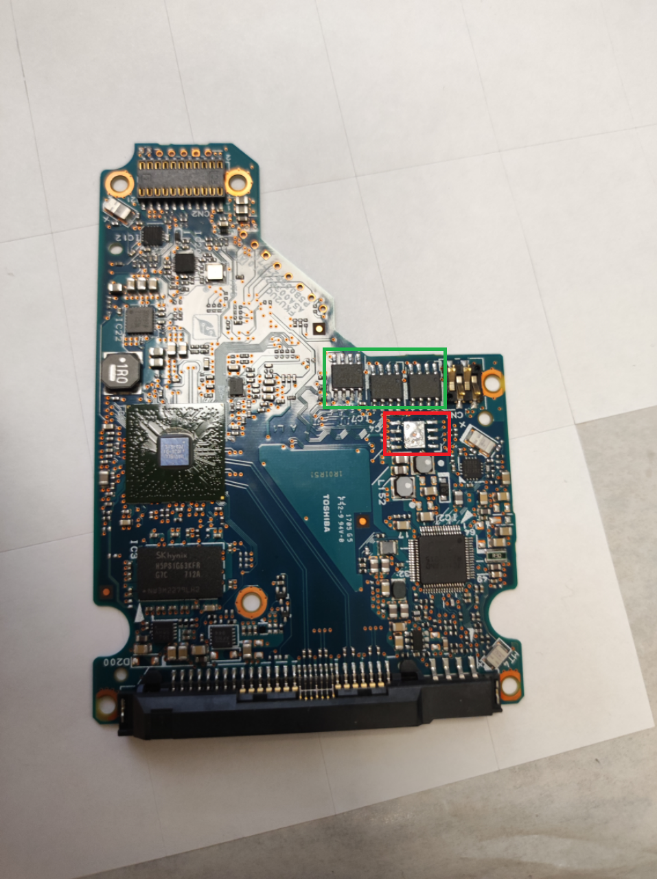

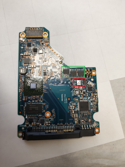

Hi Guys
We have here Toshiba 2.5 SAS drive with PCB defect
We transfered the Flash (marked red) but the drive doesnt spin after that
There are also 3 other Winbond flashes (marked green)
Is necessary to transfer also this 3 flashes?
Thanks for advice
 Post subject: Re: Toshiba SAS PCB
PostPosted: April 28th, 2023, 12:29
Posts: 17335
Could we see the ROM dump?
