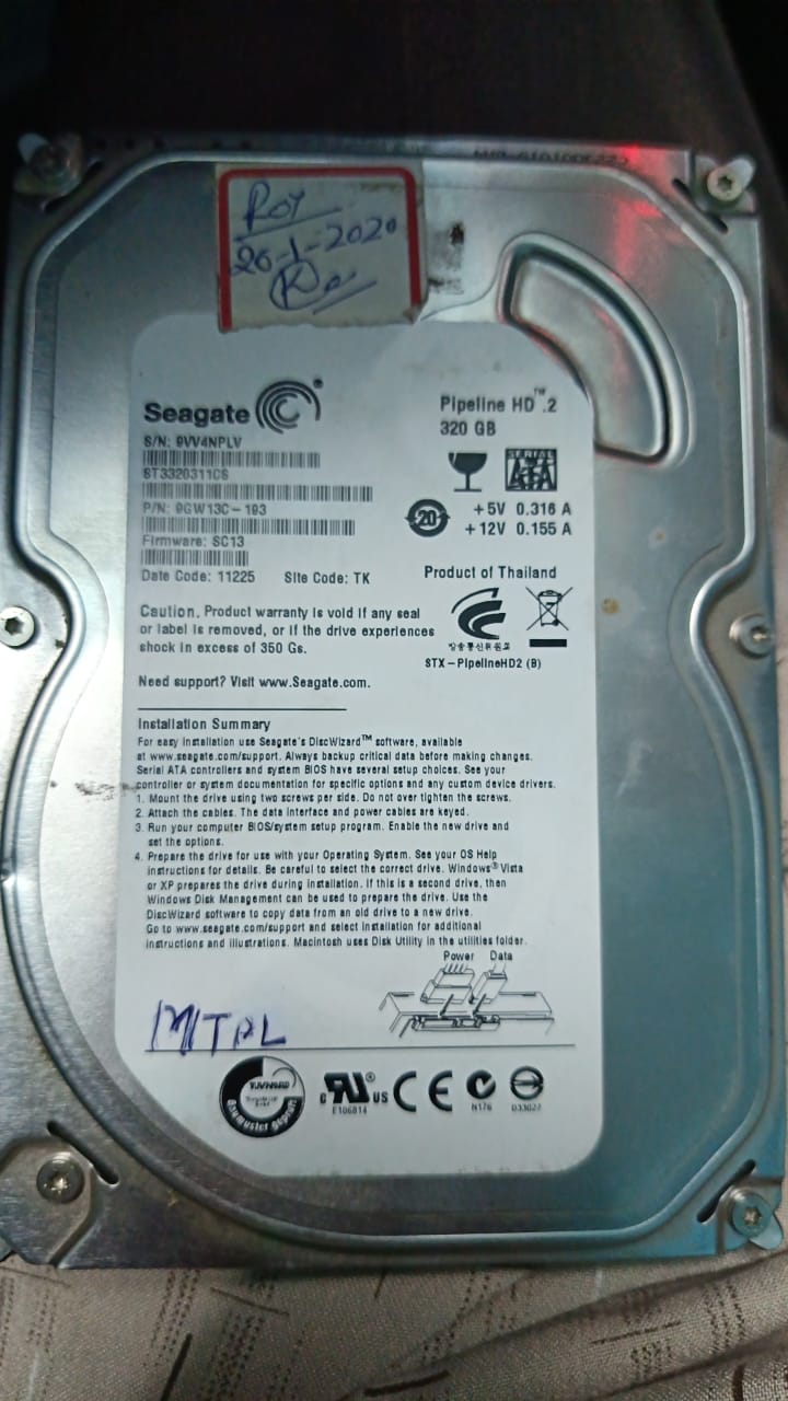

Hello Members,
I have a hard disk which details is below. Problem is Hard disk in not detecting. it is powering on, No clicking Noise, When Plug Both Data cable and power cable, Hard disk reset every time on seagate terminal. when remove sata data cable and short the read channel than T Promt appear. after that i took following steps but not success.
( 1 ) I applied m0,2,2,,,,,22 command but without finish LED:000000CE FAddr: 00291073 error.
( 2 ) After This error i Swap rom to another working pcb and apply m0,2,2,,,,,22 but same error.
( 3 ) I contact respectable forum member GPS Sir ( Madurai - India ) and tell him about this error, he told me to read sys file 01B, 28, 35, 93 files both copies, when i read these files, all files both copies not read by terminal some files have Diag error during read, only sys file 93 read perfectly both copies. after that GPS sir provide me another 01B, 28, 35, file to write back to both copies. I write back all these 3 files both copies and successfully write. after that GPS sir suggest me to apply m0,2,2,,,,,22 command but not success and LED:000000CE FAddr: 00291073 error occured. GPS Sir suggest me this command F"RWRecoveryFlags",00,22, F"BGMSFlags",00,22, F"PerformanceFlags",043C,22 and performe again read sys file 01B, 28, 35, files but LED error after apply this command. GPS sir also suggets me to read sys files 135, 136, 137, both copies but same error both copies not read successfully and some have diag error. I also submit CTRL+X log to GPS sir but he told me that you have some issue in sys files but not know which sys file is currupted. Please See CTRL+X log file and someone tell me which sys file is currupted? Please help me to solve this problem. Thank you.
