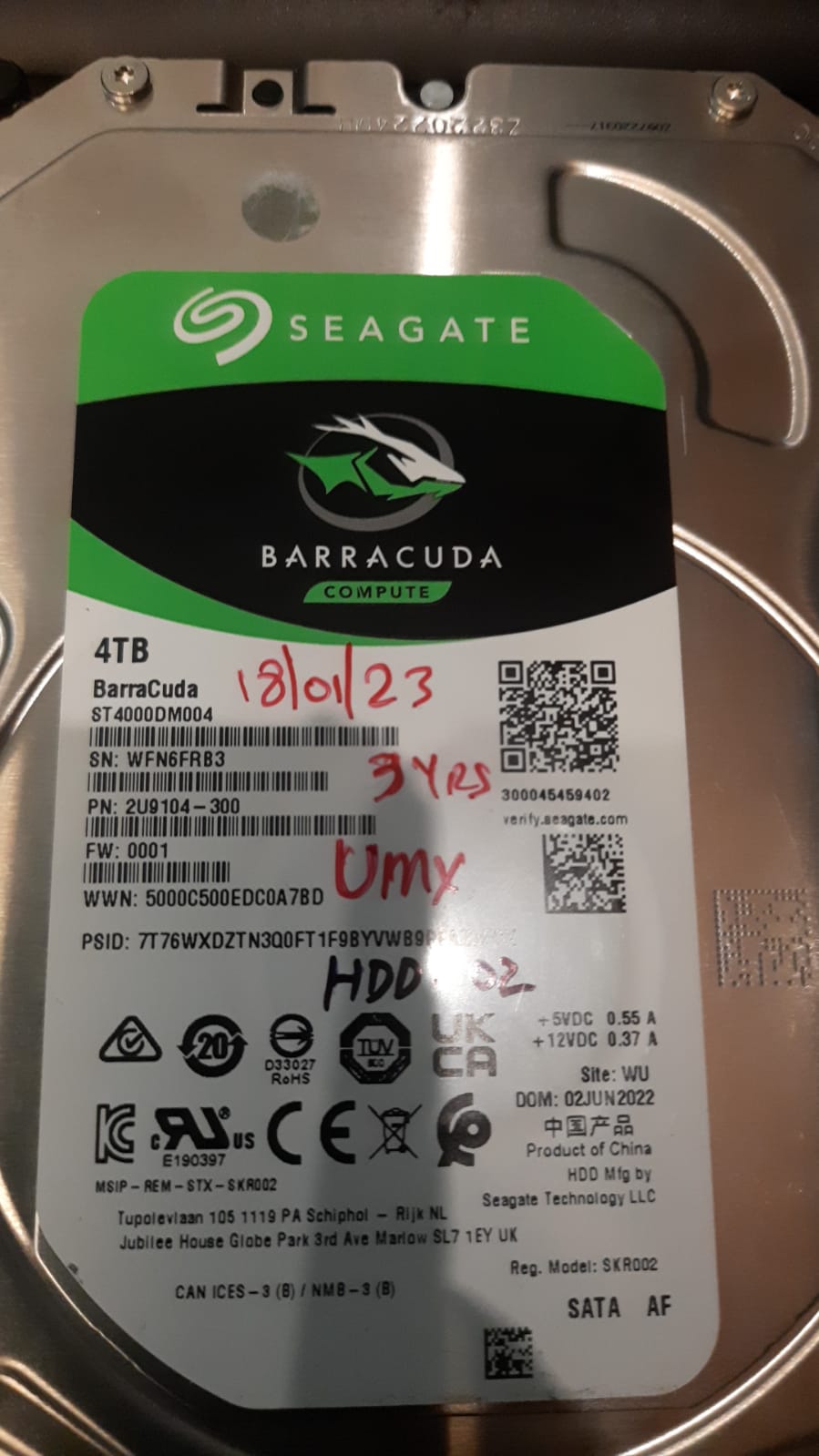

Hi I have got a Seagate ST4000DM004 P/N 2U9104-300 3.5" Internal Drive, Problem is with the PCB diode was short and even after replacing diode, PCB still has problem as pc3k cant read rom so I read rom by rom programmer and wrote the patient rom in donor PCB after writing I get the below terminal output : I even had a doubt whether rom was overwritten but the client had directly brought it to me.

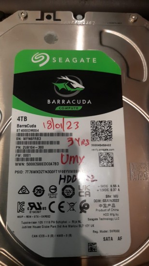

File comment: Pls find the drive

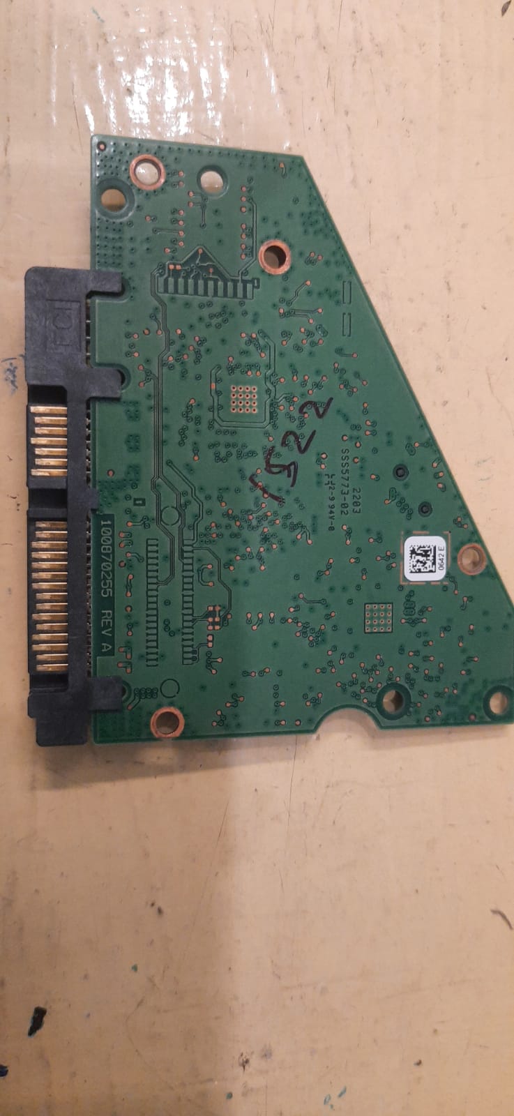

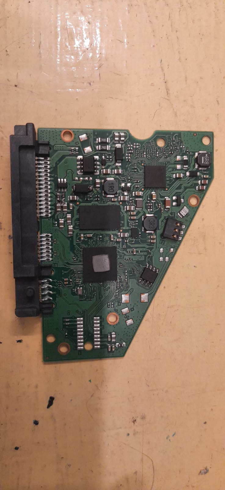

Flow a blob of solder over the zero-ohm resistors. They will probably be open circuit. If you don't know what I'm talking about, upload a photo or at least tell us the PCB number.
 Post subject: Re: KINDLY HELP ME FIX THE ROM
PostPosted: May 10th, 2023, 4:04
Joined: July 11th, 2018, 10:55
Posts: 43

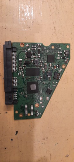

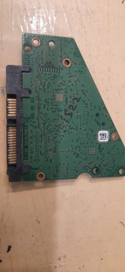

Pls find the pcb attached
File comment: diode was short so i replace them
