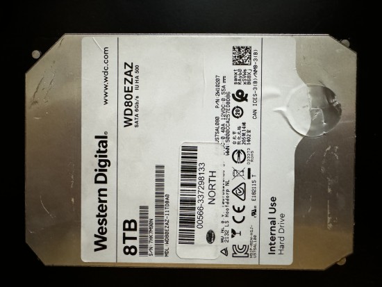

I intend to replace the headstack in my clicking and inaccessible drive. However, I have two issues for which I could use some advice. This is my first attempt at DIY repair/replacement:
1). Where do I find a replacement headstack specific to this drive. Is it best to just buy a new WD80EZAZ-11TDBA0 and transfer the part from the new one to the one with my data?
2). There are no screws on the cover of this drive. The cover on this white label Western Digital drive appears to be without a single screw. How do I get inside the drive?

It's a native HGST helium model. I'd say your DIY chances are absolute zero.

Thank you for the HGST Helium model name. I previously did not know what to look for. Nothing is impossible. I found out how to do this.

Plenty of DR pros have tried, but only a handful claim to have had any success with headstack replacements in helium models. Good luck. (I'm not a pro, just an interested observer, and I would say that my chances wouldn't be much better than yours.)
