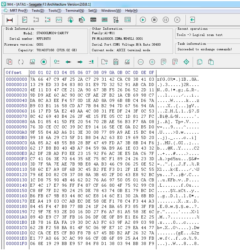

ST4000LM024-2AN17V MRT detected as Family:A1-M11 FW:M1A1800C6.SDMA.MD45L1.0001
PCB: 100794976 REV. C
HDD from Seagate OneTouch
HDD comes with Bsy State. After Shorting Read Channel got F3 T>
From Ctrl+x get Sysfile 132 is not able to Read.
After Power Reset hdd ready after some seconds.

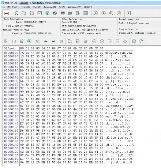

But when try to access use Area getting encrypted sectors.
Tried by reading some random area and scanned by R-Studio There is no single file found.
Sector 0 is same in both unlocked and locked ROM
Tried Translator m0,6,3,,,,,22 getting the same sector 0
is there any solution for this?

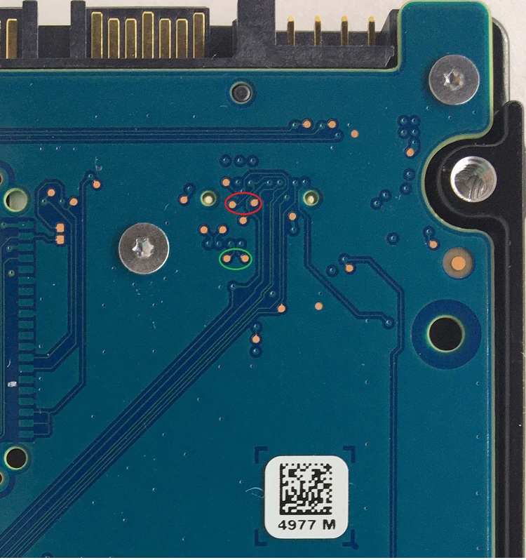

I had done Big mistake.
I had Shorted Red Marked but got F3 T> Prompt from Bsy after getting some Servo Err (Actually have to short Green Marked)
What is that Two Points?

The GREEN is the Read channel

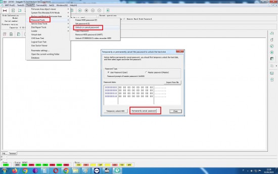

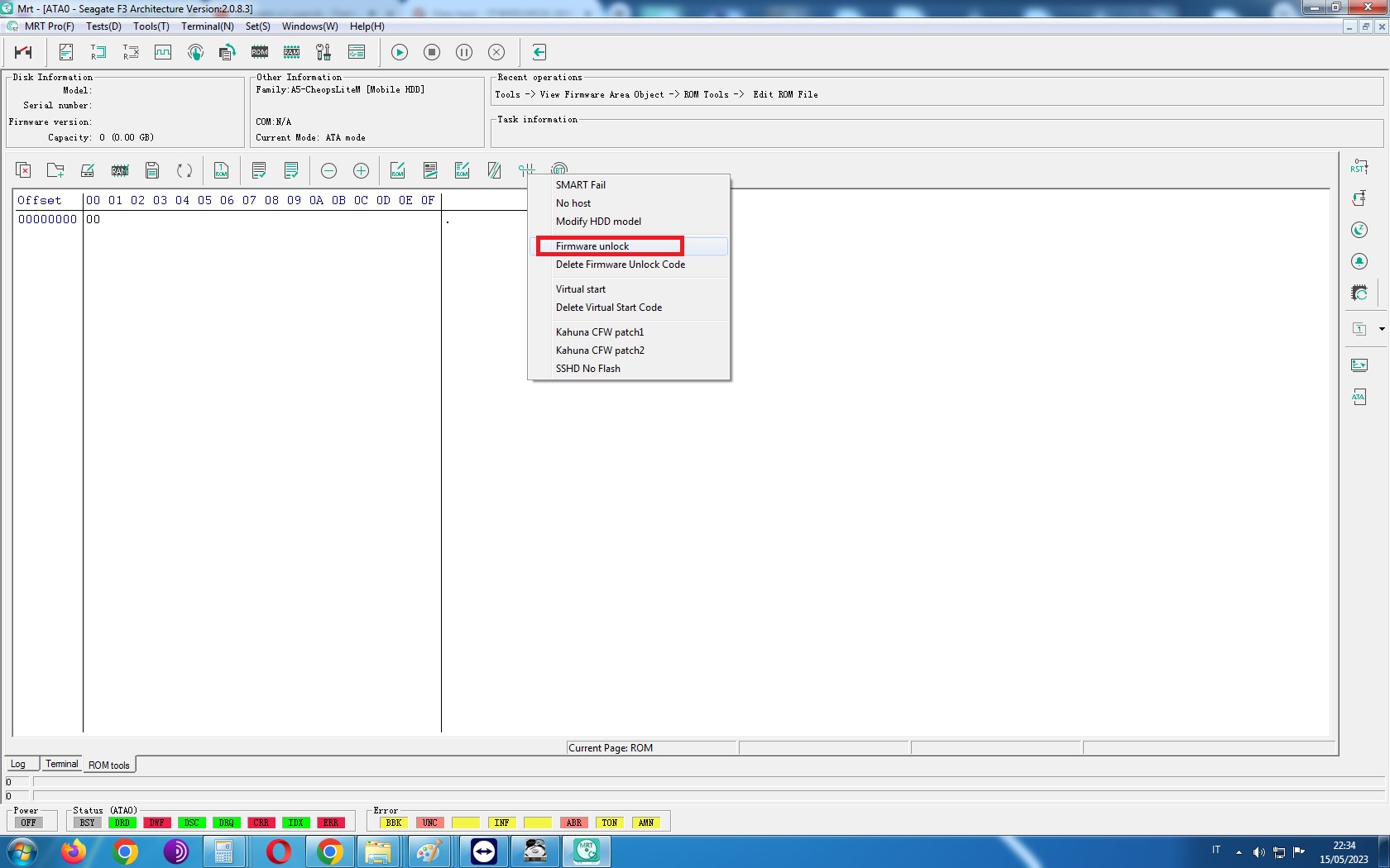

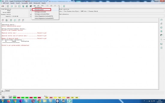

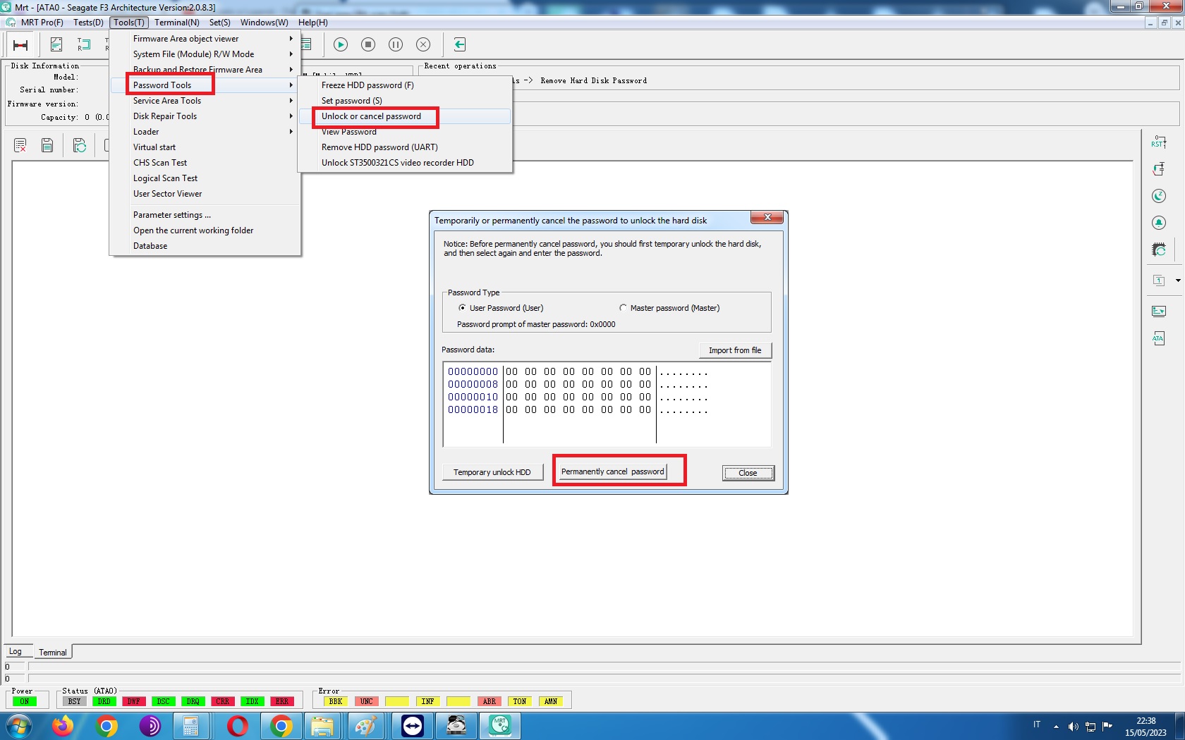

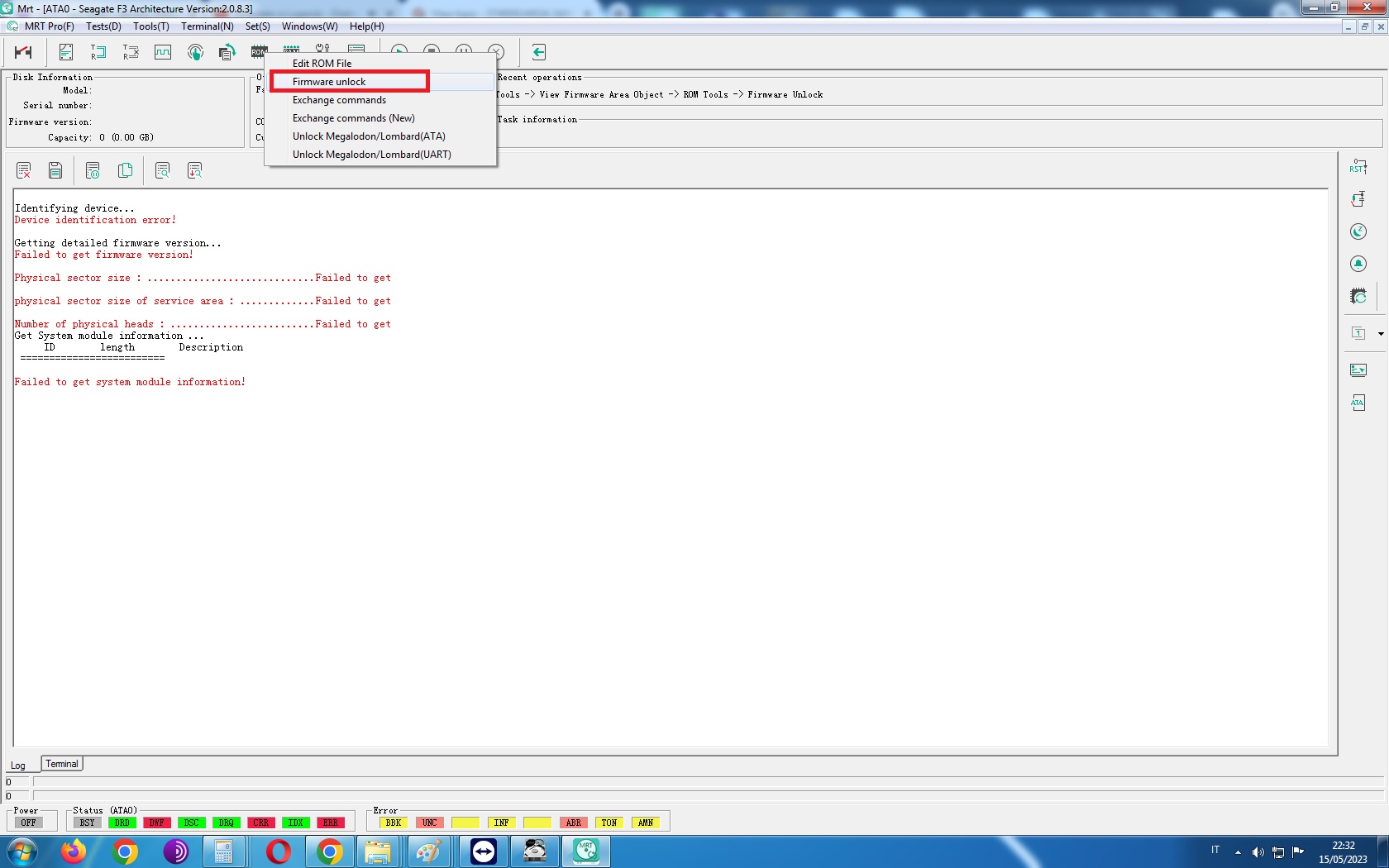

Where is the permanent unlock option in mrt?
I can't find it, i only see firmware unlock option.
The only option i see in mrt utility which i've found word "permanently" is in PASSWORD TOOLS menù... which is totally different think.
