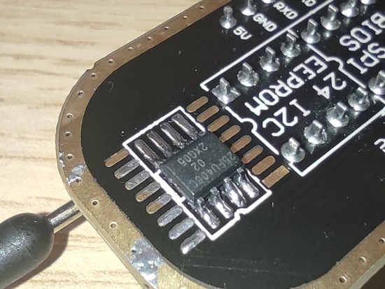

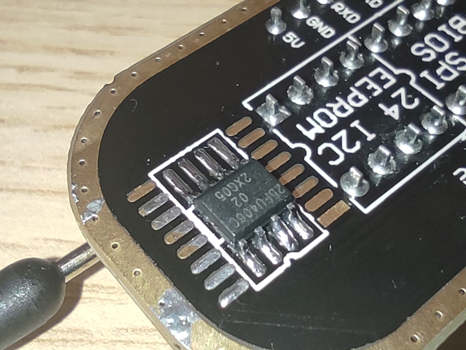

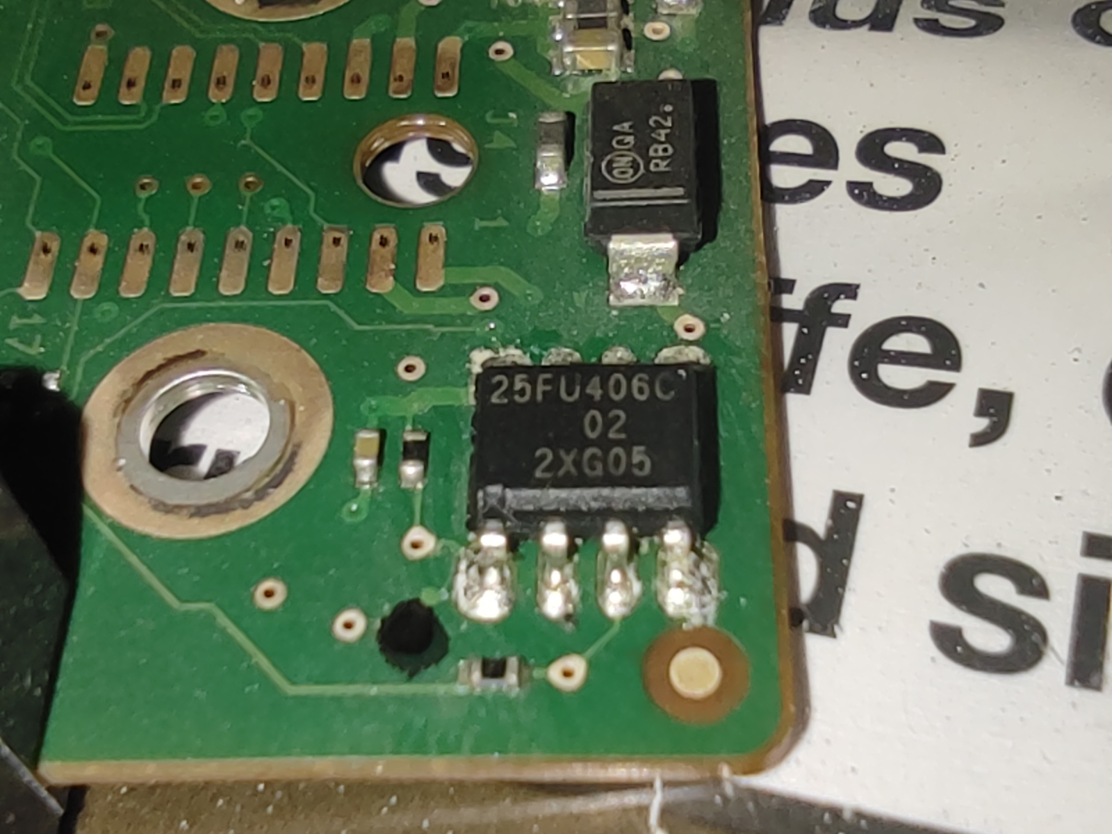

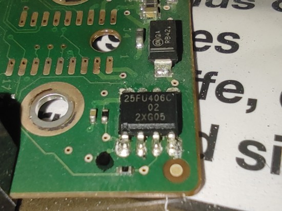

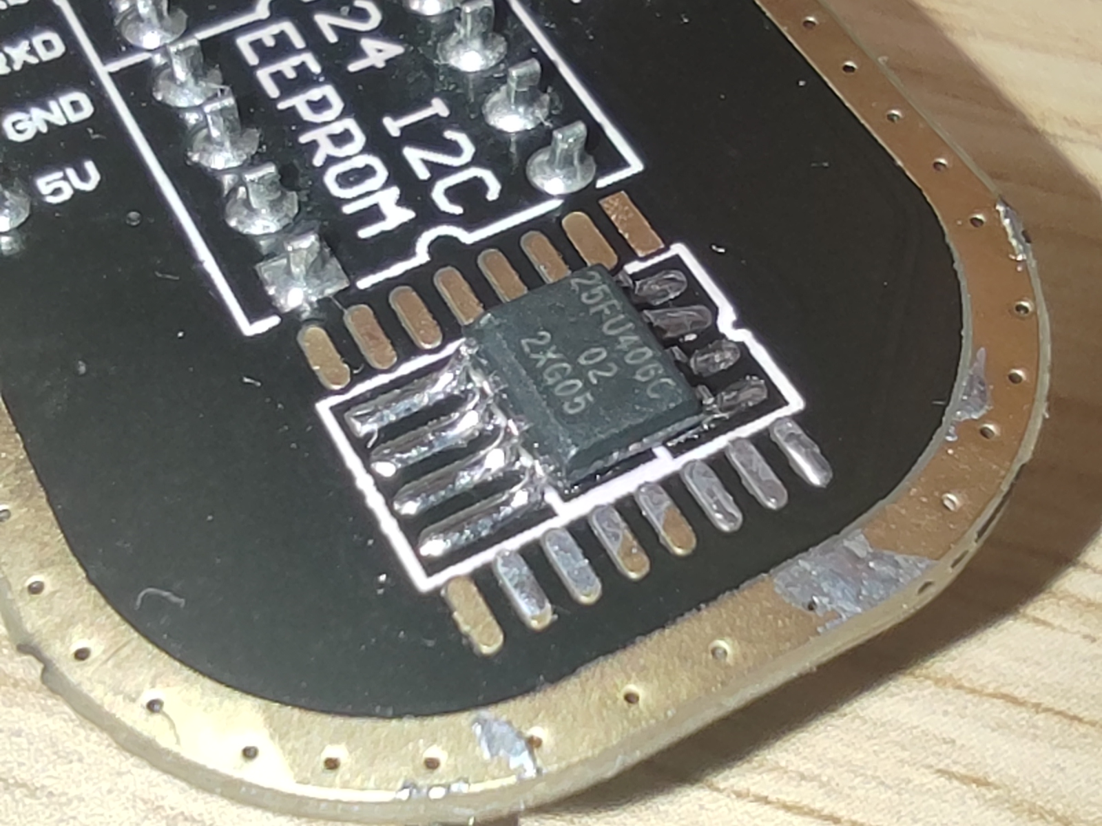

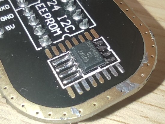

So I first wanted to dump the ROM to get the preamp type etc, and it turns out that the chip is not responding at all.
The ROM chip is labeled "25FU406C 02 2XG05" which is an On Semiconductor LE25U40CMC.
I use a CH341A programmer (with 3.3V mod) which I already used many times in the past.
I first tried to read it from the board, then as I couldn't see any response I tried to solder it directly on the programmer.
No response at all from that chip when I try to "Read ID".
I can confirm that the programmer works fine as I immediately attempted to read a similar chip like Winbond 25X40BLS02, without any issues.
Could it still be the programmer at fault or am I correct to say that the ROM chip is dead?
I'm experienced with micro-soldering and I'm 99.9% sure the soldering is not what caused it to die if so.
Any chance I can recover the data/ROM?

File comment: ROM on board

File comment: Soldered to the CH341A

fail servo op=0100 resp=0003 responseframe ffff 0000 0000 0000 0000 0000 0000 0000 0000 0000 0000 0000 0000 0000 0000 0000 ffff
if you saw this, ROM is surely fine.
based on that terminal output the problem is most likely heads (and surface) so you won't get far with a board swap most probably.

Ok the ROM is fine indeed, it's just the "Read ID" which wasn't giving anything from the AsProgrammer software of the CH341A :oops:
I was able to simply click "Read" and create a backup.
The preamp type appears to be 73 03 stored in ROM.
