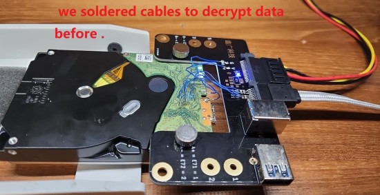

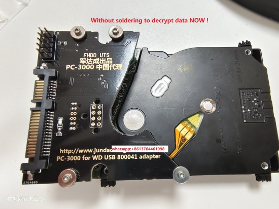

 Post subject: Re: WD WD20SDRW Encryption
PostPosted: May 23rd, 2023, 2:19
Joined: September 13th, 2022, 3:12
Posts: 26
Location: china
Hi ,
please contact me , I have a lot of client from IRAN
Jieshan Weng
Skype:jieshan.weng
Ph(whatsapp):+8613764461998
https://www.facebook.com/datarecoveryChina
http://www.datarecovery-china.com
