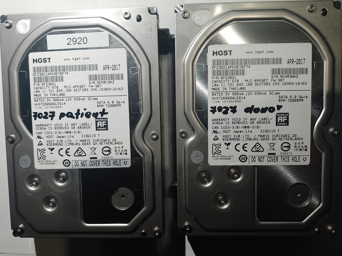

I got an HDD drive, brand HGST, model: HUS726060ALE614 with a capacity of 6 TB.
The good side - it is a conventional (no helium) disk.
The bad side - this is a drive that is not supported by PC3K...
The disk is detected correctly (ID, capacity, FW, etc.).

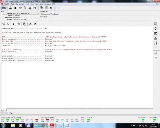

Unfortunately, there is no access to the data area - ABR error ....
Because PC3K does not support this family of drives - I have no way for deeper diagnosis of this case (SA and others) ...
I don't know what the Tech Key is for this family. PC3K detects it as the ARIES-KP family.
Based on the interview with the client, the drive was not exposed to any impact (mechanical) factors...
Except - there was a moment when someone else had it and used it for several hours.
The disk "died" slowly - over several days. First errors appeared, then problems with copying - and finally it "died" ...
So it rather indicates - that some slight "impact" factor has occurred...
After the first "inspection" - something about the boot sound of this drive made me disturbing...
I asked the customer if he had another, the same disk.
Fortunately, he confirmed ... This drive was bought together with several others - the same.
The same twin disc was delivered to me.

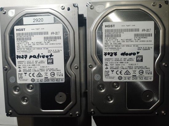

Photo of the front of the patient and donor below (patient and donor - front.jpg).

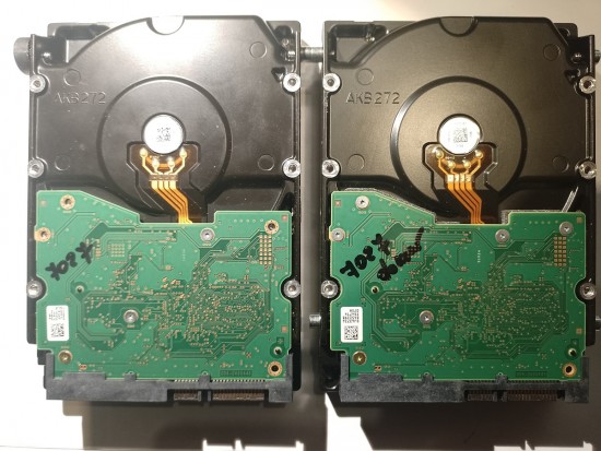

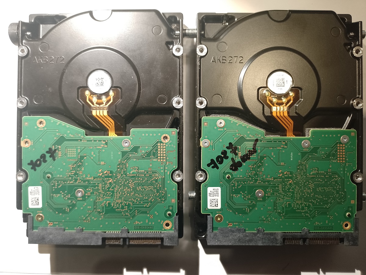

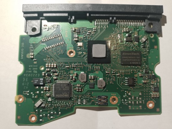

Photo of the back (PCB) of the patient and donor below (patient and donor - PCB's.jpg).

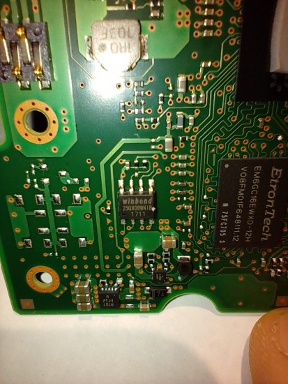

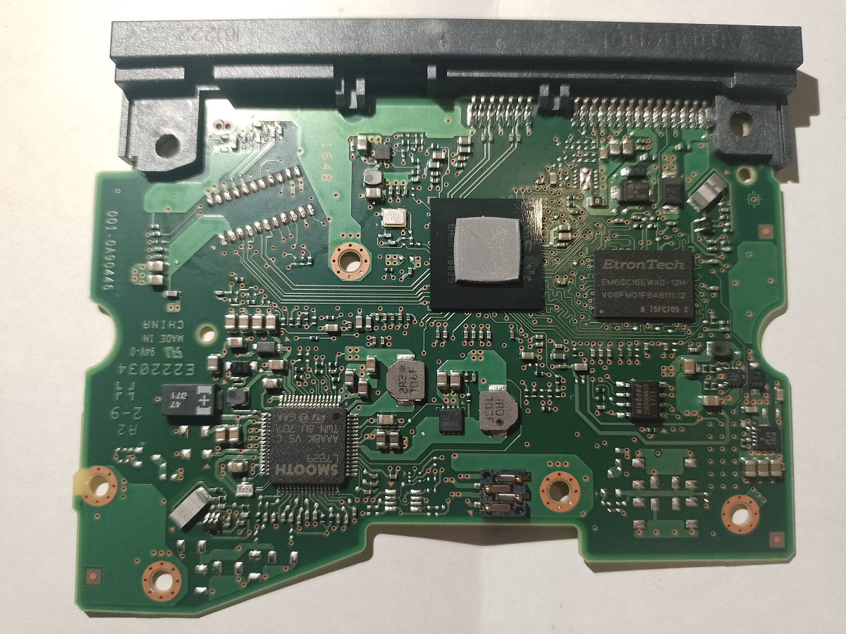

PCB photo:

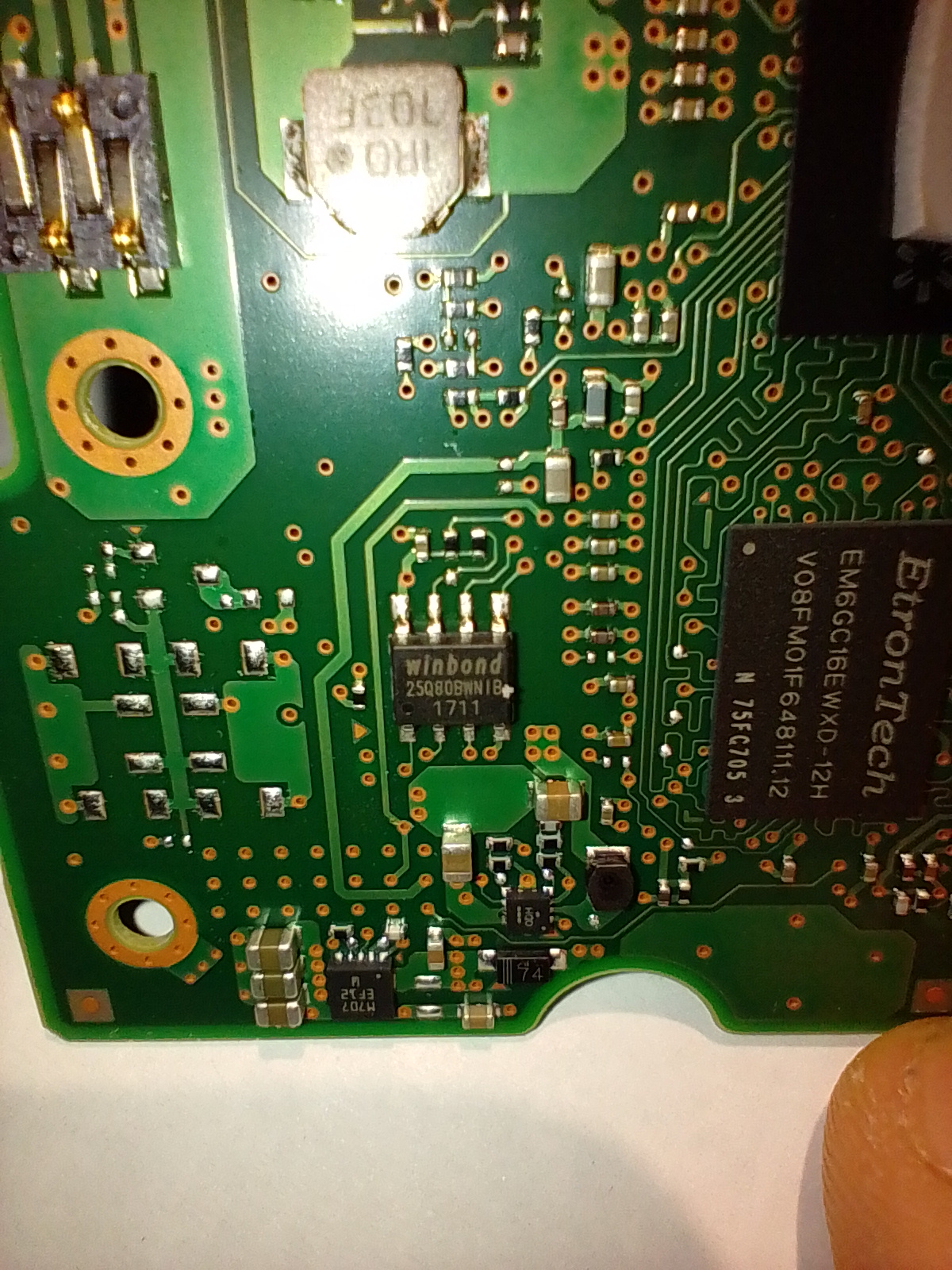

Probably ROM chip (1 MB):

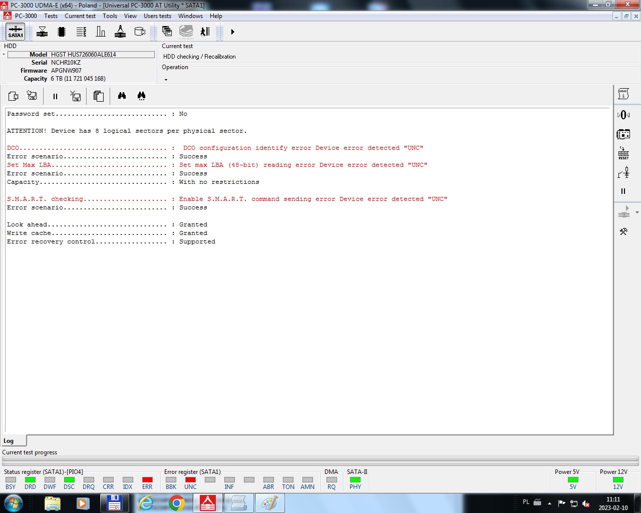

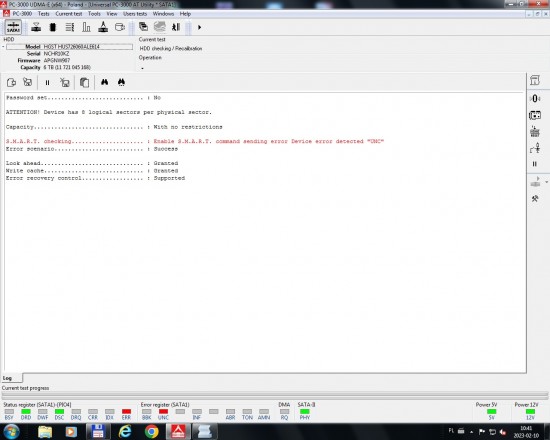

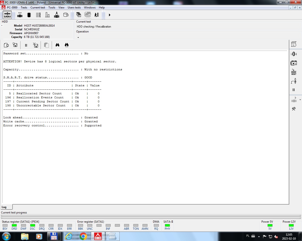

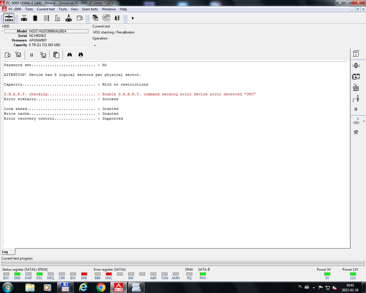

Also when running in Universal Utility there are differences:
To illustrate, i show the start of a healthy disk (donor) in Universal Utils:
Donor - Universal AT Utility message - immediately after turning on.jpg [ 209.05 KiB | Viewed 10660 times ]
And - for compare - this is, what it looks like when trying to start Universal Utility patient disc - after powering up and trying to start right away:
Patient - Universal AT Utility message - immediately after turning on.jpg [ 223.99 KiB | Viewed 10660 times ]

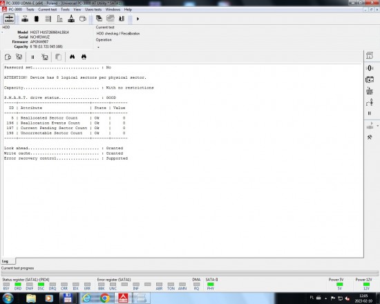

As a curiosity - i will mention the fact - that the "patient" disk after starting (for several dozen minutes - every few - several seconds) something "cracking"...
As if it was trying to read something ...
After this time (several tens of minutes) - these sounds is stop and when i try to enter the Universal Utils - shows messages with fewer errors:
Patient - Universal AT Utility message - 0.5 h after turning on.jpg [ 193.43 KiB | Viewed 10660 times ]

Theoretically I can read the ROM and extract the NVRAM... But will disabling the heads help me?
Will disabling the inoperative (defective) heads will load the translator and will confirm the damage of the heads - while confirming the efficiency of the translation modules ?
I need data from all surfaces (Long "heavy" AV files)....
Is there a tool to check, edit and correct the checksums in the ROM of this model?

There is no "NVRAM" in the traditional sense.
Here are my tools (HROMchkx and hgstfwcpx):
http://users.on.net/~fzabkar/FreeBasic_W32/Hitachi/
My "research":
https://www.hddoracle.com/viewtopic.php?f=21&t=2549

In atach: two rom's - patient and donor
rom's patient and donors .ZIP [1.08 MiB]
Downloaded 365 times
 Post subject: Re: Request for feedback (opinion) - for the newer HGST driv
PostPosted: February 10th, 2023, 16:13
Posts: 17341
I have extracted all the modules.
HUS726060ALE614.7z [486.78 KiB]
Downloaded 366 times
