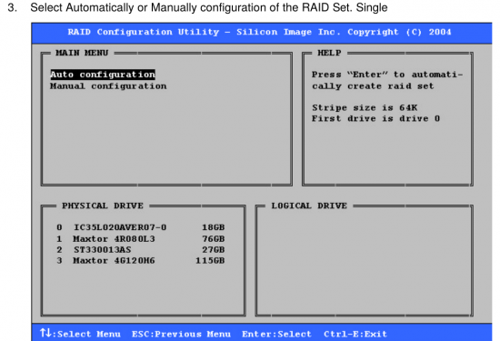

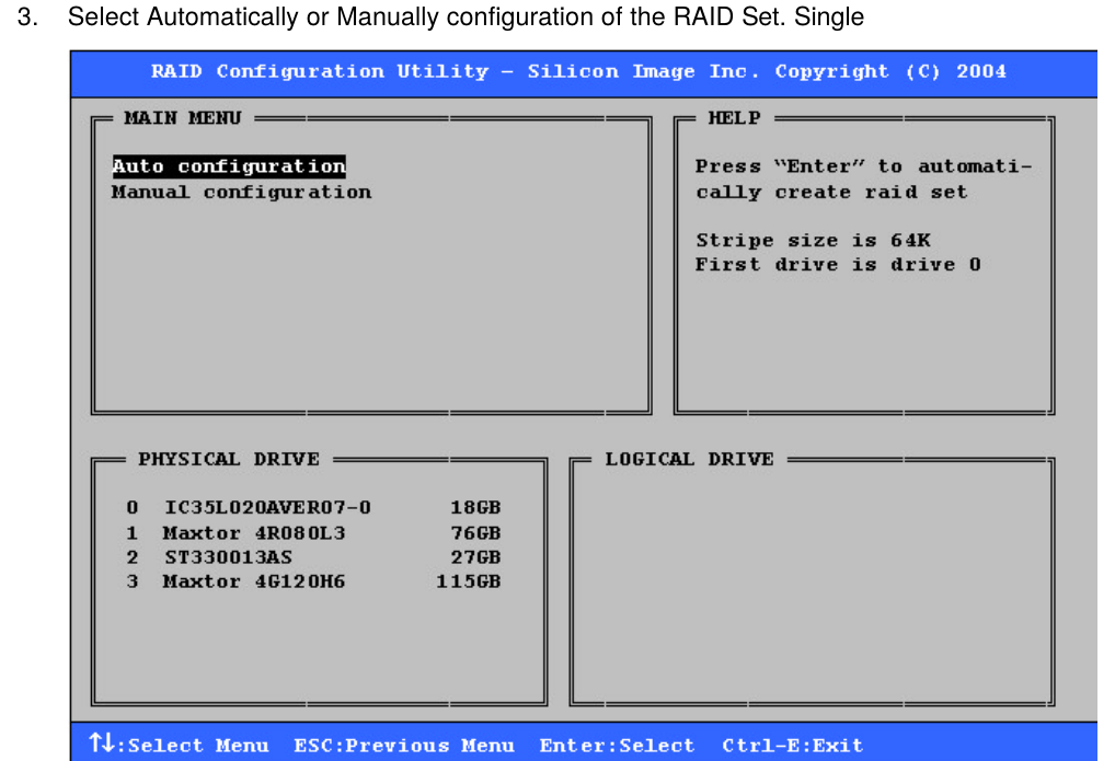

According to the Silicon Image-manual, the standard values for creating a RAID5 set is by using 64k blocks (see page 14 in attached pdf).

3. Based on the information in the manual (see attached file), is it possible to use that in DMDE to be able to recreate the set without the hardware?

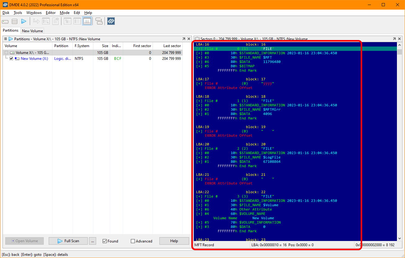

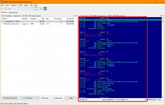

I meant ReclaiMe Free RAID Recovery, all it does is figure out RAID parameters and show you these (and export for a few file recovery tools). If it looks good you could even export the array in de-striped form to another drive (for free). So assume 3 x 500 GB drives RAID 5, IF the tool figures out RAID parameters correctly you can have it de-stripe to 1500 GB or larger drive. It unraid's it so to speak.
Yes, this:
Did you look at MFT blocks from the separate disks (select drive > Tools > Search for Special Sectors > MFT entry
Will get you this for example:
Usually the MFT may be fragmented but in large consecutive chunks. Assume 64KB stripe size, you should see MFT break after you scrolled down 64 entries for example. Since MFT entries are numbered it should even allow you to work out the disk order. A gap between first few entries and the rest is expected, but say you locate entry 100, from there on you'd expect a consecutive chunk of MFT entries.

I know these cards, they do fake-raid aka software raid in it's cheapest form. The 3114 and the 3112 had in early revisions some firmware bug, that triggered misleading SMART-errors on the disks (I had Samsungs at that time). I believe it should also be possible to import that raidset on Linux as dmraid with the default stripeset it shows (64K) and just connected to the mainboard with AHCI and without the card at all.
