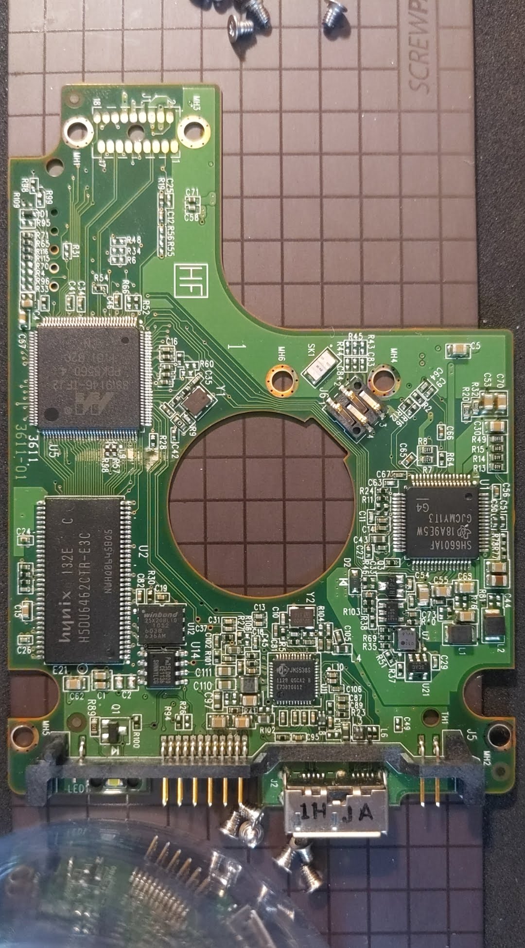

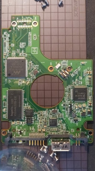

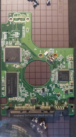

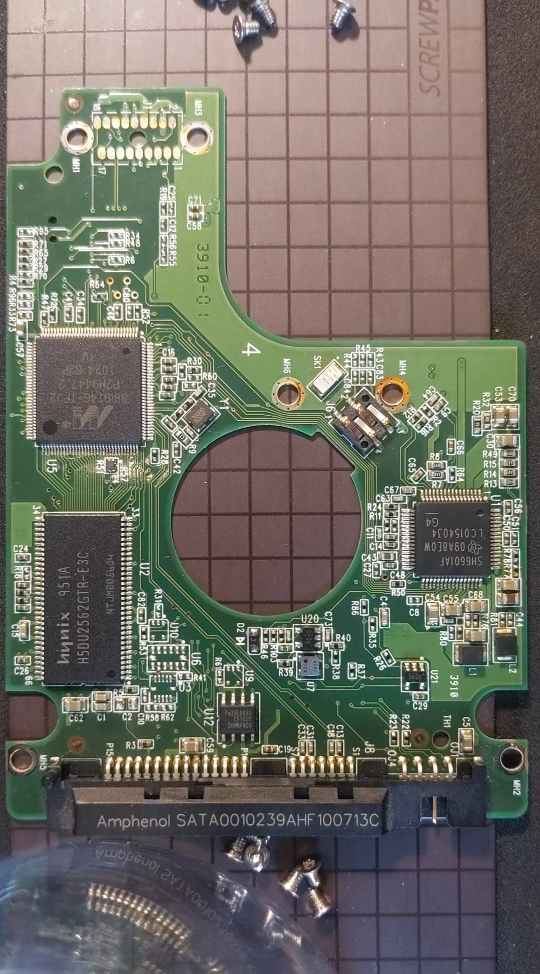

I have two boards (photos attached):
Model           |Interface| ROM                    | RAM (Hynix)             |
2060-771761-001 | USB     | Pm25LD020 (256K=2Mbit) | H5DU6462CTR-E3C (64MB)  | probably bad
2060-771692-005 | SATA    | Pm25LD040 (512K=4Mbit) | H5DU2562CTR-E3C (256MB) | good
I tried to just flash 256K ROM to 512K chip using CH341A programmer and AsProgrammer software, but HDD doesn't start. (then i flashed 512K ROM from a backup file)
So do I need a board with ROM of exactly the same size? Or, for example, it is possible to physically solder 256K ROM in place of 512K ROM.

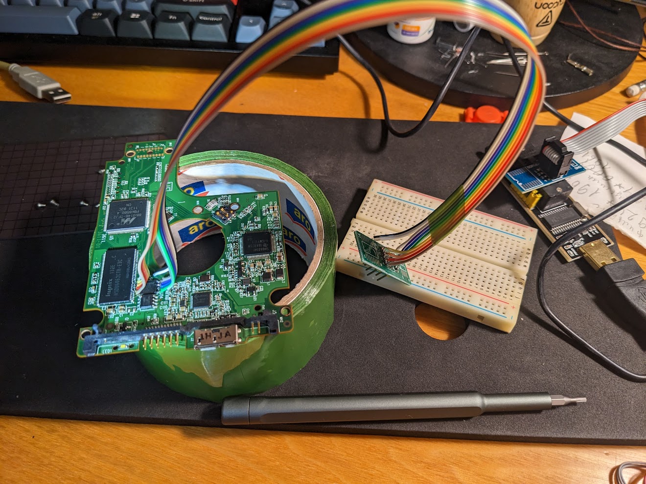

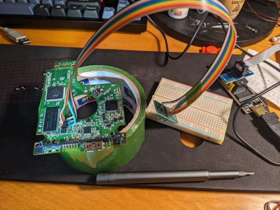

pepe wrote:
you can solder thin wires if you are afraid of damaging the chip by desoldering.
That was a good advice! Finally i was able to grab the firmware after hours of soldering. But if I write it to 512Kbit memory chip, HDD just clicks several times and stops. It doesn't even show its name in BIOS.
Of course I'm not sure if the drive is alive.
winbond_w25x20blic.zip [232.92 KiB]
Downloaded 460 times
 Post subject: Re: Compatible SATA PCB for USB PCB WD Passport 2060-771761-
PostPosted: June 15th, 2023, 13:41
Posts: 4840
:) i said THIN wires, which those are not... :)
anyway, glad it worked and did not damage the chip contacts.
can you try the pcb on a known good drive? It won't start but should not click at least.
