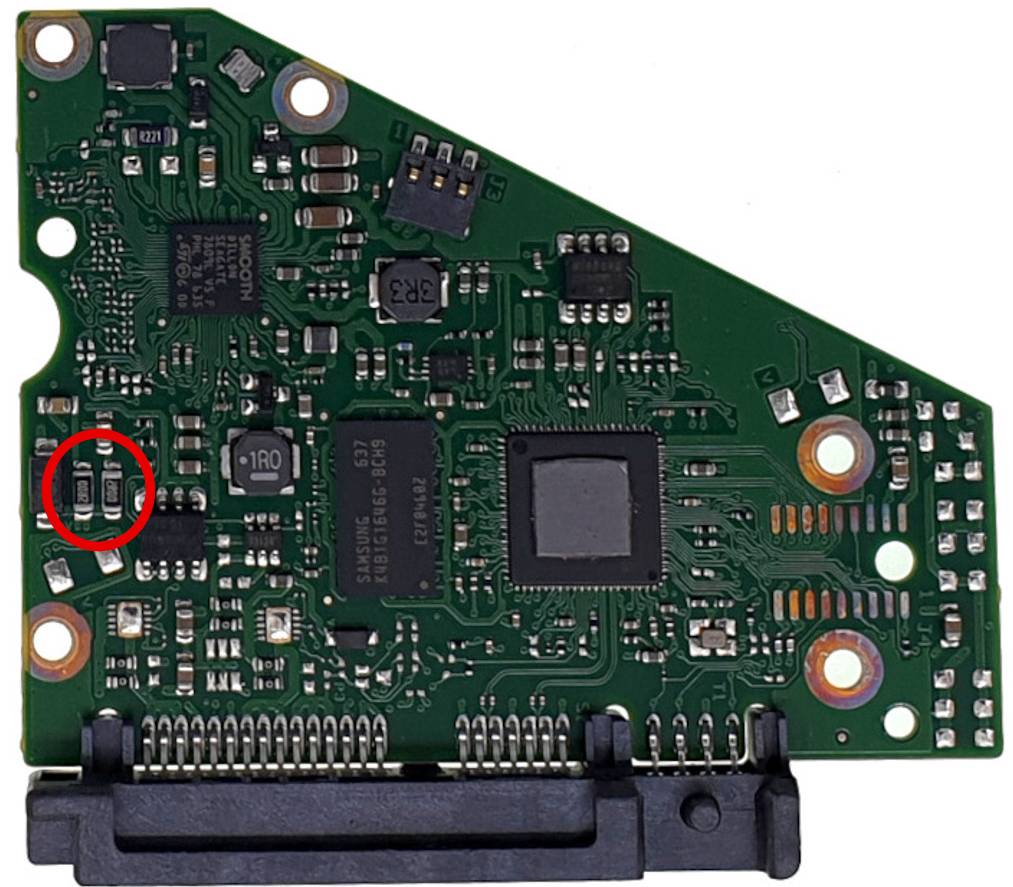

A few months ago my Seagate SRD00F2 5TB began very quietly clicking when connected to my computer. This clicking was much quieter than the header-click I've experienced with really old drives, either way "Oh god, 5TB of backups down the drain!", devastated.
A couple of weeks after that, I gave it another go but this time it didn't power up in any way. As far as I knew, it was completely dead, so I took it out of its case thinking the external PSU or some other external element (additional PCB) is burnt out. I connected it via a SATA/USB adapter to my computer, nothing, still dead. I kept the drive in the hopes that one day I'll have time to take another swing at it, so here I am!
I spent most of the last few days researching, and I found that a drive refusing to power up might have a faulty PCB. That's encouraging! So I found a matching 100721570 REV E PCB and ordered the replacement, which is still on en-route. As the BIOS chip will need to be swapped I'm still reading/watching everything I can, as I'm quite out of my depth!
I then read that it might just be a blown TVS diode caused from over-volting/using the wrong PSU or some such. Since I have a spare PCB on the way, I might as well see if there's anything I can do with this one...
When inspecting the PCB under my microscope, not only was the diode circled below shorting, but it was physically cracked. Going off guides, I removed it, cleaned and re-checked the pads and sure enough no more shorting. Great!
I connected it to my PC and my hopes went up when it began to spin! However, it makes this sound (uh oh, those 4 beeps don't sound normal), then powers off.
I have seen in other threads that damage might have spread to the 2x zero-ohm resistors circled below, but they're reading as shorting/0... which is what we expect, right?
I don't know what the two circled below are, but they're also reading as shorting. Again, I don't know if that's what I want??
TLDR; An external drive stopped working. Originally beeping very quietly, several weeks later refusing to power up. I removed a blown TVS diode and the drive it now spins to life, but won't stay powered. It makes this sound then powers down. Does anyone have a clue what could be wrong?

AlmostThere, by the sound it makes, unfortunately your drive have mechanical issues with one or more heads. This is not a DIY job if your intention is to recover important data. If data is important and you don't have any backup, take it to a data recovery professional.

Noo! That's so disappointing. I've looked into a couple of companies, and mechanical faults are very expensive to fix. :cry:
As I have a replacement PCB already on the way, I think I'll swap the BIOS chips as a little practise for when this inevitably happens in future, but won't hold out hope it'll get the drive anywhere.

+1, definitely bad heads, possibly accompanied by media damage.
I suggest you to call Sean at pcimage.co.uk, they're in Peterborough. A question never harmed anyone.

ISTM that you have bad heads, plus it's a Seagate.
It's cool you are doing your R&D but without equipment and propper tools you are out of luck.
Even for many of us with all the arsenal required, dealing with those drives is a pain.
