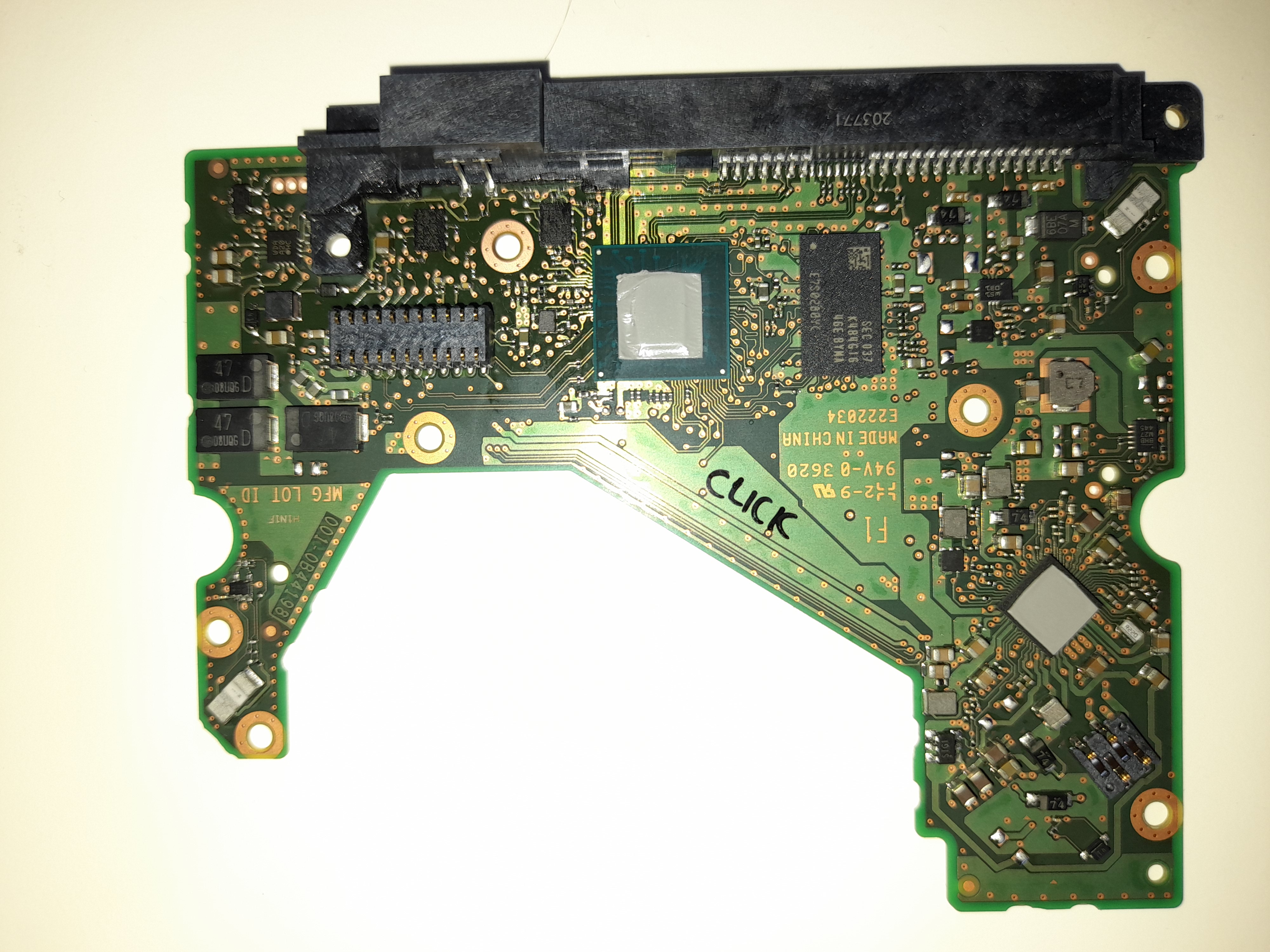

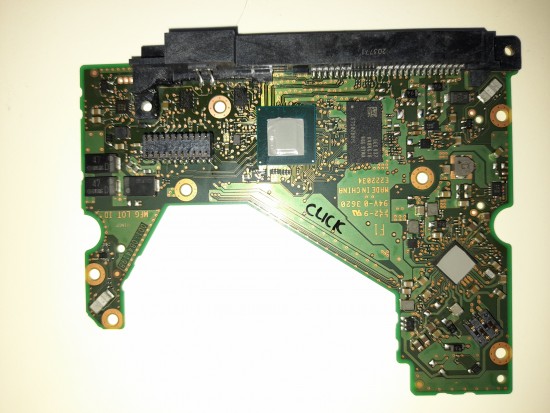

Ok here goes...

Fuses, Diode, and efuse - fzabkar cover similar here https://forum.hddguru.com/viewtopic.php?f=1&t=43291 and here https://forum.hddguru.com/viewtopic.php?f=1&t=42330

Well so far Vcore is missing 0.8v measured on my donor PCB so I swapped the Buck Converter chips from one PCB to the other and fault remains, all surrounding resistors measure good. And the clicking drive spins up like before and clicks.
I shall continue to compare voltages…

STEF512PUR, STMicroelectronics, Dual electronic fuse (eFuse) for 5V and 12V rails, marking W51, QFN10:
https://www.st.com/resource/en/datasheet/stef512pur.pdf

Show us the voltages you have measured. If the fuses are open, they can be bridged, if appropriate checks are made. I have helped many users repair boards such as yours, without needing parts.

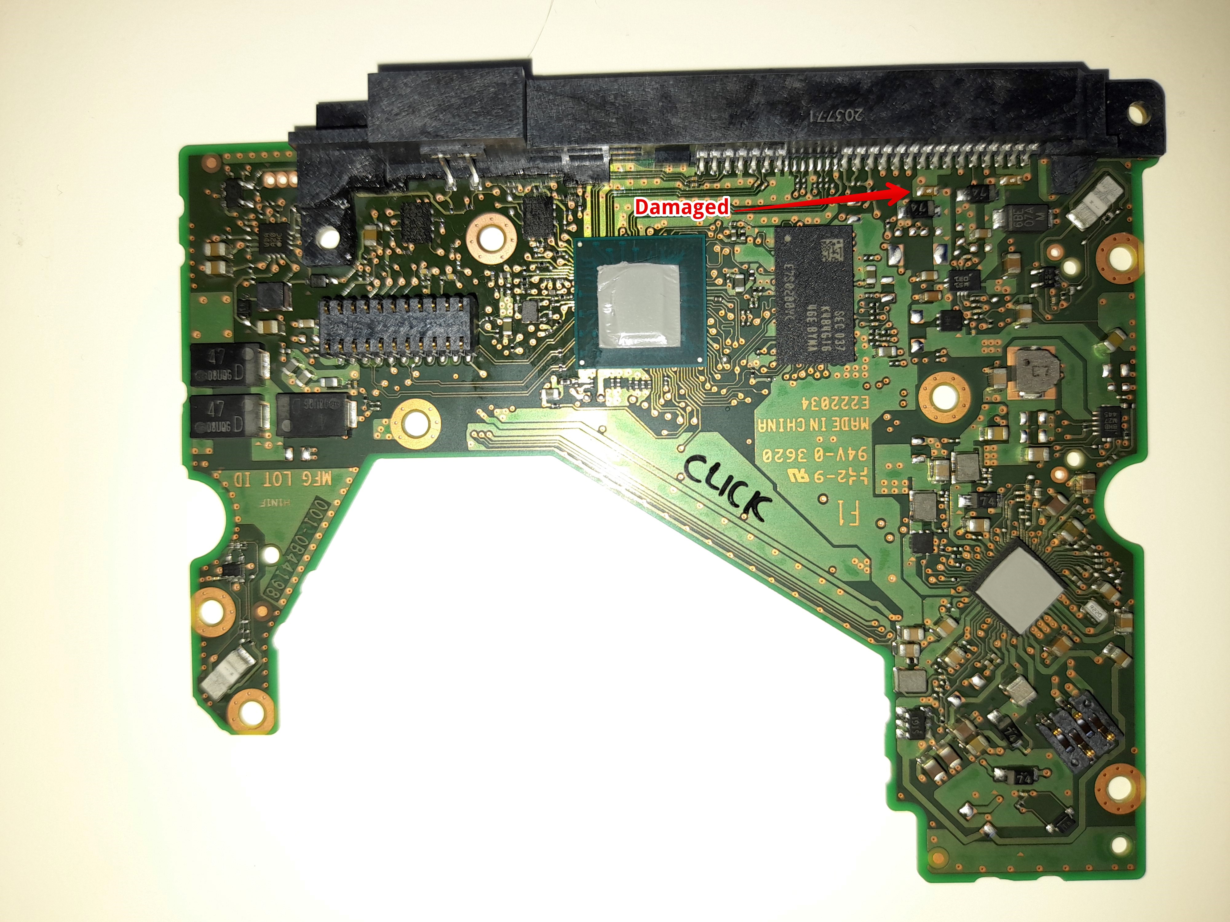

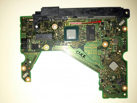

PostPosted: July 10th, 2023, 14:26
Brand new Western Digital 18TB WD180EDGZ-11B2DA0 shucked out of of a My Book external enclosure spins up fine without 3.3V pin isolation.
The damaged drive I received with electronics issue had component damage.
Component replacement worked without further issues in my case.
Note: I noticed that with similar or compatible model PCBs being finicky about ROM swaps.
Some would spin the drive, but throw UNCs on each block read.
Other PCB would not spin at all.
Very strange behavior...
Definitely recommend repair before jumping into swapping ROM. At this time, the PCBs are fairly difficult to find and expensive anyway.
