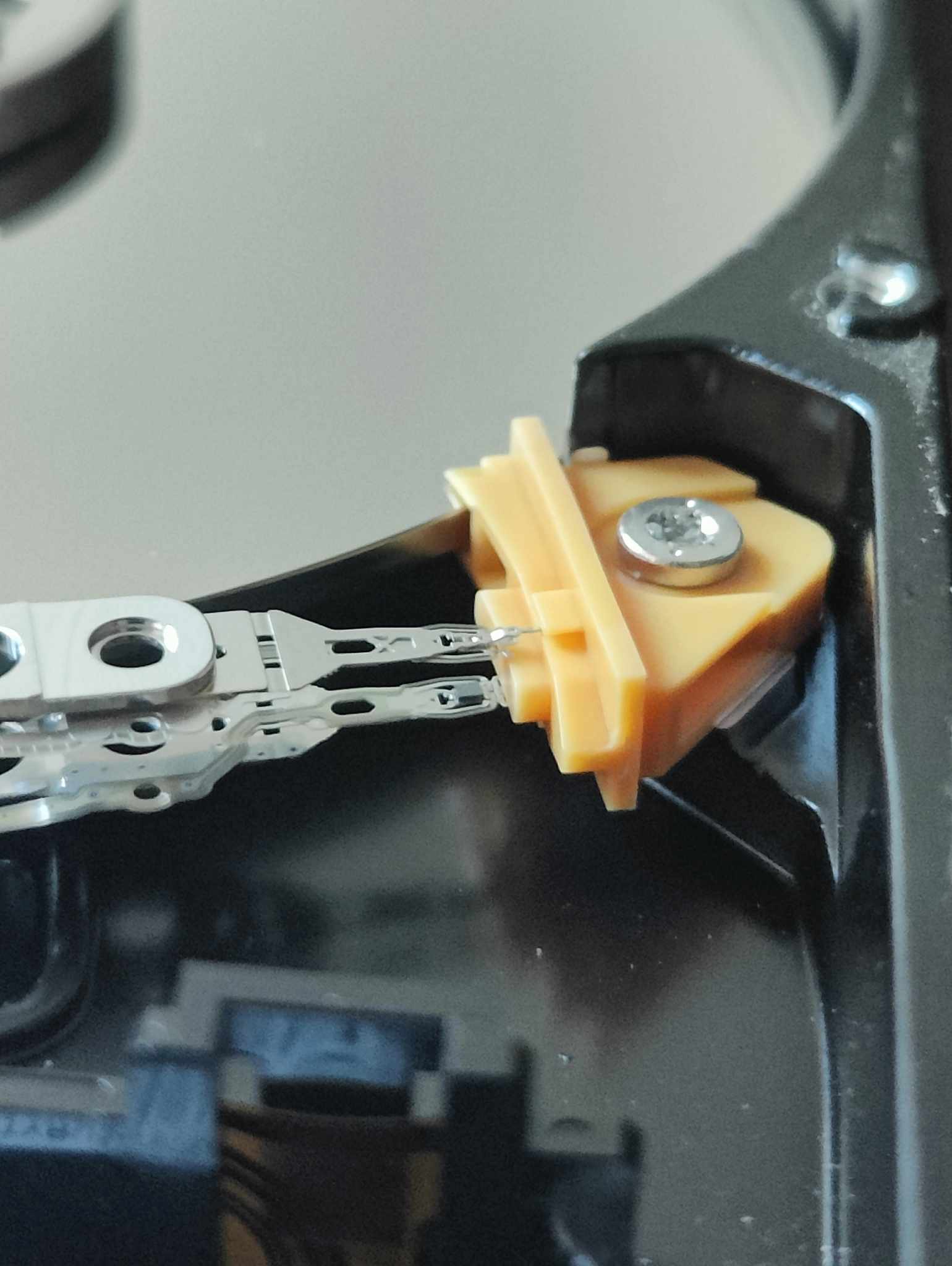

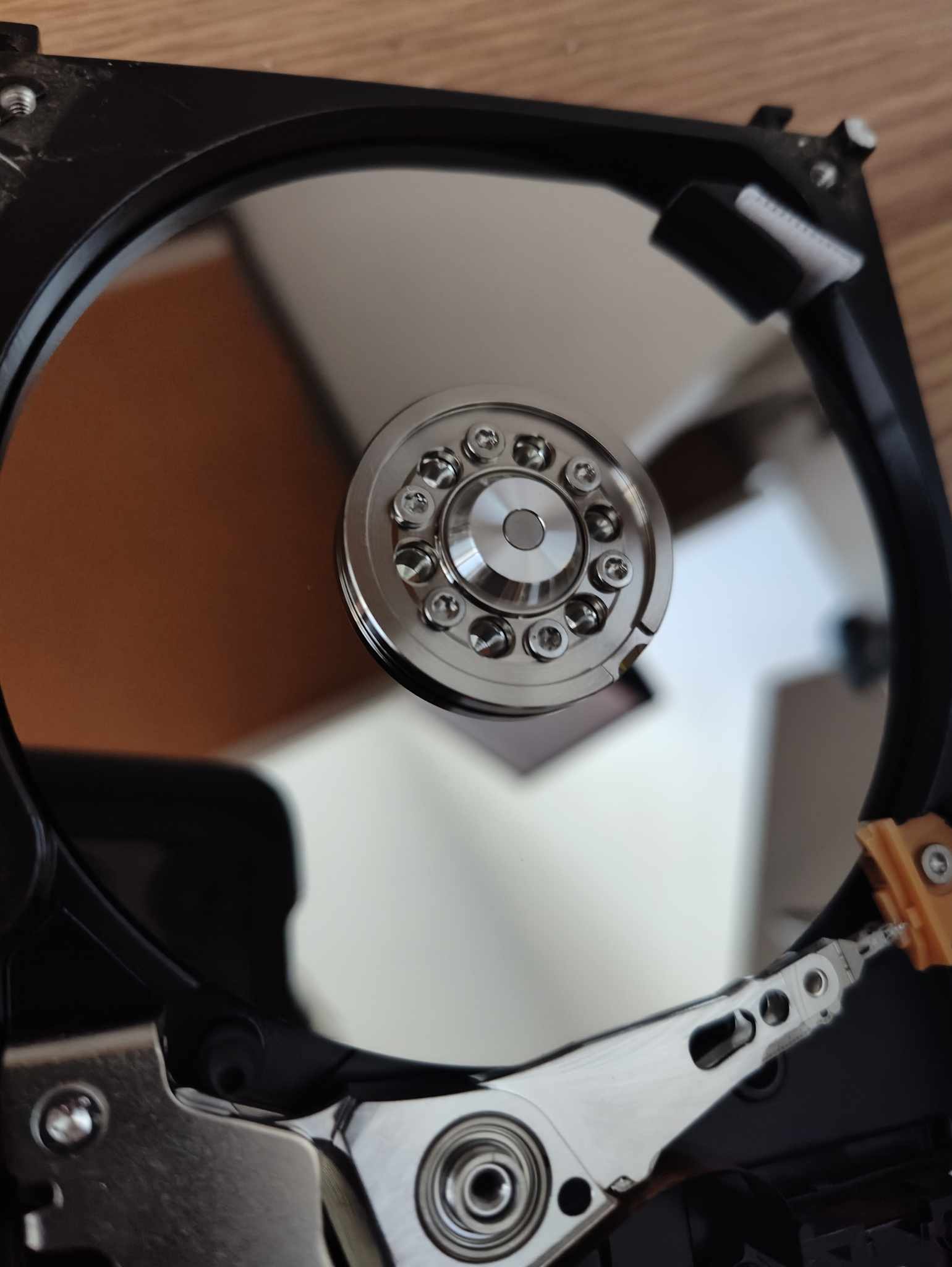

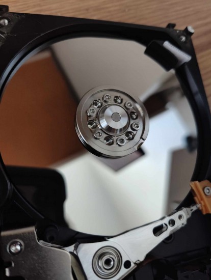

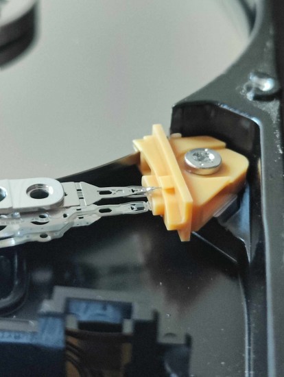

I wish to restore functionality on a faulty WD HDD that is unreadable and undetected at BIOS level.
Platters looks OK, heads have been changed by myself from an identical brand new drive, but the problem remains the same.
Some pictures included.
Open case HDD running video : https://streamable.com/5005md
Do you have any idea what I could try next to fix it?
Thank you very much.
File comment: platter
358333178_209535368417456_2906008161869044716_n.jpg [ 109.51 KiB | Viewed 2848 times ]
File comment: head

nux17, data is likely gone at this point (or at least severe media damage).
You cannot power on a drive without the lid and that noise.... so very bad.

Agreed, $200 non-refundable open drive fee + $700 in labor CAD. Very simple model to work with. Same noise most likely caused by bad heads (x2 - as in before and after swap). High pitched noise indicates heads are not floating; but touching / scratching the platter. So now bad heads and surface damage - not good :(

Likely the head swap has been done without the necessary know-how and proper equipment (clean bench, globes, surgeon cap, the proper tools).

I assume that you contaminated the platters by opening the hard drive without a clean bench.
In such a situation, I would strongly advice picking a data recovery lab that has expertise (or at least some experience) in platters decontamination. I believe that this remains a hand-crafted process, still quite experimental nowadays, with R&D from some labs.
You can expect a substantial higher cost than originally, because of the necessary decontamination which is not an easy task, and the possible serious media damage. Also expect the chances of a successful recovery being much lower than initially.
