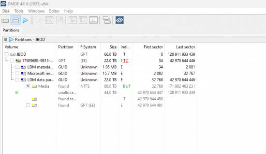

That being said, i feel that i am quite close to recovering what remains of the 4 disk span (1 drive failed). This was a Windows GPT Dynamic Span Volume across 4 disks on Seagate (broke my rule of never using seagate due to a really bad failure rate history) Ironwolf Pros. They're probably fine in a failure tolerant environment, but this idiot was thinking cheap at the time.
Using DMDE I see the following:

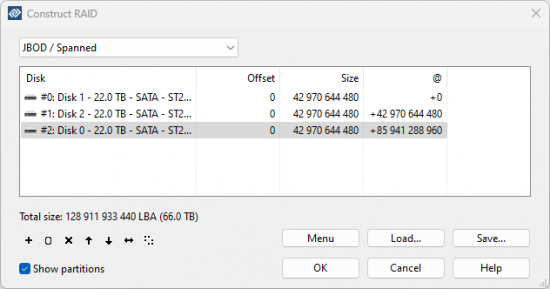

I do not know which order these go in, however i do know that Disk 1, which i have placed first, lets me see file directories of that first drive.

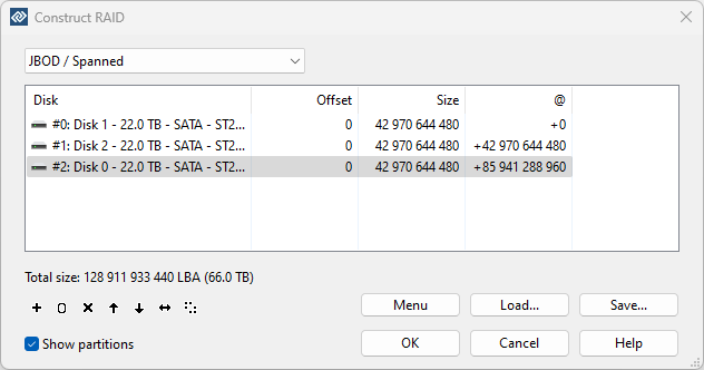

I also know that 1 drive is missing, so the order of the two in the middle or maybe end, i need help figuring out, or some help in general about how to recover what i can from this. I might have to use the null disk?

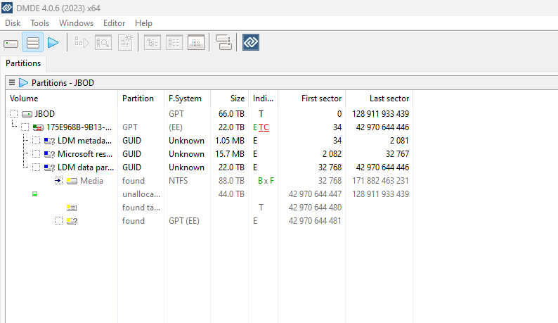

This is what i see when i click OK with that drive order.
I don't think it sees the rest of the files outside of the directories from that first drive. Is that a drive order issue? Do i need to do a full scan? The bad drive was sent off to get "recovered" via warranty and i think i'm just going to get flat "recovered" files back with no names or directories, but i'd like to recover most of what i can from this array.

AIUI, the $MFT is on the first drive. Therefore, if DMDE has correctly stitched together the members of the spanned volume, you should be able to recover all those files that exist on the first 3 drives. The only problem would be if the MFT is fragmented, and if one of these fragments exists on your missing drive.
As you say, the files on the last drive will probably be subject to a raw recovery. It would have been better if you had been able to stipulate that the drive be cloned.

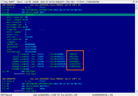

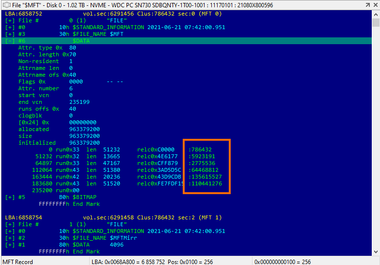

I remember doing this, as experiment, too long ago to remember exactly. I used null disk to make up for missing member which is required if missing disk is not last member.
1st 'member' contains MFT. If MFT is fragmented you should be able to work out if next fragment is on same physical drive or a next as MFT is self refencing. So decode runs for $MFT itself (DMDE does this for you, you do need to convert offset + (cluster * sect/clus) to LBA but ballpark figures are good enough to determine what drive fragment will be on). If fragment is on some next drive, you can also pinpoint that drive (use special sector search tool for example).
1st member contains NTFS boot record towards start of the drive.
4th member contains NTFS (backup) boot records towards end of drive. If you find no drive contains BBS, your 4th disk is missing.
So, if lost member is known, it should be possible to work out disk order since you have 1st, last and missing disk already.

Does the LDM Metadata partition (34 - 2081) contain all the information required to assemble the span? If so, then examining it with a hex editor would allow you to manually identify the order, wouldn't it?
I don't know yet. I started reading here, https://flatcap.github.io/linux-ntfs/ldm/index.html, but too tired now. Tools like Klennet Recovery can work with the database, so I assume, yes.
