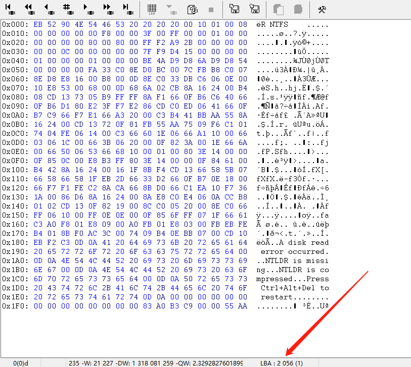

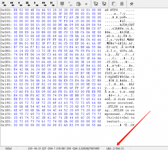

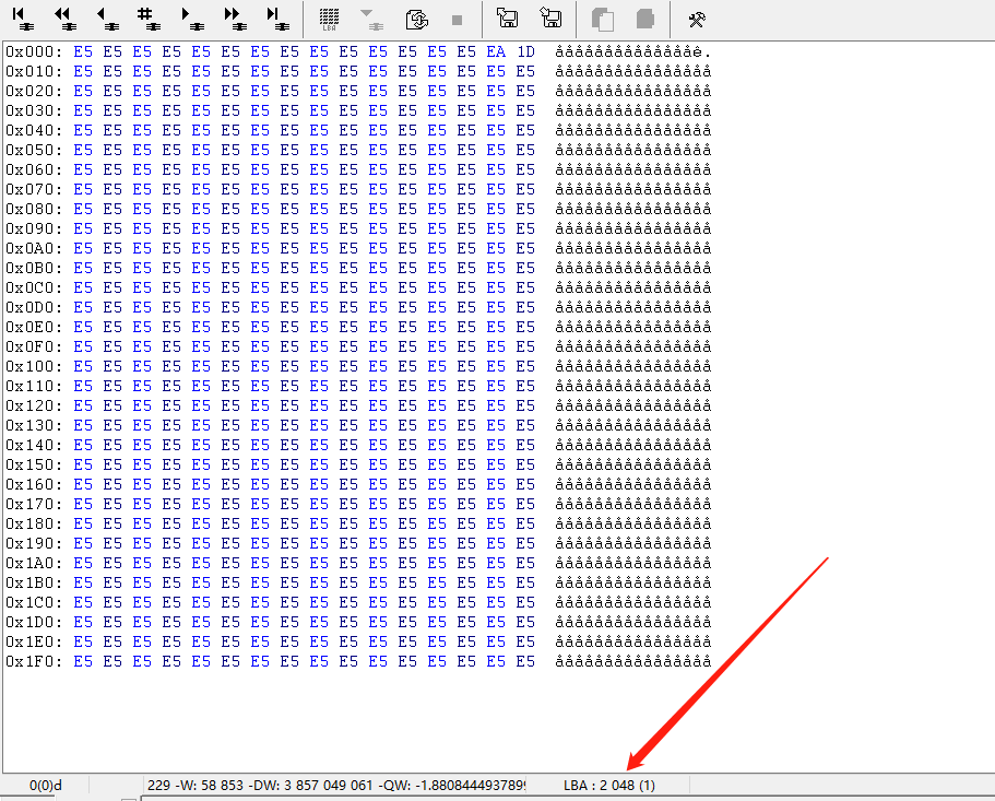

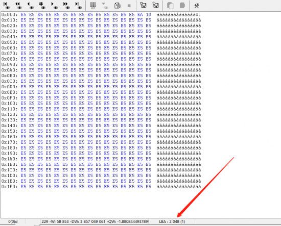

I received a WD hard drive called Diablo3S, which rotates normally. All firmware modules tested OK, and there was an offset in the user area data area.
The DBR is normal at 2048, now at 2056
and the data offset in the future is even worse. How can I fix it.
