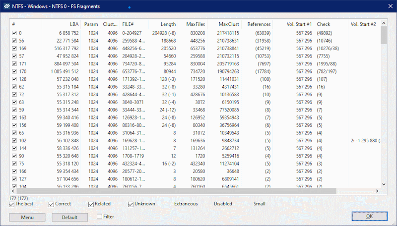

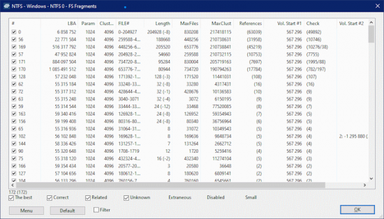

In/ex-clude MFT fragments in DMDE.
You can do using --/++ here:
If you'd pick ++ all the way, the MFT fragments in the .chk files should be included automatically but you could also do it manually:

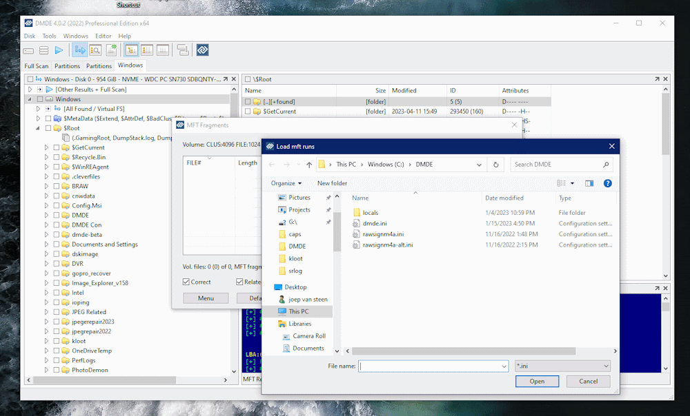

Or, load from file (your .chk file), then don't scan (just Open Volume), then click All Found / Virtual FS, advanced TAB, click Volume FS Fragments and open file dialog will pop up.
IMHO DMDE is perfect for this type of stuff. Hope it helps.
