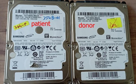

ST1000LM024 HN-M101MBB-2AR20002
Has 4 Head. H2 died. Imaged H0,1,3 with no bad sector.
I have tried 3 donor head. All says preamp error.
I have 10-15 donors in my hand different FW (10001,10002,10004,20002,20004)
I have checked all with replacing PCB to patient hdd. All donors saying preamp error in terminal.
Is anyone has experience like this. I need advice
I assume need some ROM modify now. I would be crazy.

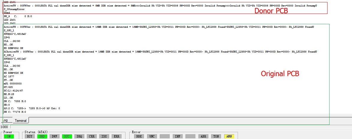

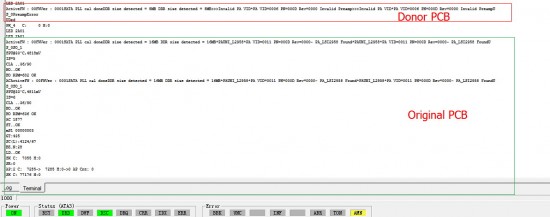

No. first donor head and patient PCB. (swapped head) There is preamp error
After then, tried donor PCB , patient head. again and again preamp error
Also tried patient PCB , donor head. same. Preamp error
Tried hot swap. cannot access SA
I have tried same FW 2 donors first. 2AR20002
After then tried all another versions . But All of them gave preamp errror
This is 2AR20002 Donor PCB and original PCB terminal logs

I think you need to find a donor with an L2598 preamp.
FWIW, I notice that the patient PCB has a 16MB SDRAM whereas the donor's is 8MB.
I also notice that some PCBs have a TLS2605 motor controller while others have a TLS2602.
https://sep.turbifycdn.com/ay/yhst-14437584971410/91404141-9.gif (100720903)
https://sep.turbifycdn.com/ay/yhst-14437584971410/st1000lm024-hn-m101mbb-av1-m8-rev-06-e1733-g141-a6xjs-2ar20002-2-5-sata-samsung-pcb-fw-9.gif (BF41-00354B)
https://sep.turbifycdn.com/ay/yhst-14437584971410/91504255-3.gif (BF41-00354A)

Just read preamp version in terminal after power up your donors. That's all that's needed to find a matching one.

how understand preamp version on terminal. Is PAUNI_L2958

You have it in the first line after power up.

There is nothing hard to find a donor in Samsung. You plug the drive, open utility, power up and you have preamp version in the first lines: 2958 or 5565 or 2957. 5565 and 2958 are cross compatible.
Or just open the drive. Heads with different preamp are build in a different way.

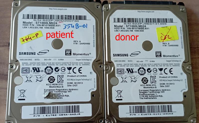

The preliminary donor selection can be made on the basis of a small label at the bottom
It should be the same central part of the P/N designation
Mikippp
 Post subject: Re: ST1000LM024 2AR20002 Matched Donors but All Preamp Erro
PostPosted: August 15th, 2023, 13:56
Posts: 17230
Mikippp
That's interesting. I notice that the ST1000LM024 model has 3 versions of this code -- G94A, G941 and G141. I believe that the the third digit is the number of preamp channels (1 channel per head). In this case there are 4 channels.
The 640GB (3 heads) and 750GB (3 heads) models also have a "4" in this position.
The 250GB (1 head) and 500GB (2 heads) models have a "2" in this position.
The ST2000LM003 (6 heads) and ST1500LM006 (5 heads) have a "6" in this position.
Perhaps the OP could compile a list of these codes together with the preamp IDs in terminal. I suspect that one of the characters in the code (the 2nd character?) could reflect the manufacturer of the preamp while another (the 4th character?) might identify the actual device.
