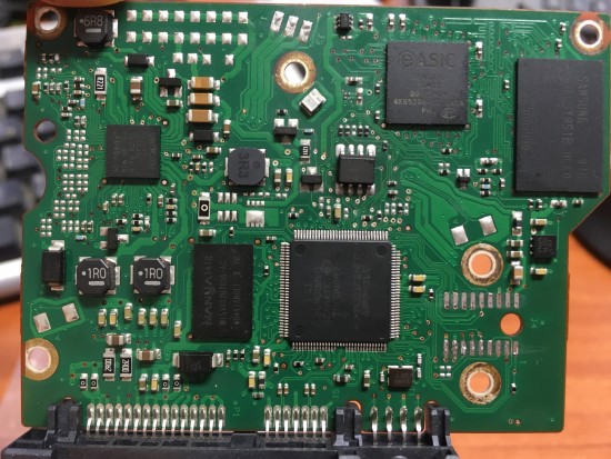

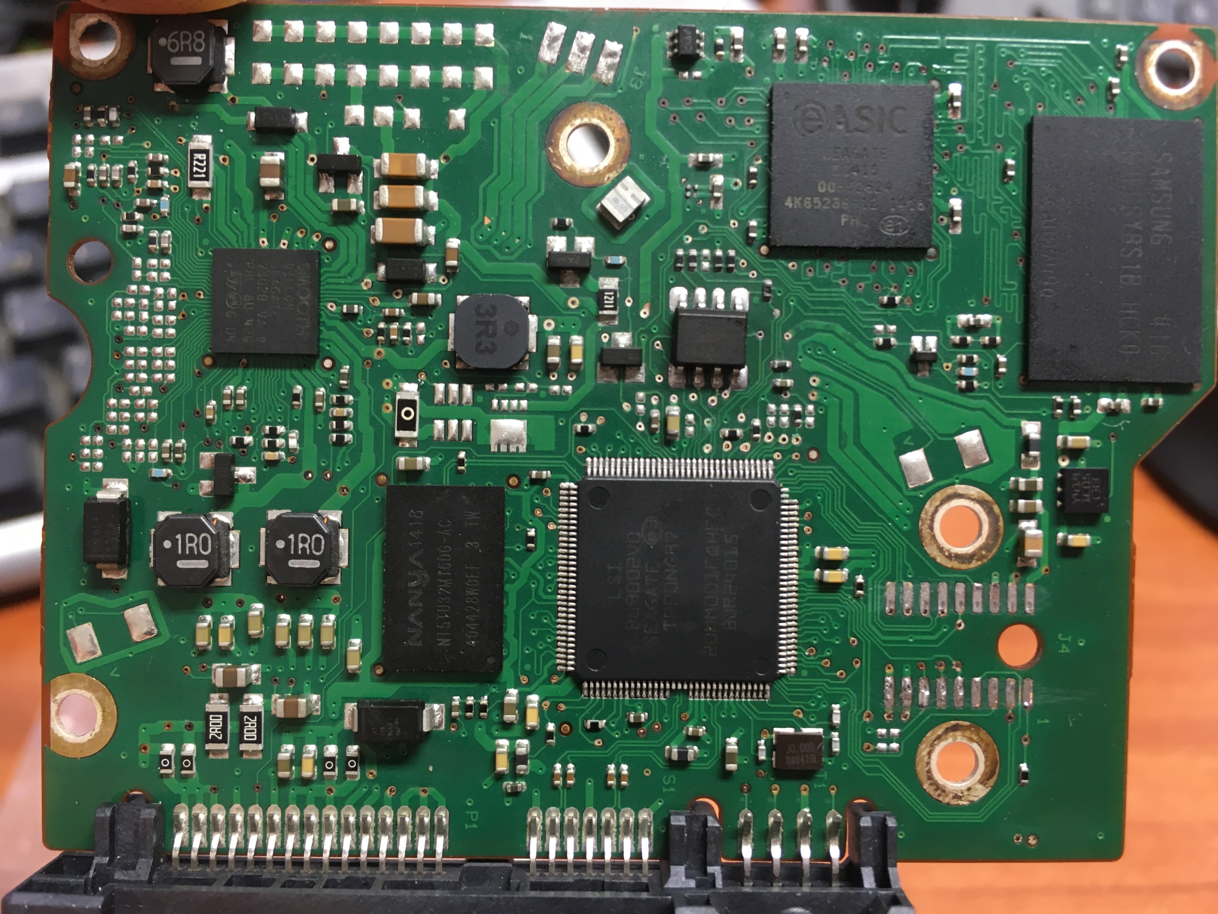

I will try all of the above this weekend and I will let you know. I found the chip. I am sending also a photo of the pcb.
Also i have replaced the fw chip with a new one because the original one was physically damaged.
The terminal does not respond to ctrl z or anything else to do anything so I copied the data from the chip using a usb eprom programmer.
is that ok with the programmer or do i have to use the F3 console?
can i do all the the changes to my file with a hex editor and write it back to the chip?
many thanks to all of you!!
A.

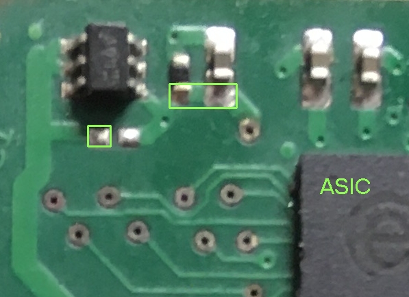

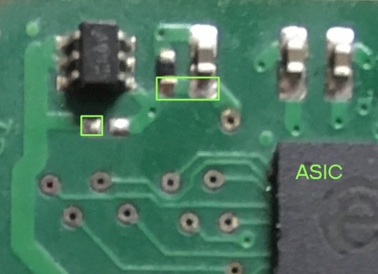

 Post subject: Re: ST2000DX001 2TB with FW CC43 does not spin
PostPosted: August 3rd, 2023, 13:12
Posts: 17342
Measure the voltages at the two test points.
