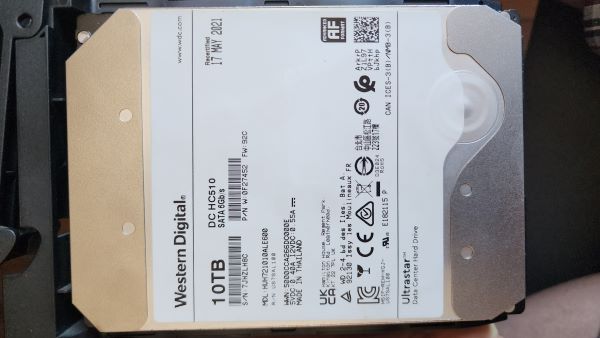

This is my first post here. I'm no DR expert, just an enthusiast seeking for help, so please forgive me if I lag to catch up on some basic concepts.
I had a RAID0 array on a ASUSTOR NAS consisting of two DC HC510 10Tb units. SMART scans and disk checks were ran weekly and never showed up any errors until I was greeted with this error:
[Disk Doctor] S.M.A.R.T full scanning of Disk 4 result: test completed but a read element failed.
8 minutes after the drive was unmounted and logs showed the following:
[17493.852514] ata4: link is slow to respond, please be patient (ready=0)
[17517.888507] ata4: softreset failed (device not ready)
[17517.893598] ata4: limiting SATA link speed to 3.0 Gbps
[17517.898770] ata4: hard resetting link
[17522.936552] Asustor_Netlink fail to send message
[17522.941208] Asustor_Netlink fail to send err log
[17523.108509] ata4: softreset failed (device not ready)
[17523.113602] ata4: reset failed, giving up
[17523.117649] ata4: EH complete
I shut down the NAS, put it on my work bench to check for dust on the SATA connectors and do other inspections. I used some canned air and tried connecting both HDDs to my 2 bay dock that was connected to my Windows machine and see what happened.
The failed HD was making a very low clicking noise every time it tried to start spinning. Afraid of doing any more damage I removed it from the dock.
In a last resort and last grasp of hope I put back both HDDs to the NAS, turned it on again, no strange noises this time.
The drive is detected by the NAS correctly (model, SN, capacity), but reported CRC error and I couldn't access any SMART report.
NAS sent this warning:
AiMaster
ERROR: [Disk] There is a device error on
sector 19532873720 of the slot 4 disk!
AiMaster 18:42
AiMaster
sector 0 of the slot 4 disk!
Errors on first and last sectors of the disk. And logs show the following:

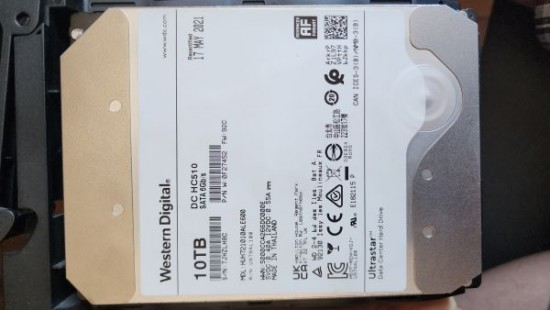

These are helium drives which are extremely hard to work with even for a pro.
I have never seen a recertified helium drive, can you post a picture of the label?
It's not a PCB issue by the way.
If you download a hex editor like https://mh-nexus.de/en/hxd can you see any sectors?
If not then a professional data recovery company is your only option.
Oh man, I was really hoping the PCB fix was viable. :(
This is the label. It also has a recertified engraving on the sides of the casing.

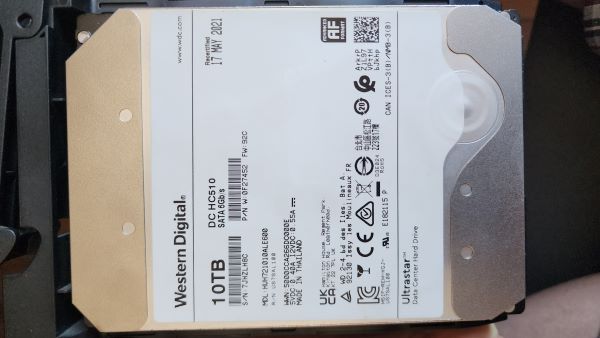

Unfortunately not, this is what trying to hex dump the drive returns:
xxd: /dev/sdd: Input/output error
dmesg shows, besides what was described before, this new info:
[758898.972396] Buffer I/O error on dev sdd, logical block 2441609215, async page read
[758900.075929] Buffer I/O error on dev sdd, logical block 0, async page read
This is the label, it also has the markings "recertified" on the sides of the case
Am I completely out of luck?
