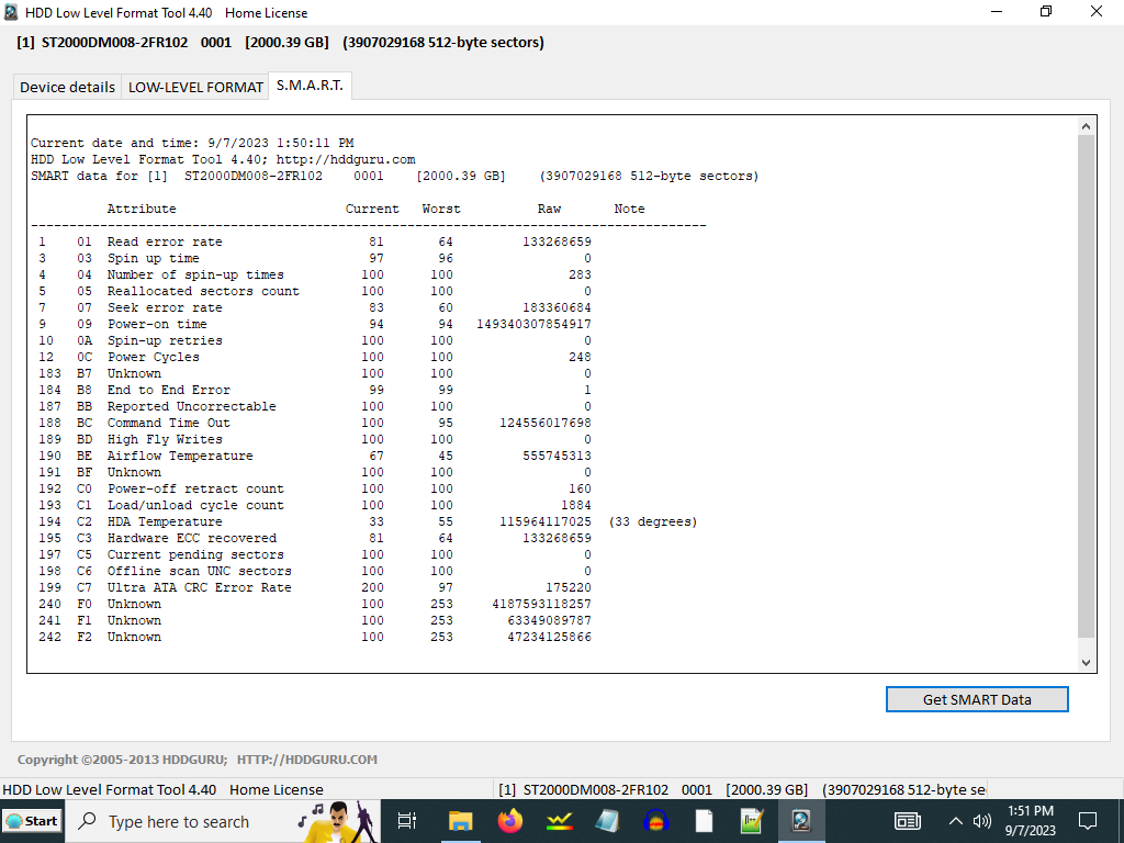

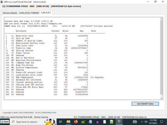

It eventually finished.
I haven't run diskpart to see if all that rewriting changed back the uniquid or something. Why is such a procedure given anywhere if it crashes the HD regardless of the uiniquid?
--> Attached is the Smart report I got off of Low Level Format option from the format tool.
(paid version :) )
I screwed up by hot plugging the HD with all this changing over so prob'ly needs another wipe.
On the previous clone job Norton Ghost 11.50 (I think) stopped during the run giving some 'unknown problem encountered' response. IOW everything looked ok for the clone job and then Norton hung up.
I'm short HD's with the bad cluster found on another HD discussed in my previous question.
I can't really re-invest my whole drive stock with SSDs on the PCs in my home ethernet setup. That's six minimum.
Thanks for any advice.

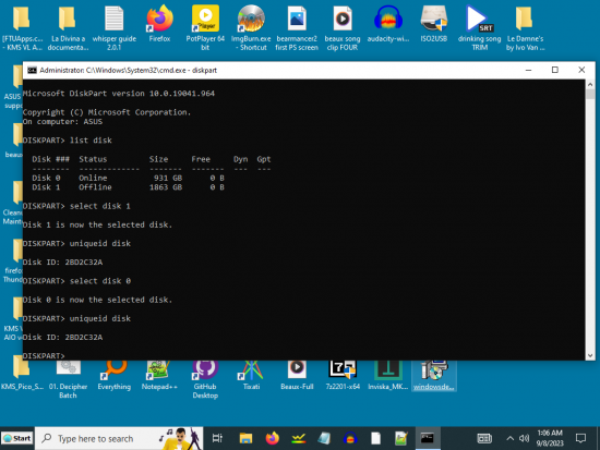

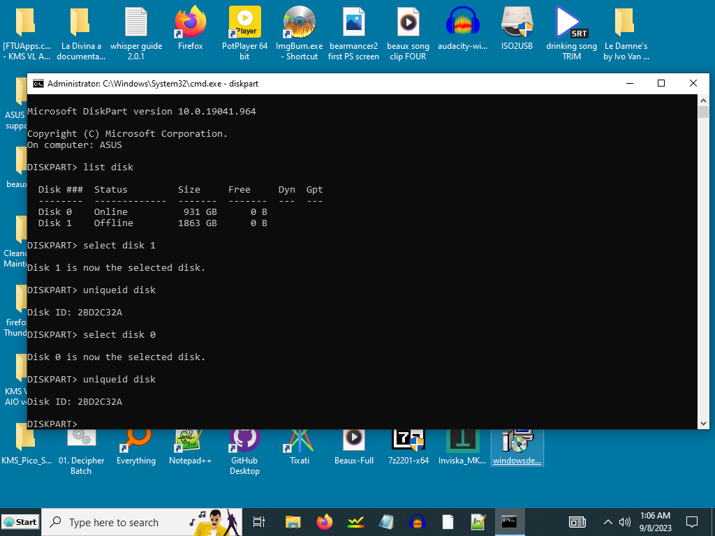

Just a followup for this perplexing problem.
The screen shot shows the diskpart statistics for ther Source and Target drive.
I had changed the last letter to "B" in the uniqueid procedure seen elsewhere to avoid the collision. After the long run of check disk, the drive id was changed back. Where would chkdsk
even find such a thing?
The result is that in admin tools the target drive once again shows "offline"
What is doubly odd about this is the source drive in this case was not a Seagate but a West. Digital. (I use the clone function quite a bit.)
