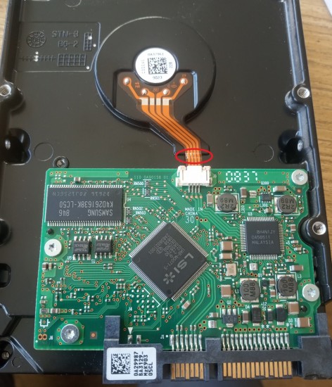

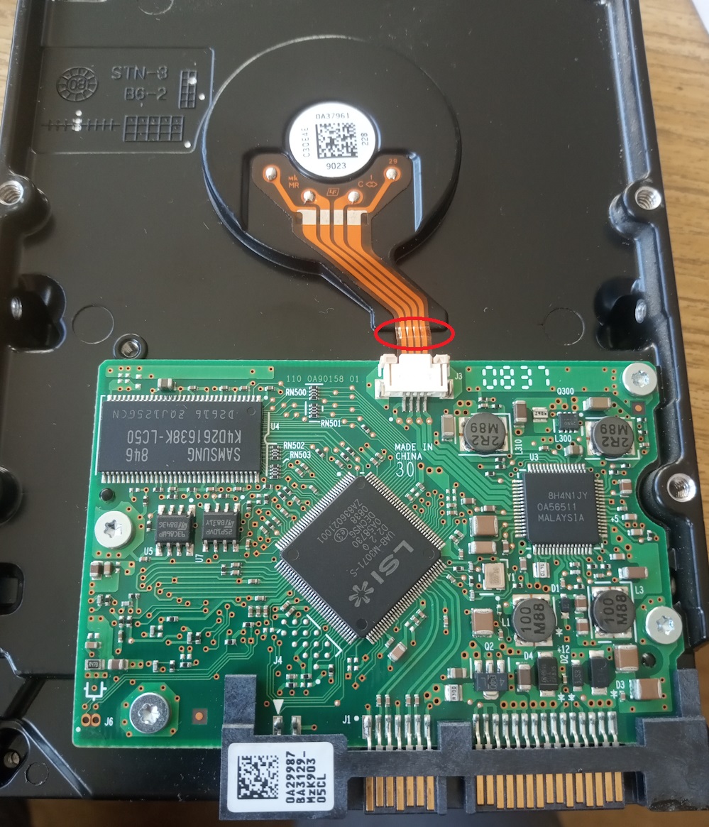

 Post subject: Re: HDT721010SLA360 - still a problem
PostPosted: November 28th, 2023, 13:16
Joined: September 16th, 2022, 9:31
Posts: 100
Location: World
After investigation of your case the problem would be connection between motor and PCB and you said it was in usb case but the drive was not design to be in usb case. Find any electrical engineer to change that cable from donor and pray. Or platter swap charges $3000, ROM Regeneration $4000.

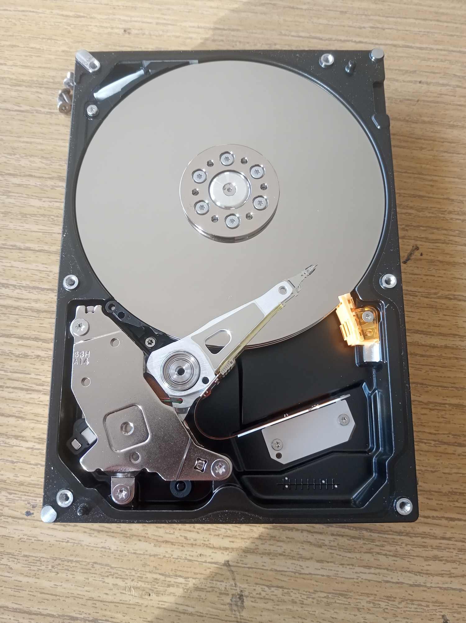

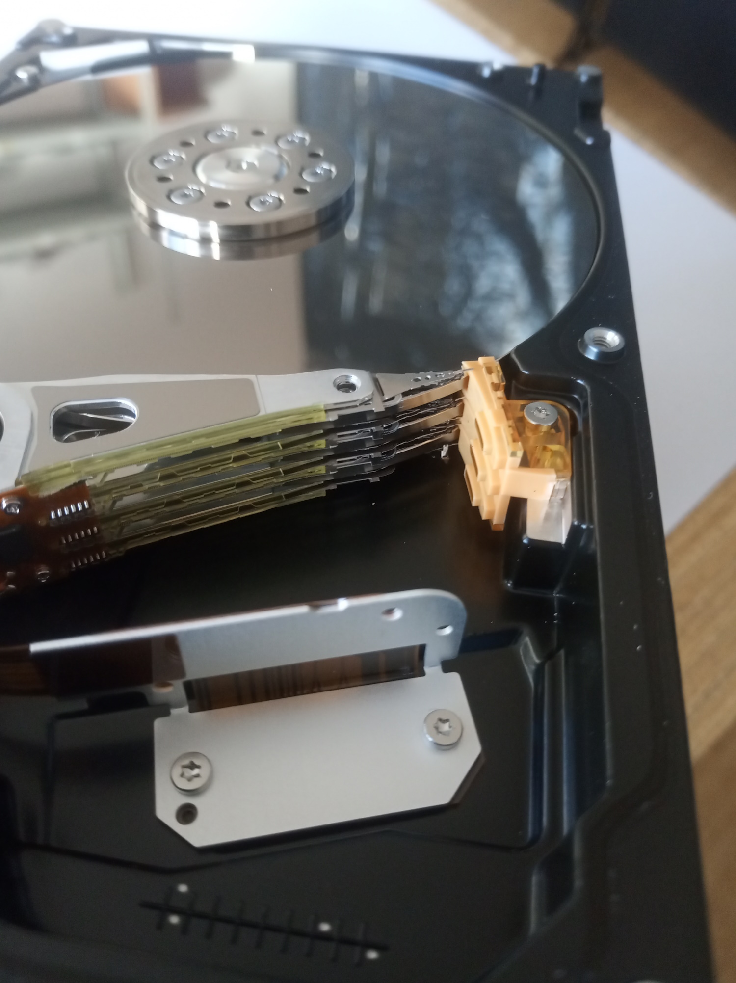

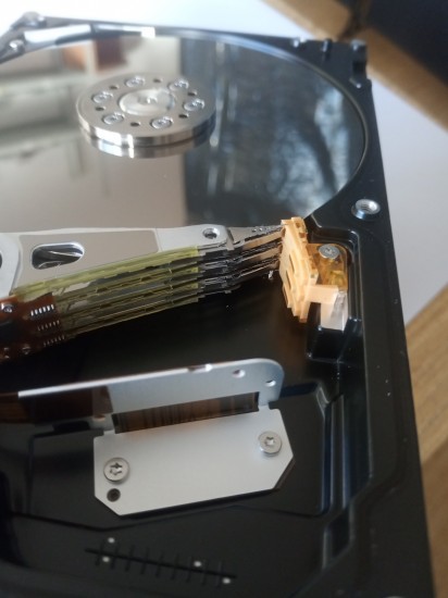

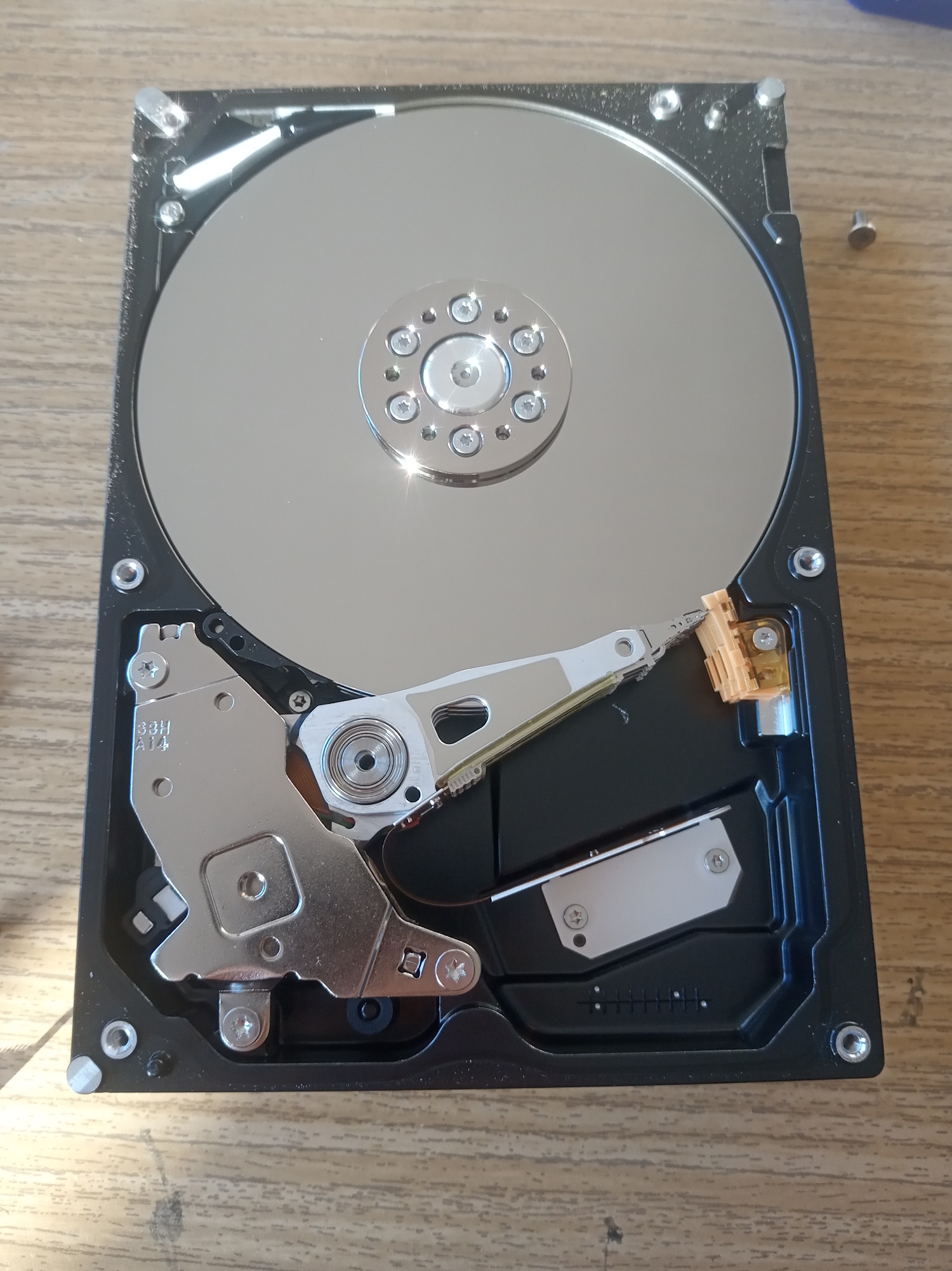

Thank you all for your replies, especially fzabkar user for the case explanation to others.

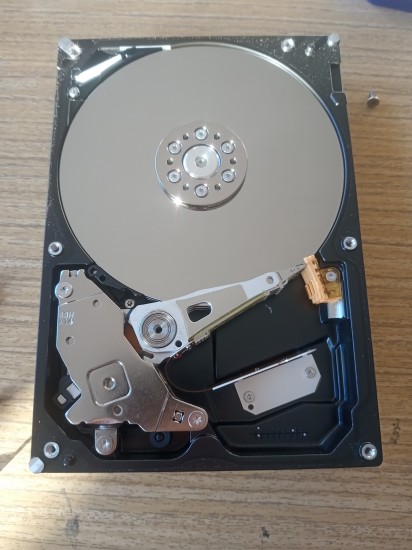

I opened the drive and found out the head was not park properly.
So I put the head to proper parking and motor started spinning.

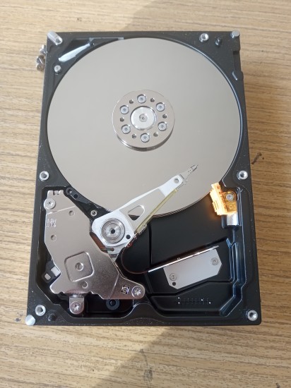

UNfortunately, after a second or two the drive started clicking, so I opened the drive again and found the head was on a platter this time.
I examined the head and found out that it had a minor damage.
So I hope exchanging heads would solve the problem.
Questions: Do you know about a good tutorial how to change head of hard drive disk?
When changing the head, must I also used PCB from that donor hard disk, including the EEPROMs?
