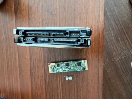

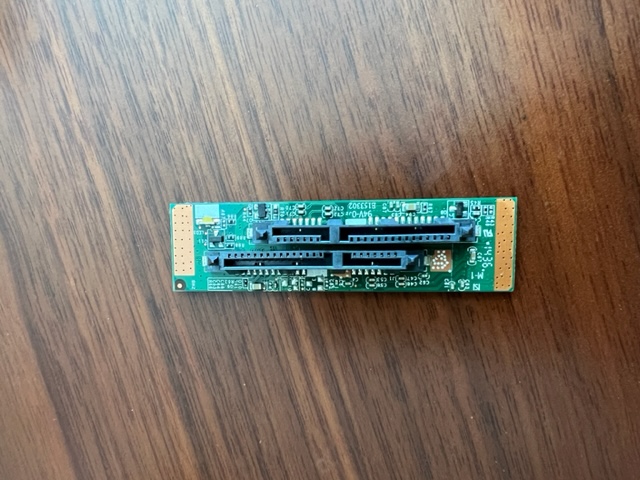

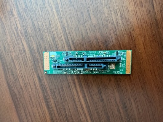

I have old Seagate 4tb portable HDD with data and the connector broke. Internally it's two samsung 2tb hardisks combined into one using circuit/enclosure (See pics below). When I connect the drives individually, it says I need to format the drive. Where can I get this circuit/connector/enclosure so they can read as a single drive and I can recover the data?

Connect them both to your computer at the same time and run r-studio and see what it makes of them.

The drive are setup in raid 0 . You need access to both at the same time to recover data. You can either do that with another identical bridge or in software.
Your options
1. Fix the USB connector
2. Buy a replacement identical bridge. (ebay)
3. Connect both to a machine at once. (buy another usb - sata cable or 2 port dock)
4. Make images of both of the drives onto 1 bigger drive and connect that to your machine.
5. Image 1 drive and connect the other via sata.
After all of that you will then need to copy the files onto something else - raid 0 is a terrible idea for data storage.
Option 3 is by far the cheapest.

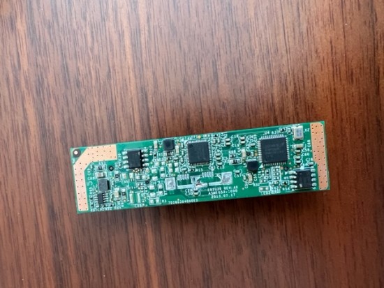

The RAID chip appears to be an ASM1090R which is probably similar to an ASM1092R.
https://www.asmedia.com.tw/product/218YQ47sX2hYeySE/1DAyq49Xz0uRDjj6
ASM1092R is Serial ATA RAID port multiplier controller, supporting one host ports and two devices ports, enabling Serial ATA PHY up to 6Gbps high speed interface, following Serial ATA Revision 3.0 Specification. It is used for SATA port expansion and performance aggregation.
The USB-SATA bridge is an Asmedia ASM1053:
