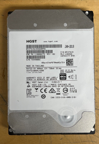

Got this 8TB HGST park well detection Ok, when get SMART and Scan abort error MRT and Sediv not supporting any other way to diagnose?

Your drive is identifying itself from the ROM. Dump the ROM and use my ROM parsing tool to see for yourself.

Normal behavior for those drives with firmware-failures. As fzabkar said, those drives get its ID and capacity from the ROM.
No DR-Solution can access or repair those drives, yet.

Yes it is minor Plist, Glist or Translator problem we get fix in Seagate and WD within 10 second.
But no any Tool supporting the HDD.

I can work with SA on these.
