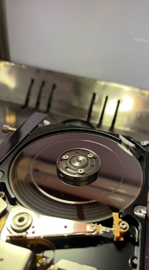

Hi tô all! :mrgreen:
Please opinion!
Please comment if it is still possible to recover data from this disk?

If bottom side looks the same - NO.

not absolutely hopeless, but data is probably corrupt even on the less damaged areas, so after a lot of efforts we still might end up with very few usable data.
