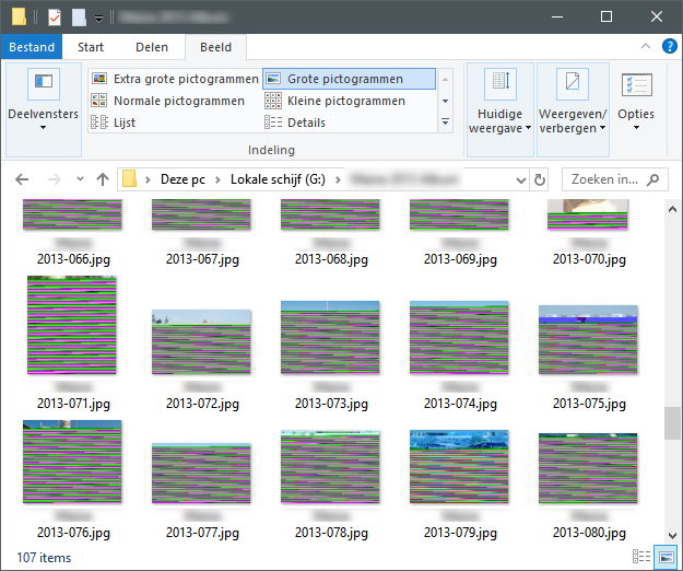

sonicmario wrote:
I read many varies years retention flash: 5 years or 10 years or 20 years, HDD?
Read more. Read about actual real world experiences.
Ask data recovery specialists and how they almost literally have to fight to read data from NAND flash chips.
These files are from a USB flash drive after it has been in a drawer for 2 years, 'safely' put away for storage:
Even if we assume that SSDs arguably use better NAND chips than USB flash drives or SD Cards, if left unpowered basically all NAND suffers from 'data bleed'. Modern NAND chips have even smaller margins than MLC, TLC NAND.
