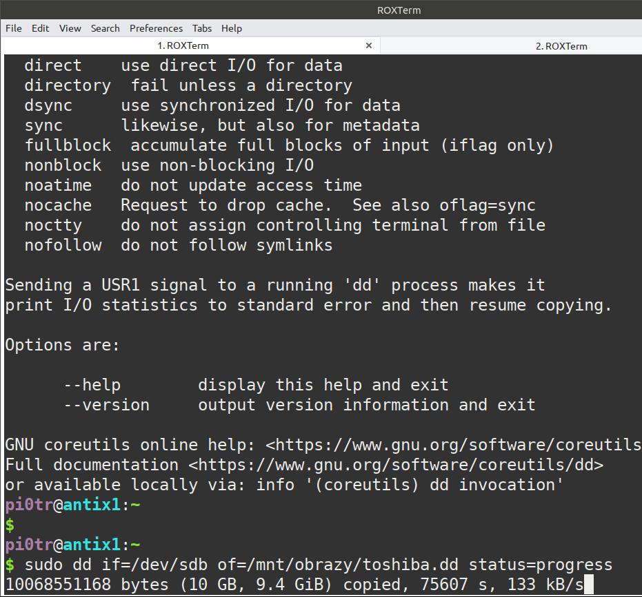

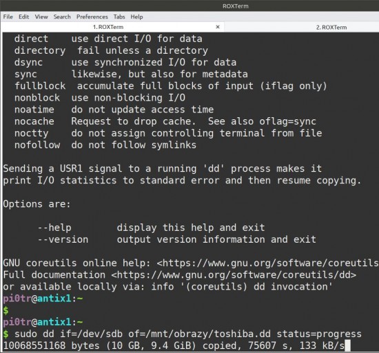

Hi i have Toshiba P300 - HDWD110
I need to create a binary copy, jednak odczyt danych z dysku jest na poziomie 133kb/s
smartctl --all

zdaje sobie sprawe ze dysk jest w nie najlepszej kondycji, ale moze jednak mozna cos z tym zrobic ?

Your drive has bad sectors!
Slow reading very likely is due to bad sector remap process (firmware function), that interferes with cloning process.
You should turn off remapping via terminal by using serial RS232 adaptor ("SP" command).

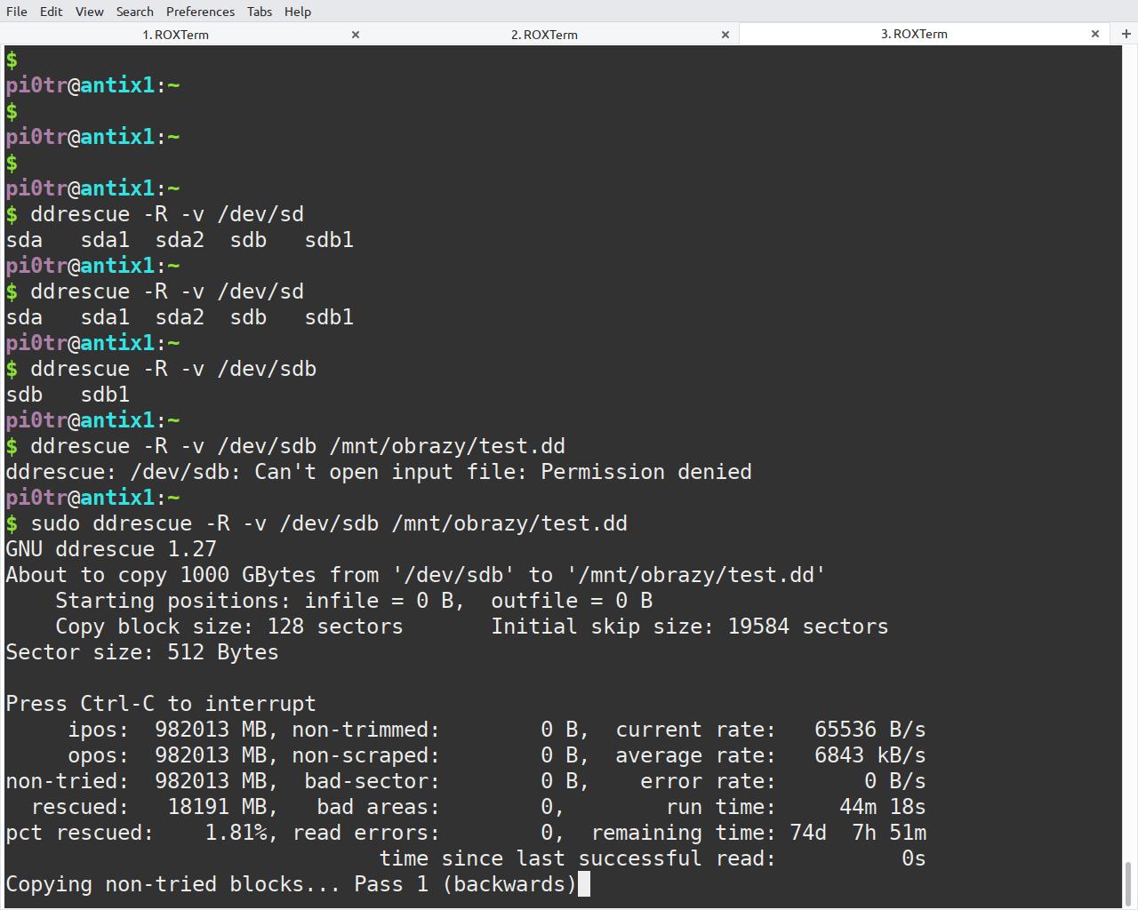

Have you tried to clone in reverse mode (from last to first LBA), and how does it behave ?
[/quote]
backwaord imaging in ddrescue looks like this

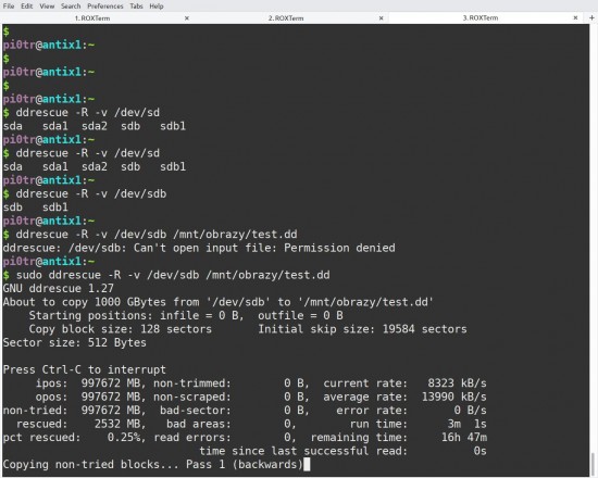

 Post subject: Re: Toshiba P300 - HDWD110 - very slow data reading
PostPosted: October 13th, 2023, 11:16
Joined: September 13th, 2023, 5:53
Posts: 93
18gb and look like this
PostPosted: October 13th, 2023, 13:30
Posts: 1768
Location: Verona, Italy
It seem to be that your drive has still working heads, it has damaged surface in some zones.
I would continue to clone in reverse mode... i think using DDRescue is your best option without professional tools.
If possible, jump bad sectors (example 10000 LBAs jump on bads encountered) as fast as you can (use low read timings, example 200 ms) on 1st pass... on 2nd pass you may increase read timing and reduce jump.
P.S.
I don't know if this settings can be set on DDRescue, i don't use it.
As i know, HddSuperClone (which is a GNU linux utility based on DDRescue algorithm) can set this options, and can let you set also which sectors do not need to be cloned because do not contain any useful data (slax area)... but for this option you will need to use it combined with DMDE.

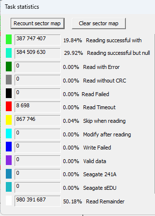

ok im recive my MRT card and im run it witch this Toshiba
What is the way to handle this disk so that it can quickly read the data on it?
it is my first time witch this tools

ok im trying to clear G-List unfortunetly MRT Dont support 3.5' Hitachi ARM disk now
Is clearing the G-List the only solution?
A bit of google tells me Toshiba P300 these are relabeled Hitachi Deskstar 7K1000
in my storage i have 100% working Hitachi Deskstar 7K1000.C 1TB
Is it a good idea to heads swap ??

Clearing G-List,Please wait...
Clear G-List : ......................................OK
unfortunately, without success, it still reads data at a speed of 4-8kb/s

That's what i thought, but before thinking to swap heads, you should try to stop reallocation process.
You could try to load a LDR on ram, i think you can do that with "write ram in batches" option, but i don't remember if that option does really work.
As many mrt users already know, mrt has a lot of bugs, Toshiba and Hitachi utilitys are very poorly supported... for some reason mrt does research only on WD and Seagate solutions.
Ask to mrt tech support if and how to load LDR of hitachi arm, because in the past it never worked for me.
P.S.
Do also backup RAM
If it is a head releated issue, you might start Data Explorer for start cloning process by doing head map and virtually turn off heads that you suspect are bad/weak.
If one head has problems, this can help you to clone all other surfaces at good speed.
To do this, you must keep fw utility opened.
I suggest to use very low reading timings in DE (example 150 ms), and tick software reset and set it to 80 ms, untick drive repower.
It that doesn't help try also hardware reset (example 200 ms).
Set also large jumps (example 1.000.000) on bad and slow sectors.
Clone on a 3th drive, please do not overwrite on the destination drive that you've used with DDrescue!

ok probably i have a small success
im restart MRT software and my LAB-PC
im create new data recovery case in mrt
reads a small portion of data
create head map
and finally shutdown head 1
now im read 40-60mb/s

im cloning drive to image
im read all via head 0 but i steel dont have half data
probably the data for which head 1 is responsible
what should I do now? replacing heads?
currently reading data marked "Skip when reading" as using head 1
