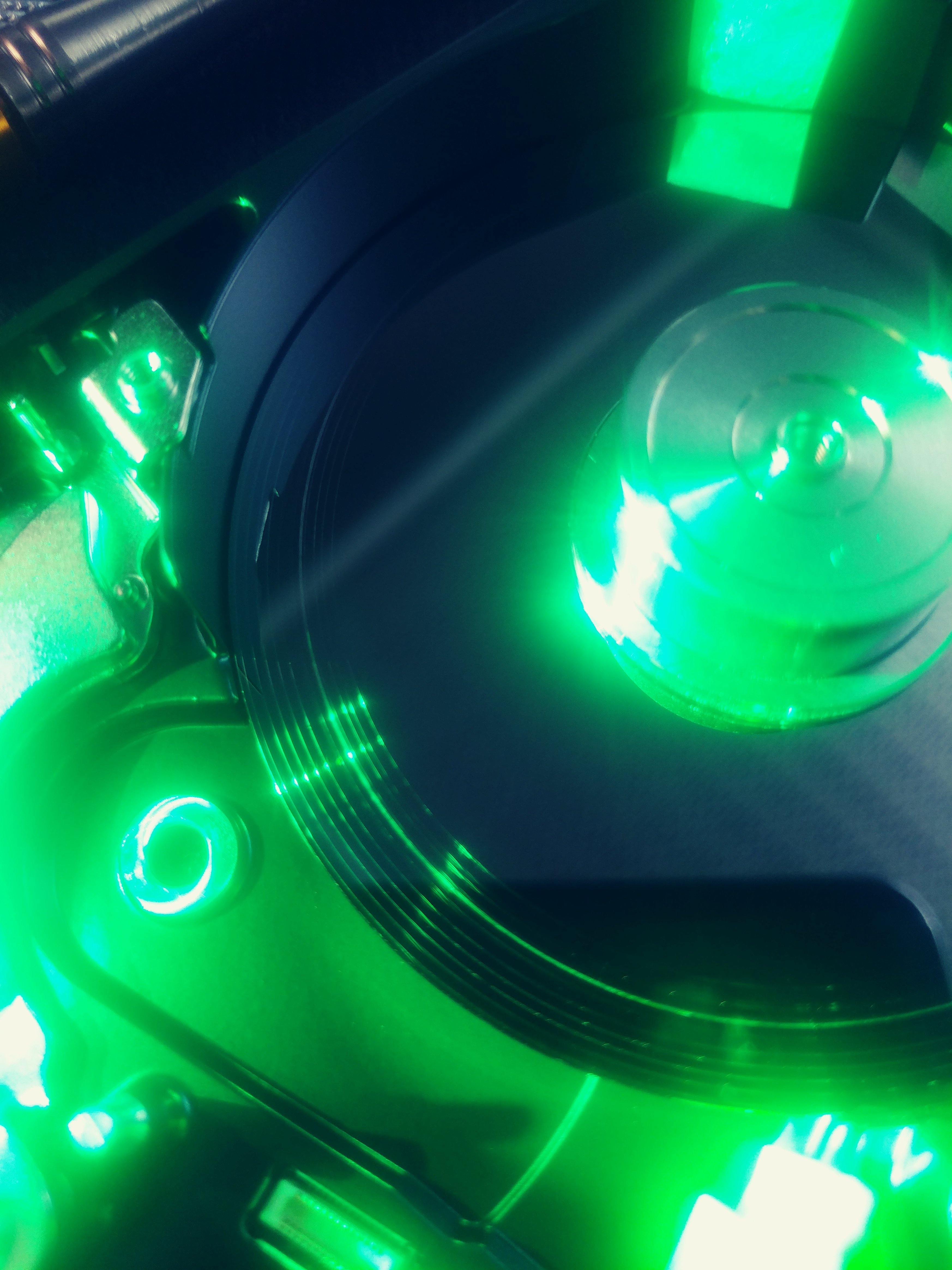

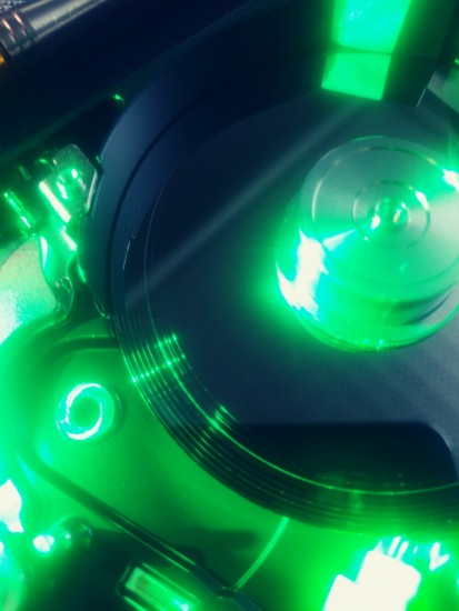

I'm wondering if there's any solution for spyglass2 hard drive with scratched platter i believe that all new wd smr drives check all platter to initializing there's no way to swap bad platter with another one or cut head physically all old tricks doesn't work . Any hints?
File comment: Deeply scratched
 Post subject: Re: Western Digital Spyglass2 With Damaged Platter
PostPosted: November 11th, 2023, 8:36
Posts: 4854
i can fool them... So a partial recovery might be possible if other surfaces are intact. I guess there is severe surface contamination, perhaps the platters were removed in an unclean environment? Perhaps the damage is a result of the same :roll: ?

Thx in advance pepe. The photo in the post has been attached by mistake its for seagate sorry. and thats true this photo for a hard drive opened outside a clean environment. your are saying fool them ?! do you mean make change in SA and ROM?

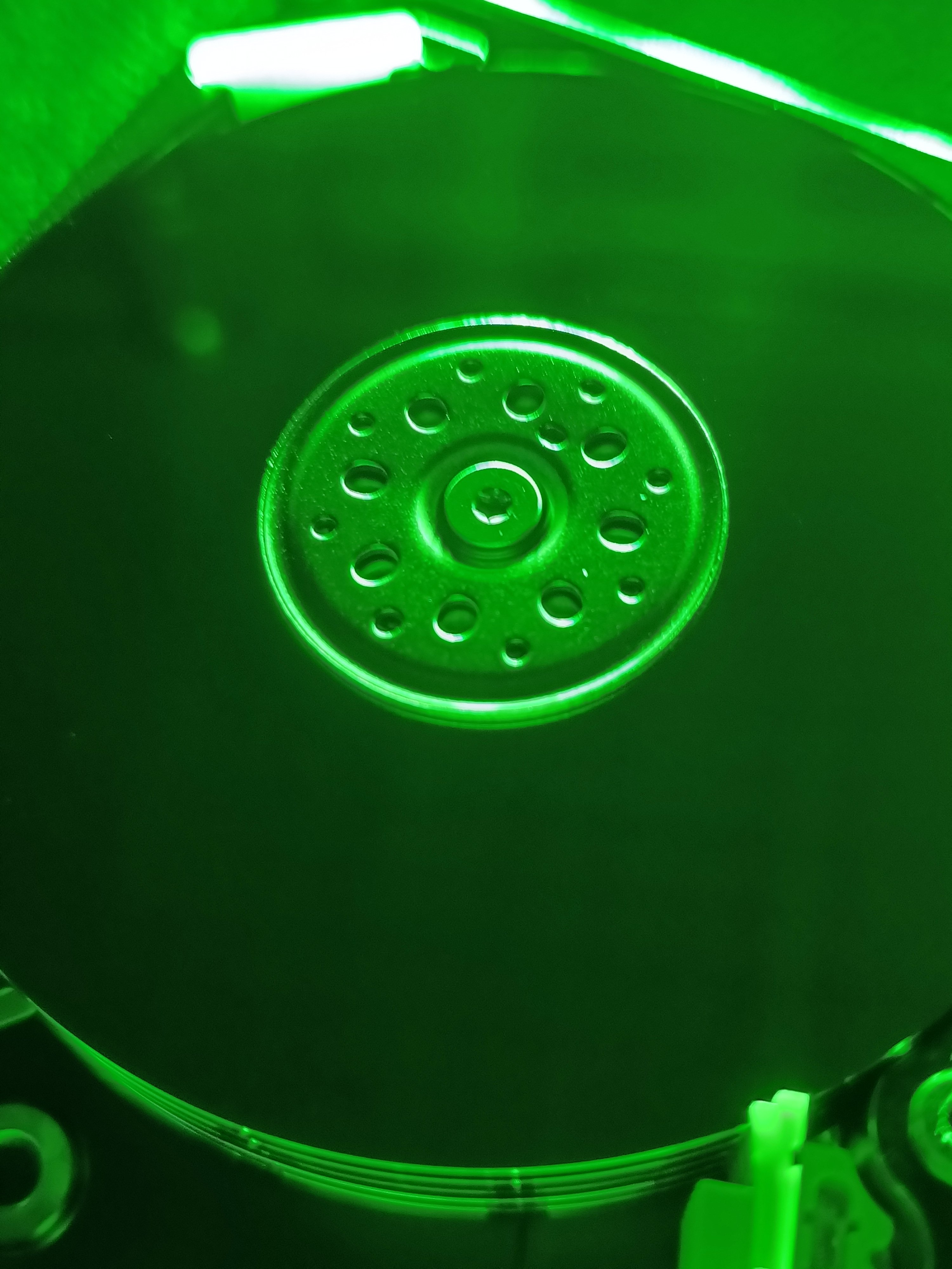

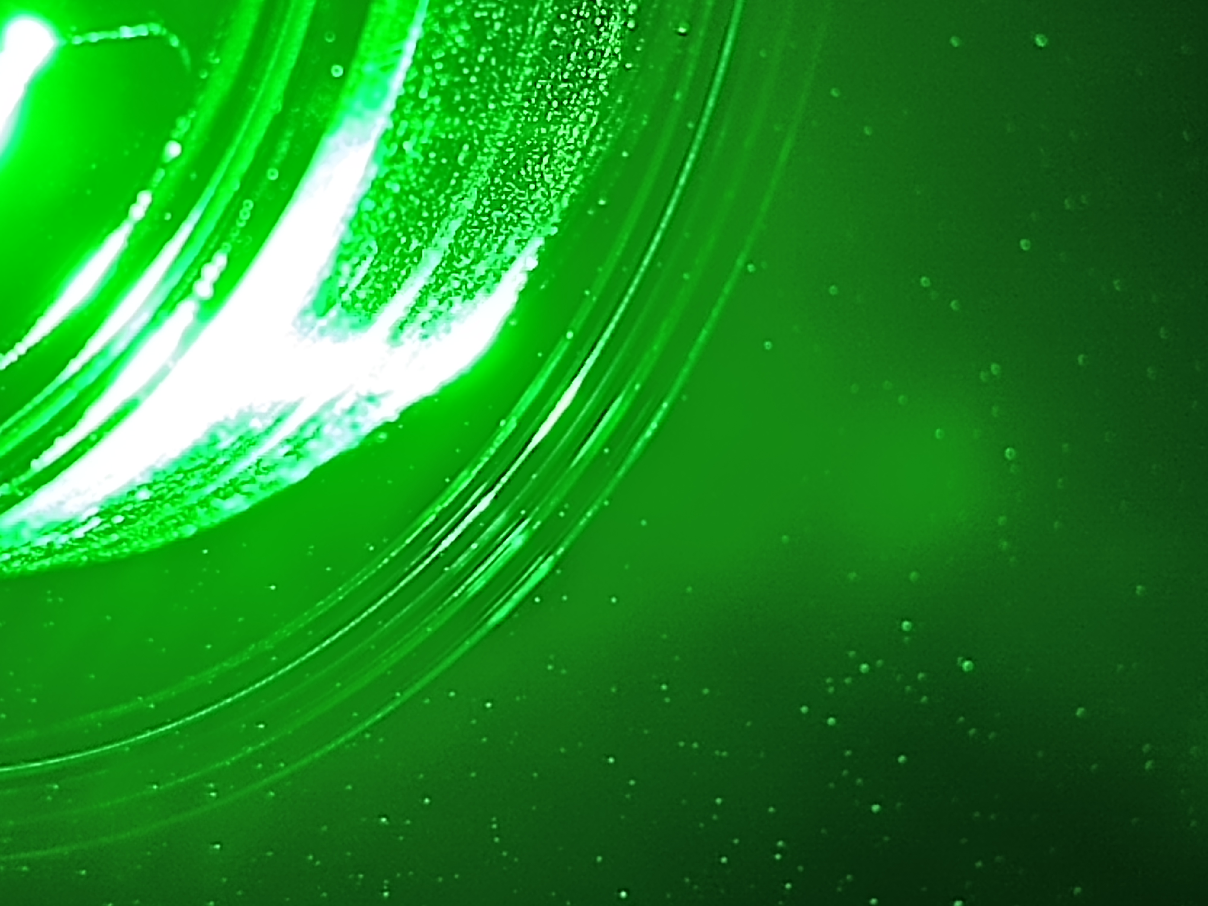

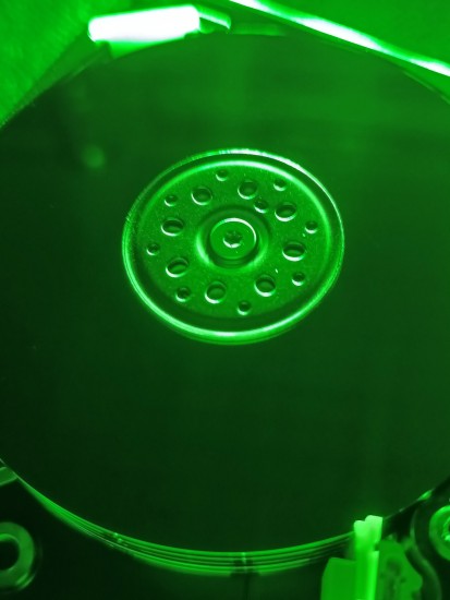

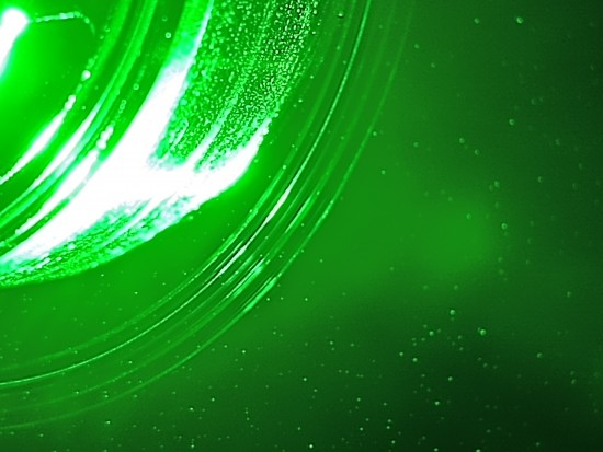

Here is 2 photo one of them for one platter layer damged {platter number 2} (count from bottom to top)
And other photo for perfect platter condition all platter condition perfect except platter 2 head numb 3
PostPosted: November 13th, 2023, 11:24
Posts: 3598
Location: Chicago
This should be doable.
We recover drives with similar damage every day.
